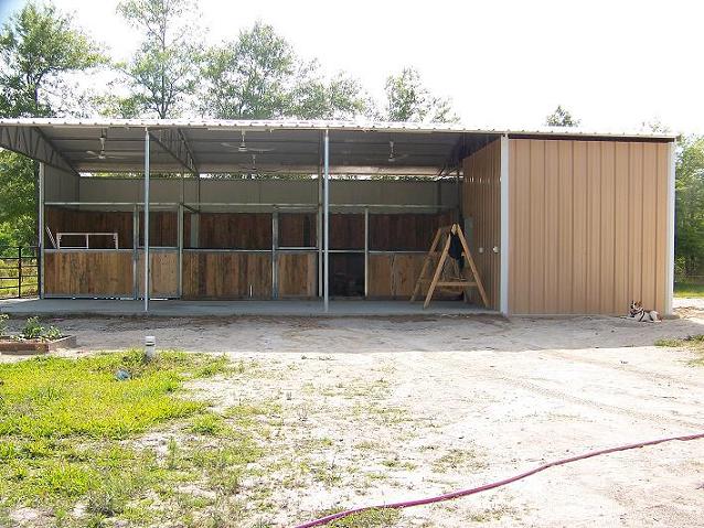

Ok I am starting the early planning of building a barn. What I want it is a barn that has a small woodshop, separate from a storage area/ work area for things metal and my tractor. I also would like to add the possibility of horse stall or two. Do any of you have a similar set up, how big have you been ok with? I would like any thought or ideas on this topic.
Im looking in the area size of 30ish by 48ish with a partial loft for storage.
Thanks Brandon
/ Help with barn decisions? #2

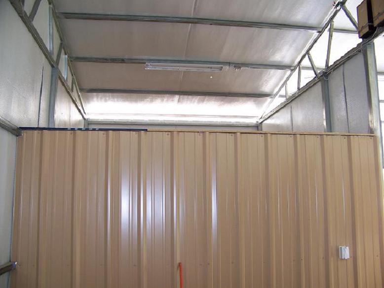

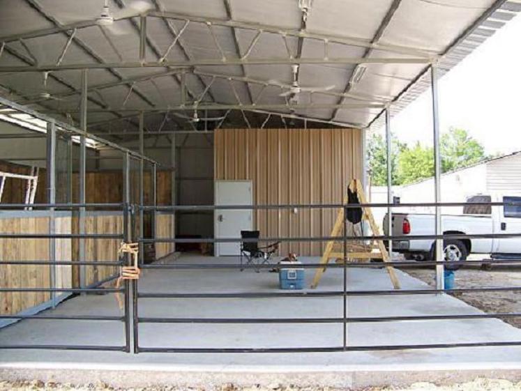

Here are a few pics of mine. It is 30x48. Trusses on 12" centers, 3 12'x12' stalls, 12'x12' enclosed tack room with loft above, 12'x16' hay storage area. The open space is 18'x36'. I use it for washing, shoeing, and taking care of the horses. I could easily close it in and use for whatever, but I like it open. Building with trusses let's you lay out the inside however yu want without having to worry about supporting the roof. We built this in the spring and have really enjoyed it since. These pics were taken before it was fully finished, but not much was left to do.
/ Help with barn decisions? #3
I planned this in my head for about three years before starting. I looked at a lot of barns and picked things I liked from each. Good luck and have fun.
