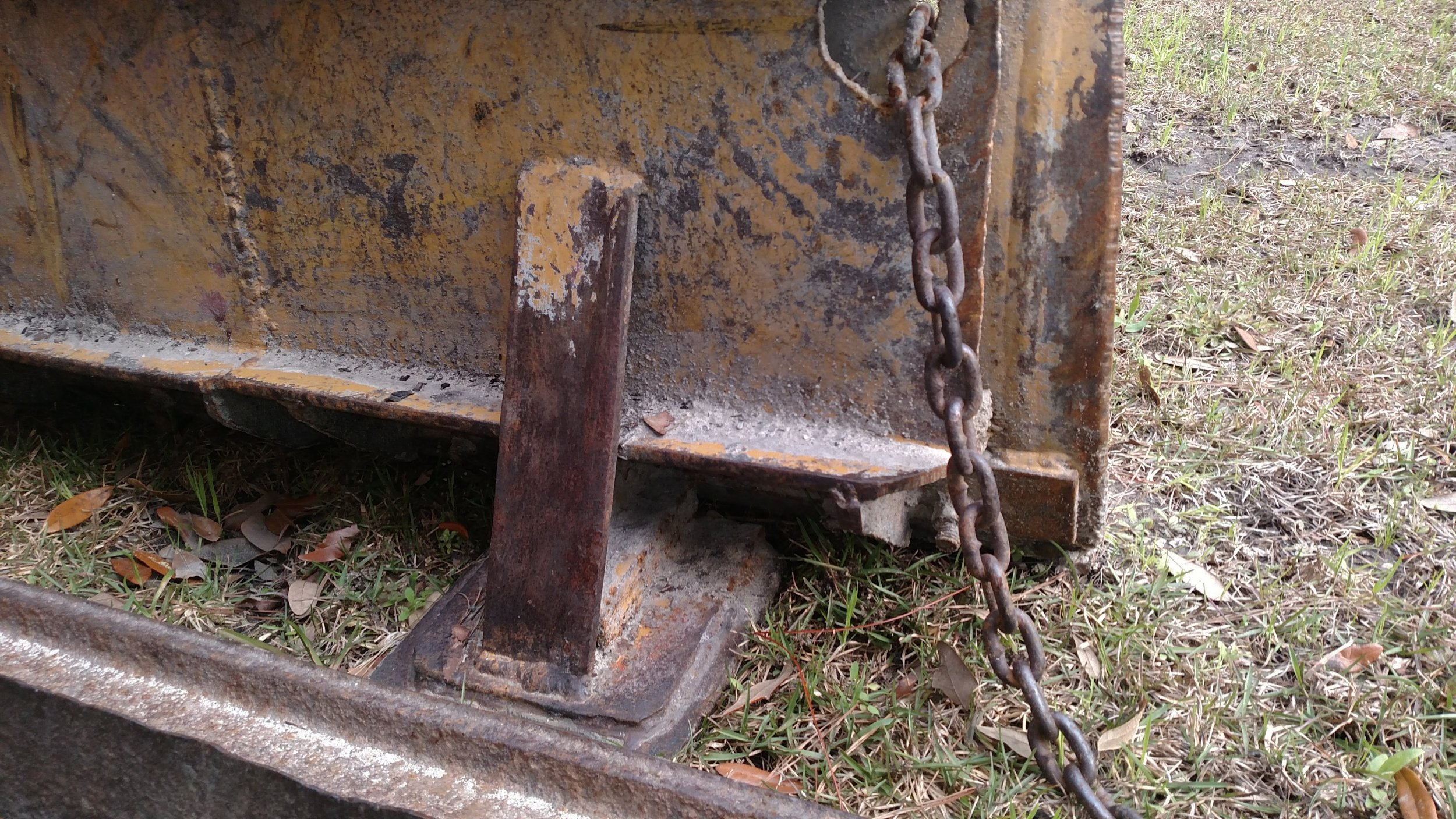

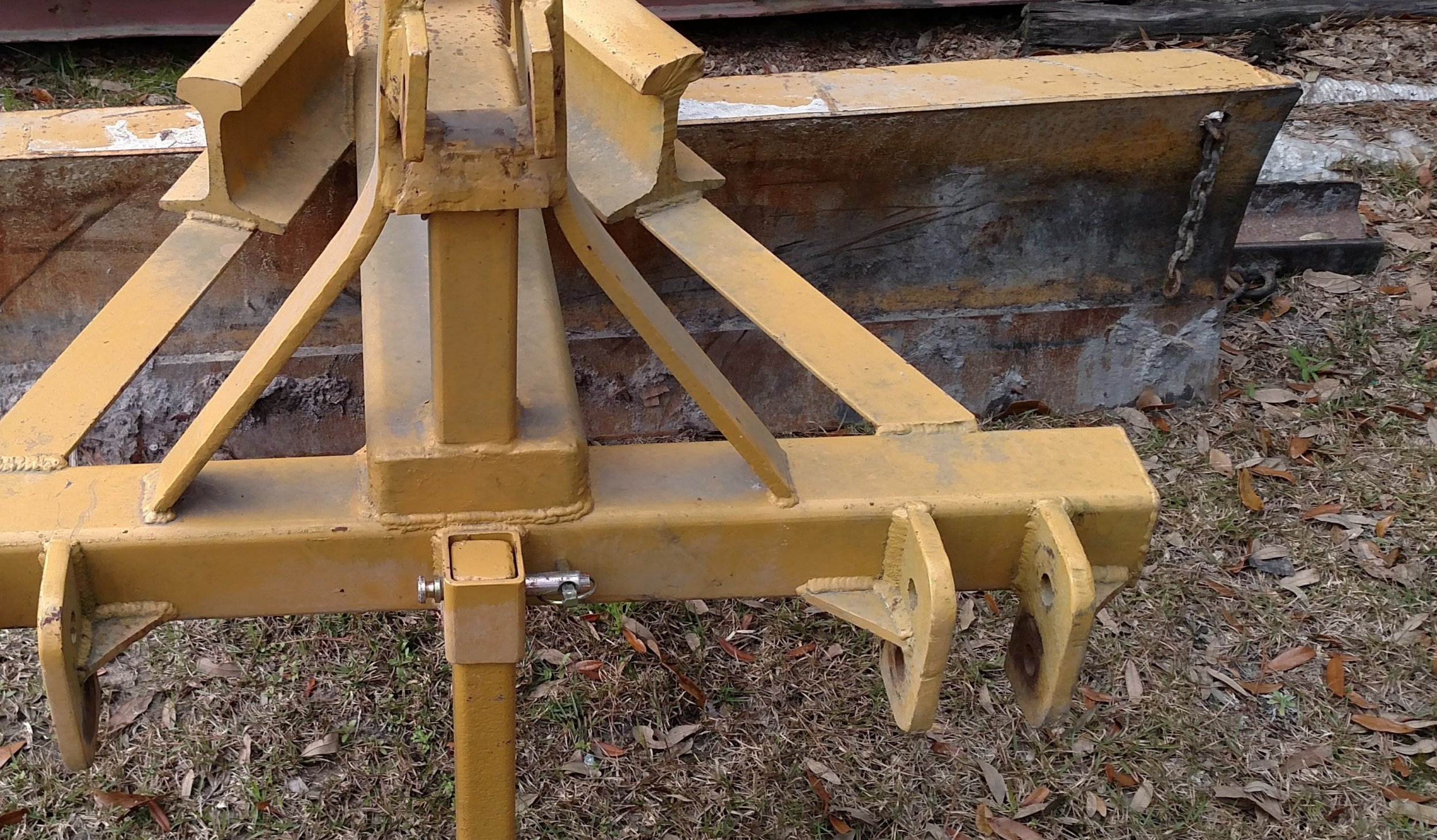

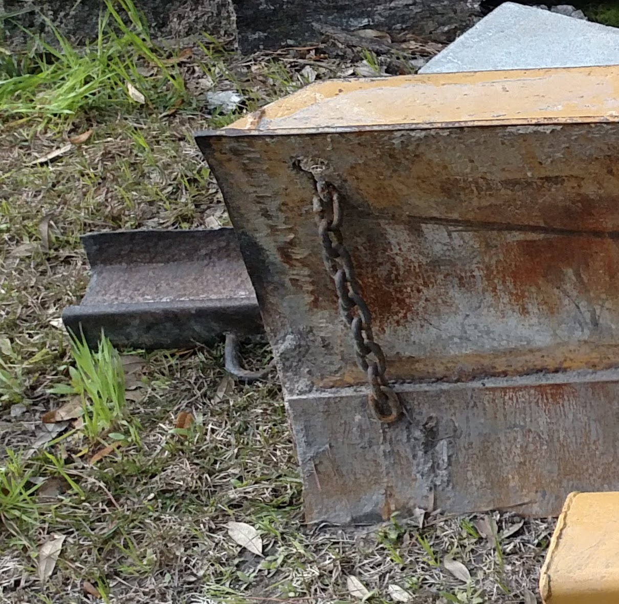

Steel shaft (cut up mobile tie downs) welded to RR iron slip larger chain loop over shaft before welding...Use a shackle if necessary..
Cut keyhole in blade run chain through.. you can also back feed chain in same keyhole so it doesn't slip out..
You could probably apply this to lots of attachments... Just cut your keyhole big enough to slide chain through, then the slit of it only big enough for the individual link to hook on. Keyhole has to be vertical to work...
You can lengthen the chain so the RR iron is always on ground, or shorten it at the keyhole so that it picks up with the blade.
Use at least 3/8 grade 70 or 80 chain nothing smaller..

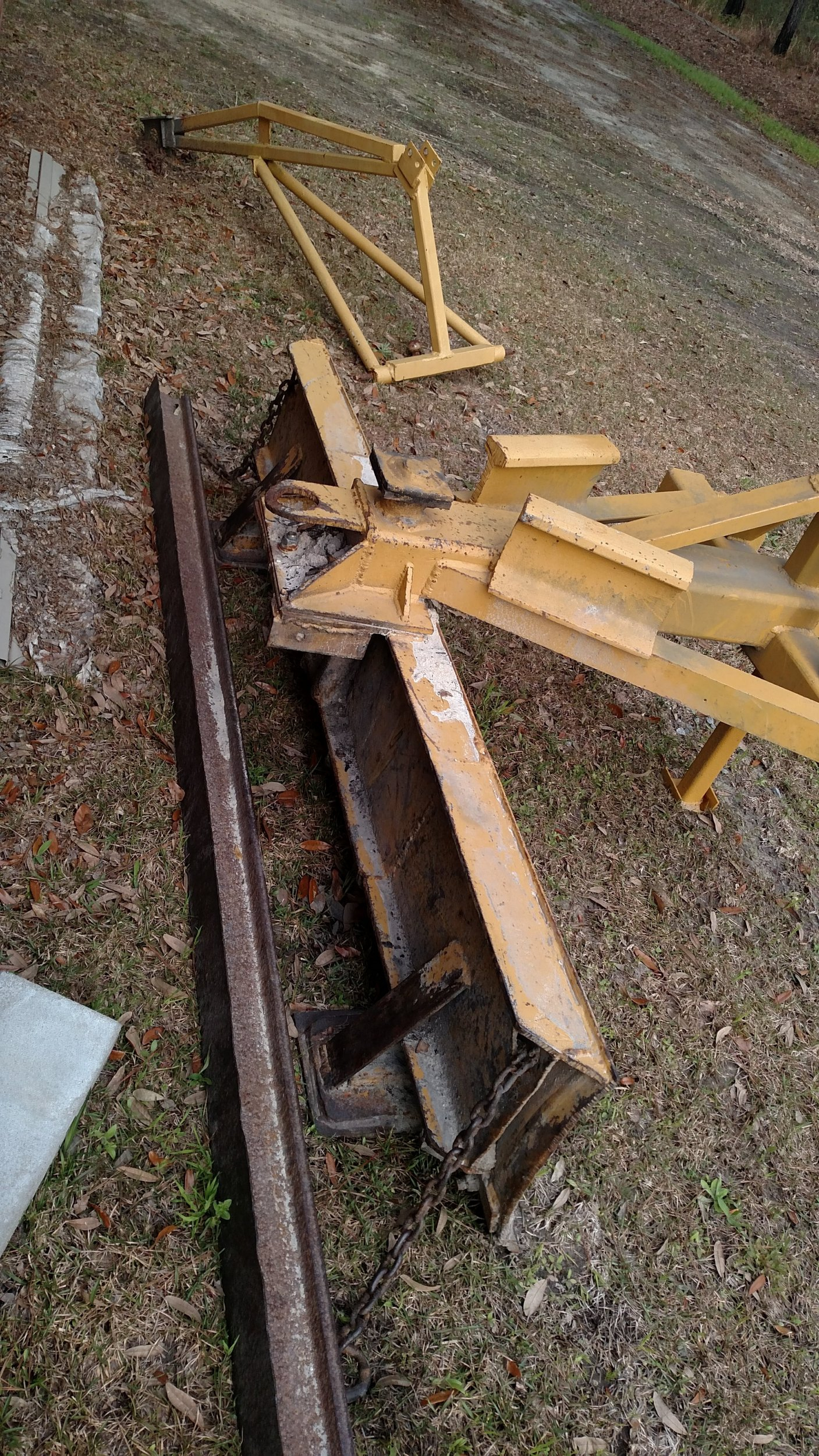

/ Hog Damage Drag attachments #12
Here's a second blade I fabbed up with it in action. You have to notch out RR iron where the shaft/rod welds on.
Thanks for your feedback. What a novel approach with the keyhole design. I’ll bet others will find this helpful. Great idea.
