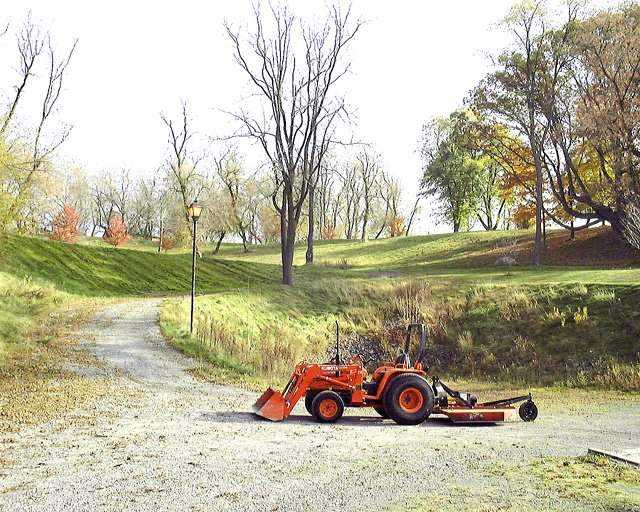

Freds, The trick to getting it to look more like a lawn is to cut it more often, The more you cut it the better it will look. used a hog on my yard when I first built my house (it was the only mower I had!) would cut the grass every two weeks for the first summer. Made it look just like a yard. I did sharpen the blades like a finish mower, so that might have helped alot. Set the mower to cut as low as it would go, (about 4") and it looked good. I do the same here at my three acres at my antique shop. I cut about once a month and it looks good. See attached photo.
