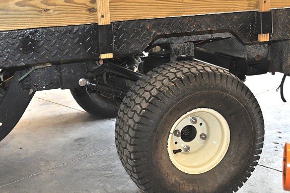

Seems so many UTV's are built for "Playing". I needed an off road truck so to speak.
I originally bought a Cushman. It worked out for what I needed but I soon found the rear suspension to be impossible for anything but concrete. So I made a triangulated 4-link and airbag suspension. Worked out well and I did use it a lot but it was a junk vehicle in need to total overhaul.
Cushmans were not really put together to be overhauled well and I was looking at making some changes. So, I built my own of road truck from scratch. I just thought I would share it with you. This is the short version. It is electric BTW:

I started originally with Cusman Truckster axle from parts. It had a 2-speed gearbox attached to the front:
The gear box was a 2:1 reducer. I looked at some numbers and thought the axle ratio of 8.2:1 might need more speed. I turned the unit around and set it up as a speed doubler. I am powering it with a D&D ES 15-6 electric motor.
I was greedy. In low gear it goes 28mph. I really have no need to go any faster and I have never set up the actuation to shift to 2nd gear. I am getting a rumble form the coupler though. I have the pulleys and belts to set up a reduction. I will make first gear closer to 18mph with top speed closer to 35. It will increase the TQ in low and if I drive 25 down the road I don't have to have the foot on the floor.

One more thing to work on, I welded a trailer receiver tube vertical in the bed. You can see it in the following image. The plan is to buy a Harbor Freight JIB crane. I am going to weld it to a trailer hitch so I can drop in when needed. It will be nice when moving things around like engines.
