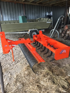

I'm thinking I can pin on the balls with a bushing. My box blade has cat 1 pins, my rake has both cat 1 and 2. They're both on the way from EA. Won't a bushing fit over the cat 1 pin and inside the ball?
Forgive my noob logic, this is my first tractor and I've got all of 30-40 minutes operating experience. This weekend was spent practicing moving, figuring out the differences in the various gears, and rolling and curling the bucket.

I've ordered enough for my 2 implements and yes, they're going to stay put on each.

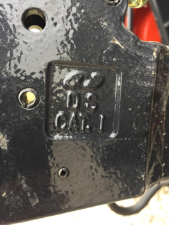

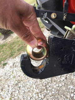

Wanted to provide an update just in case anyone ever faces this problem. Received the balls from the dealer and the ones I ordered that were linked. All too big.
I've learned that the arms for the DK4510 and DK5010 are Cat 1. I'll attach a picture. The dealer apologized and is sending Cat 1 quick attach arm balls now. Apparently he's sold so few of these that even he didn't know what arms came on my machine. If this weren't so frustrating it would be amusing. I've got tools sitting ready to use and cannot connect to them! Once I get a part number I'll get it posted. IMG_3174.JPGIMG_3176.JPGIMG_3177.JPG

Seems the way it's set up is the dealer places the order for you. You call him, he orders them, they ship straight to you from Kioti in Wendell NC.
