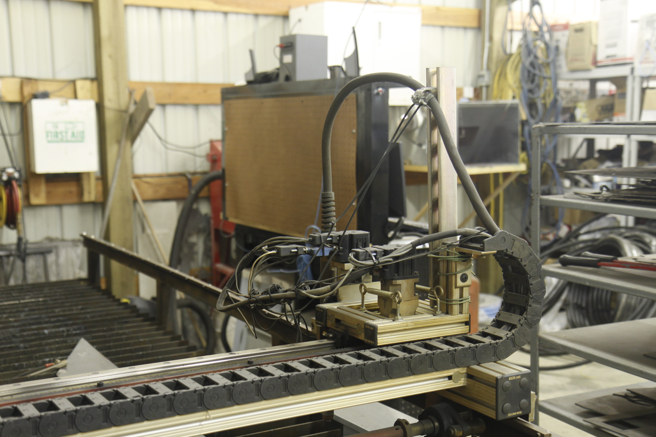

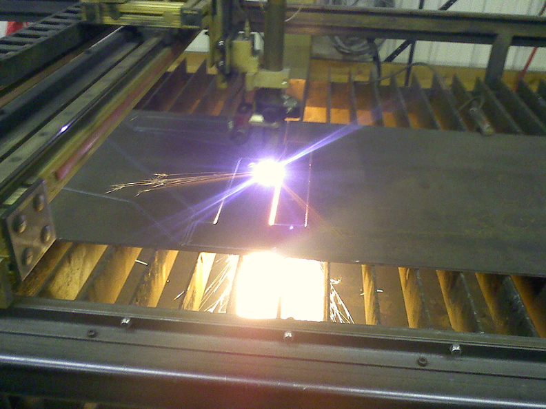

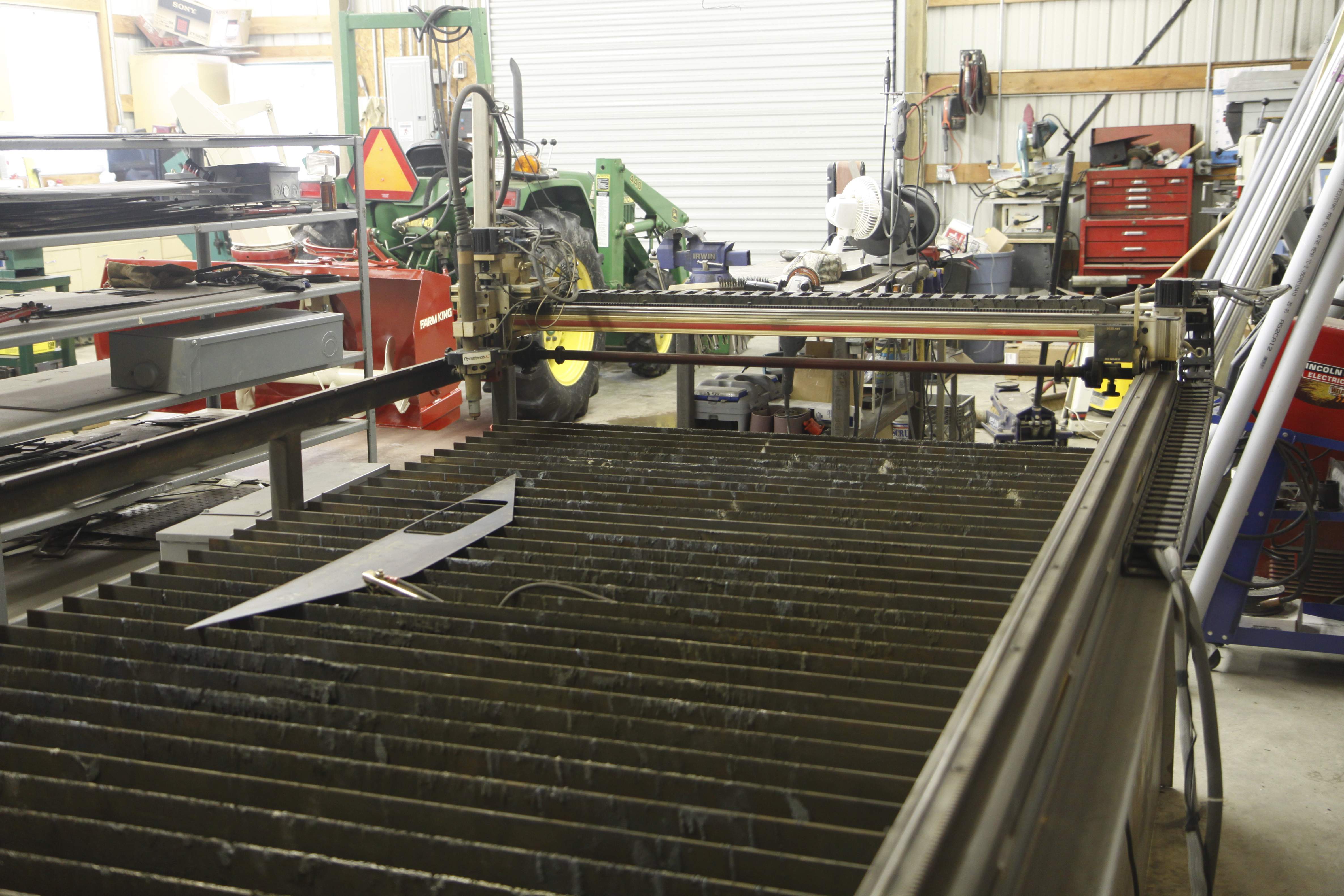

i cheat......this is the plasma unit i use. Its set up in my shop, and cant live without itView attachment 308216View attachment 308215View attachment 308214
grsthegreat
Nice set up. Did you build it by yourself or did you buy it ready made. I am considering to build a CNC plasma DIY but can't decide what where to get the parts.
There are several vendors that advertise on CNC sites but it is hard to find who is reputable and who isn't.
Advice would be appreciated.
Thanks,
Ladia.

i purchased mine complete from Dynatorch quite awhile ago...like back in 2006.
