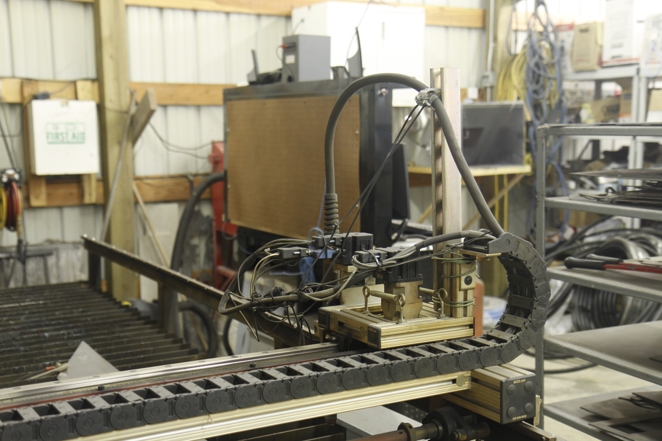

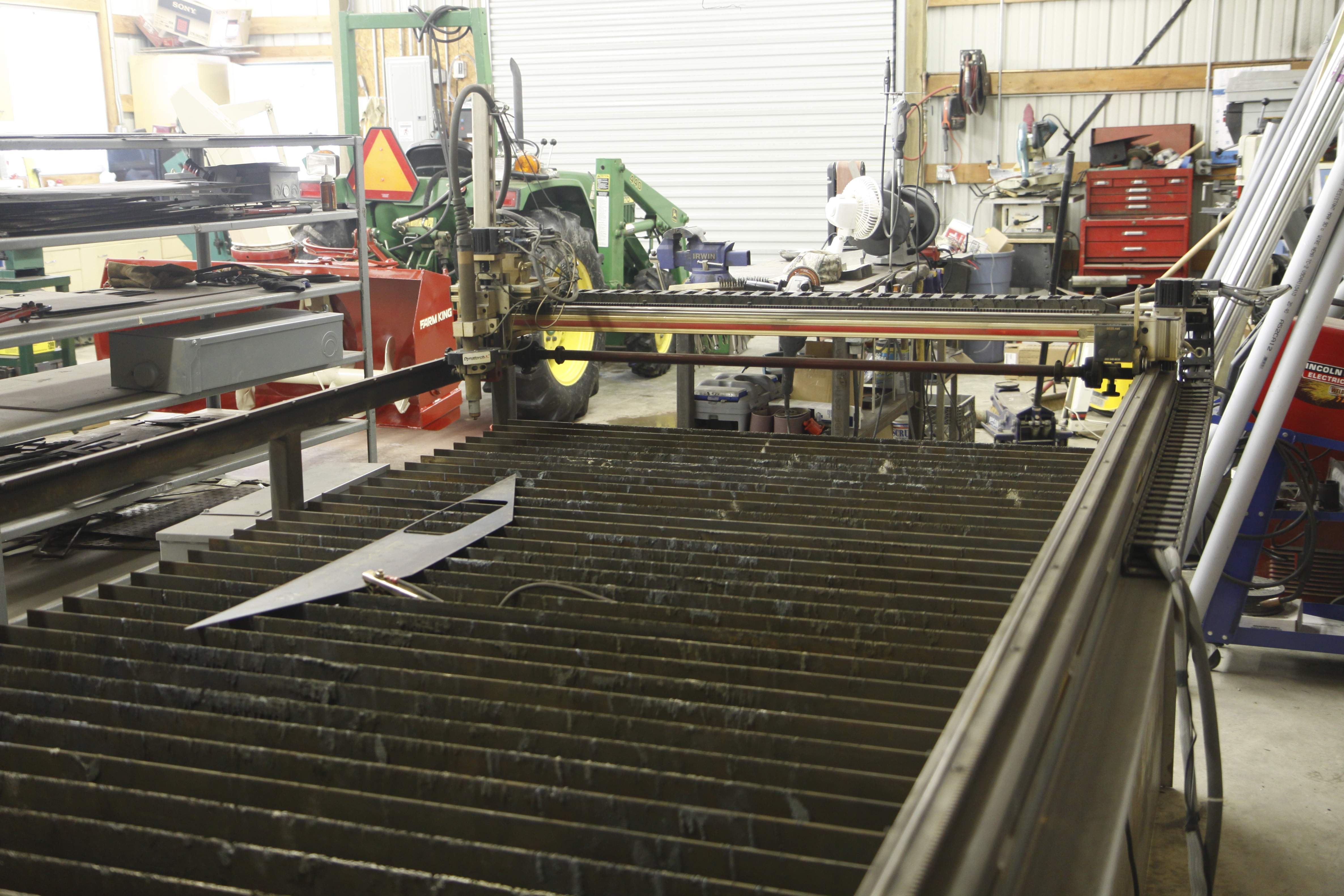

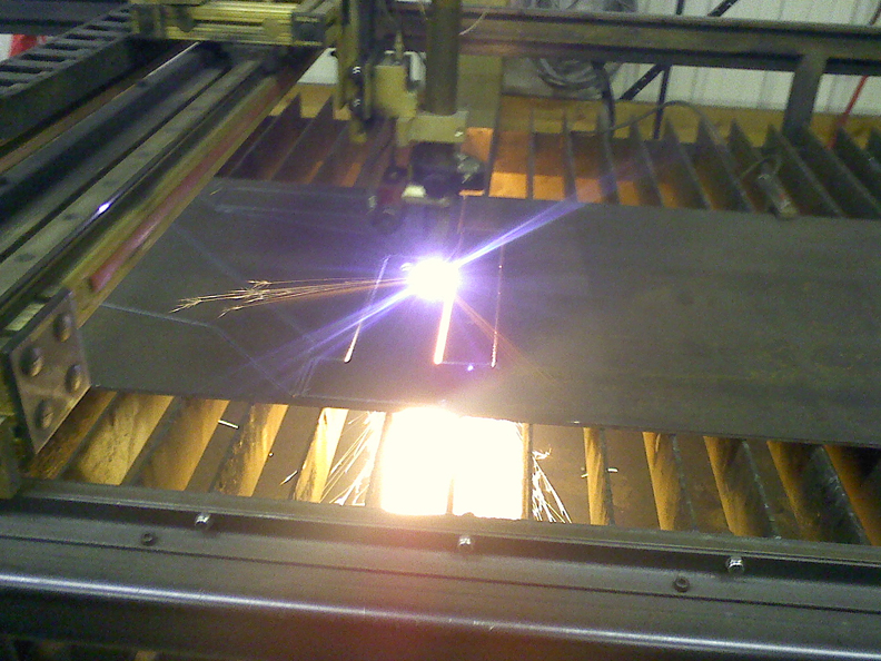

i cheat......this is the plasma unit i use. Its set up in my shop, and cant live without it _MG_4810.jpgplate 2.jpgshop 3.jpg

If you are making very exact parts and especially multiples of anything from flat metal, the NC plasma is ideal. If you can afford it, it opens a whole new world for your capabilities. Caution: right after getting an NC plasma, you will need a press brake.
