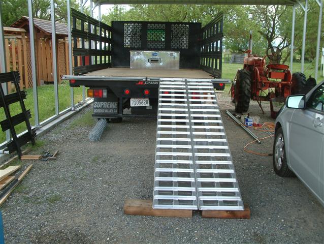

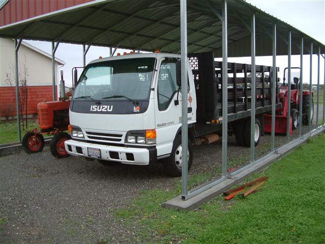

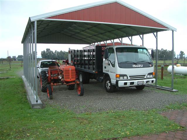

I went through the same exercise as you last year--needed to replace my 2001 F150 with a 3/4 or 1T pickup. Couldn't find what I was looking for at a decent price but did find a nice 2004 Isuzu NPR/EFI stakebed (8 x 14 ft bed) on eBay with 49,500 miles, 6L LQ4 GMC V-8 gasser for $11K. It's GVWR is 12,000 lb and GCWR is 18,000 lb. I can load my parade tractors (3500 lb max) onto the stakebed or hitch up an 16 ft equipment trailer and pull a load.

Since you have a business perhaps a stakebed would be a better choice than a pickup. I would shop around before dropping $25K and having regrets later.
Good luck.
