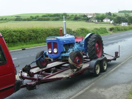

I did the straps for a while when I got my tractor. Then got the bug to get some chains. I use two 20' chains and 4 binders. I do not cross in the front, only go out from one side of the front bumper/frame hole to the side and same from the back. I go out from the draw bar area. Chain starts at one side of trailer to tractor back to starting side just enough to catch binder then back through drawbar hole to other side of trailer. I just drop a loop through the drawbar hole to catch the binders on both sides.
The chains are overkill for what is required by law. Took a while to find what is required and for light loads like we are hauling only two straps or chains are required. The law does say you could secure it in accordance with the heavy equipment requirements (duh) buy not required.
My tractor and backhoe weighs around 5500# - 6000#. The straps worked pretty good, just did not like them getting rough around the tractor edges. Wife is making me some covers to put over the tractor to keep the chains from scratching the paint.

Double X. Front left tractor tied to front Right of the trailer. Front right tractor to front left trailer, Rear right tractor to rear left trailer, rear left tractor to rear right trailer.
I don't think it's really an issue for the scenario here, but I don't think the X-style is the best way to tie things down. Usually the tie downs are at much more drastic angles than would otherwise be preferred, so aren't good at holding the machine front to back compared to aligning them more along the front to rear axis of the trailer. This means the load shifts more, or, to keep the same resistance to motion, the tie down points and the tie down itself has to be both stronger and tighter.
Additionally, the X-style can allow the load to turn over, off of the side of the trailer if extreme conditions are encountered. Adding a single tie in the middle going straight front, and straight back, can alleviate these concerns, or simply using 4 tie downs and running left rear tractor to left rear of the trailer, and so forth.
It's probably not absolutely necessary to do it that way, and some tie downs are better than none at all, but the X-style is not as secure as it appears at first.

My trailer has tandem 3500 lb axles and is rated at 5000lbs. My F150 is rated at 5000 lbs towing. My B3200 weighs in at 1800 lbs. Add the FEL and any 3 pt attachments. I'm pretty safe at coming in under 5000 lbs.
Will the gate hold your tractor?
If all the above is a go then TSC has various ratchet straps. I use two ratchet straps that are about 2.5 inches wide. I also use two axle tie downs which I put around the FEL lower frame. I lower my FEL and put a bit of downward pressure, set the brakes, lower the 3 point and strap the tractor on.
I have been towing for 5 years with no mishaps. I normally don't drive over 60mph when towing. Once towed 250 miles one way to my son-in-laws.

hi, I like to use 4x4 in front and behind wheels and then take 2x4 perpendicular to 4x4 and screw 2x4 into 4x4; besides the binders and chains. I dont like anything on wheels rolling.
I've seen guys bring $1/4 million equipment into our food plant secured down like that. It seems like a lot of work for regular hauling of a tractor. It takes almost 20 minutes to load or unload equipment.
I lower implements, set the brake and use 9K lb. straps to secure my <3K lb. tractor. With a tilt deck and pre-sized straps I can load or unload in under 2 minutes. The only time I've had something move was when I had my 7 year old son help hold the end of a strap while I tightened it on the other end. He put the hook on a wiring harnes instead of a stake pocket. The load moved several inches, but the single remaining strap prevented any catastrophe. Lesson learned: Check the load myself after it's all tied down.

I will throw my 2 cents into the mix. When I bought my yanmar 187D with a fel a year ago, I went looking for a trailer.....found a tandem axle 16ft at a good price so ended up with it.....after a year of pulling it 25 miles one way to my land....wish I had bought a 18ft trailer instead....just need a little more space for other implements etc.....use my 2000 Ford Expedition 4x4 with the 5.4 without any issues......these vehicles are pretty cheap now.....mine has 197,000 and still kicking......you may can find one of these cheaper than a truck.
   / How do you tie down tractors when hauling on a trailer? #40
I use 2 sets of 3/8" chain with retching binders. Its not going anywheres.
If the frame is steel, they can add binder hooks easily enough.
Now as far as moving a tractor without securing it......thats plain STUPID.
