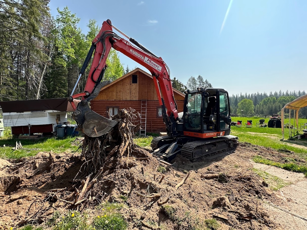

Prior to this excavator this summer, I'd never run one. It took me just an hour to operate this Kubota KX080. I pulled 15 roots in 8 hours.
I would think a 080 to be well into the 'midi' category. Moving one this size is not in the realm of your standard 2 axel 8k trailer? You would have to check and see what delivery and pickup costs? I ran a Kubota 035 recently and there is a little learning curve. I didn't do anything but play, though.
