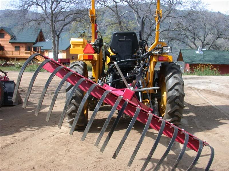

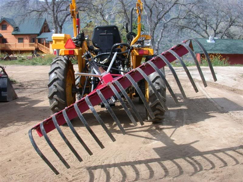

These are photos of the DPOCV's on the backhoe stabilizer legs:
I also put them on Loretta's tractor when it was set up for top n' tilt with 2 hydraulic side links, just like mine.
Except she has a (better than mine) Price Stack valve (4 spool) so the valve and cylinders are good. With them being "hard plumbed" on the cylinders, in case a hose ruptures or gets torn off, the cylinder with DPOCV will retain it's position instead of crashing down. Although not as critical in the TNT use as in other uses, it doubles as somewhat of a safety feature.

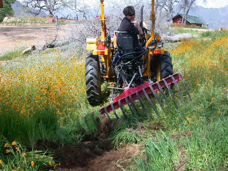

Here are some photos of her set up with her landscape rake on.
You can see the Jinma has quite a range of tilt with 2 hydraulic side links. Grading the road or other areas are real easy with minor adjustments to the rake or blade while driving along.
