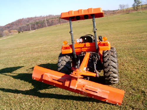

Vince, with your 3pt set up like it is in the picture, does your tilt cylinder tilt your blade down to the left and right? From the pic, it looks like it only will only tilt the right side down. :confused: Can you please confirm this.
My hydraulic tilt cylinder will tilt down the right side.
I have a manual adjustable link on the left side if I need it. But so far I haven't really needed it.

Vince, thanks for responding, I was just wondering. It seems like there are quite a few guys that have side links that work as yours does instead of having the ram at the 1/2 way point when level.

Brian, that is how mine is set up most of the time, allows me to cut a ditch at a sharper angle. You can see why I wan't to use two cylinders for tilt to allow tilting either side as pictured above.

Brian,
I tried having my ram at the half way point so I could tilt both ways.
I just didn't like it there, seemed like I lost to much lift hight in my 3 point. Also felt I had to quess where level was when resetting the ram back to center.

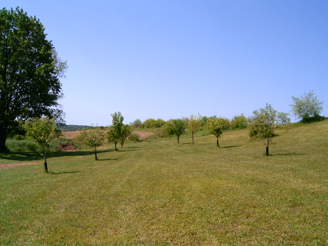

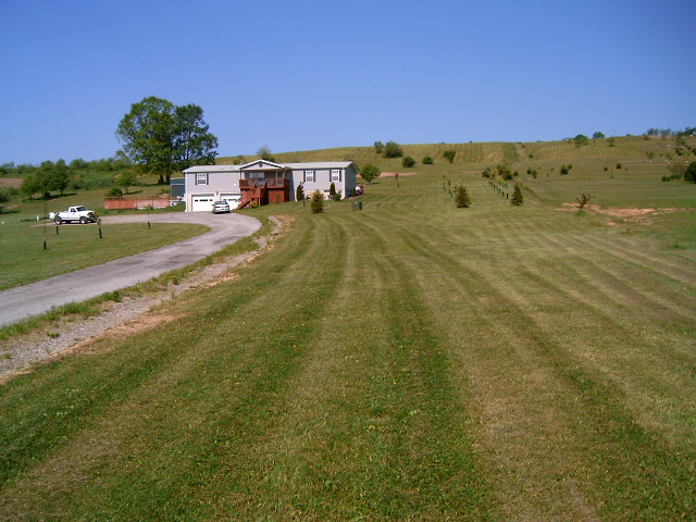

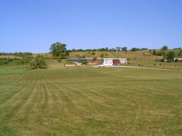

Your place sure does look nice, how often do you have to mow?
Thanks.
I mow around 7 acres of lawn usually once a week in the summer. And 8 acres of field around 3 or 4 times a year.
