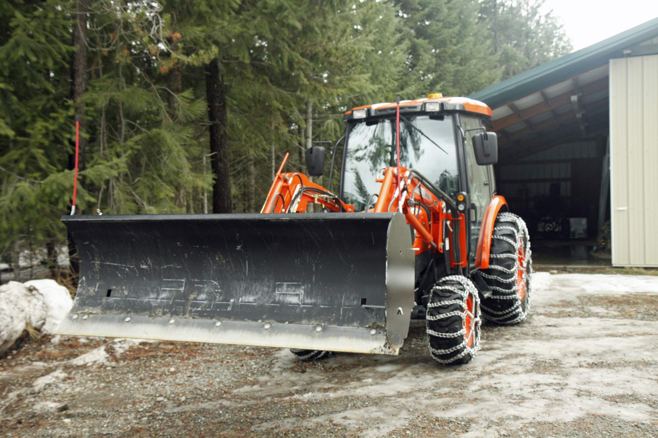

here are my chains now that the snow has melted off of them. There 2 link ladder chains. all 3/8" chain . man their heavy
Yeah they look good! Not sure about adding chains to my front tires? I don't know of anyone who has done this on a 2520??
I tried plowing without the front chains on and if i tilted my blade to the side, the front of the tractor moved in the other direction. With the chains it tracks straight.
