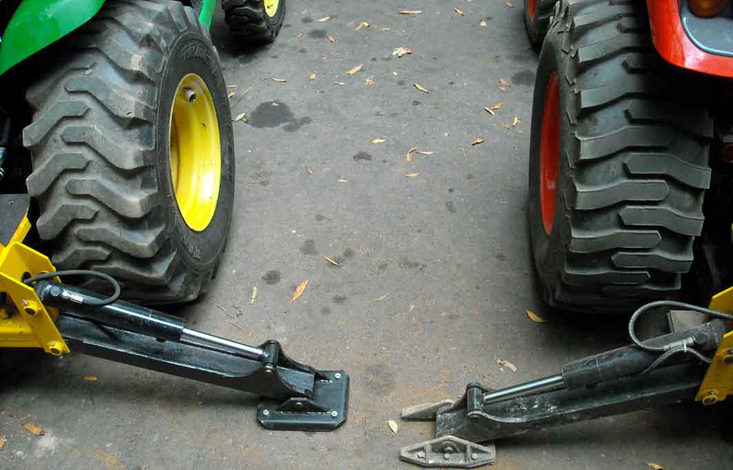

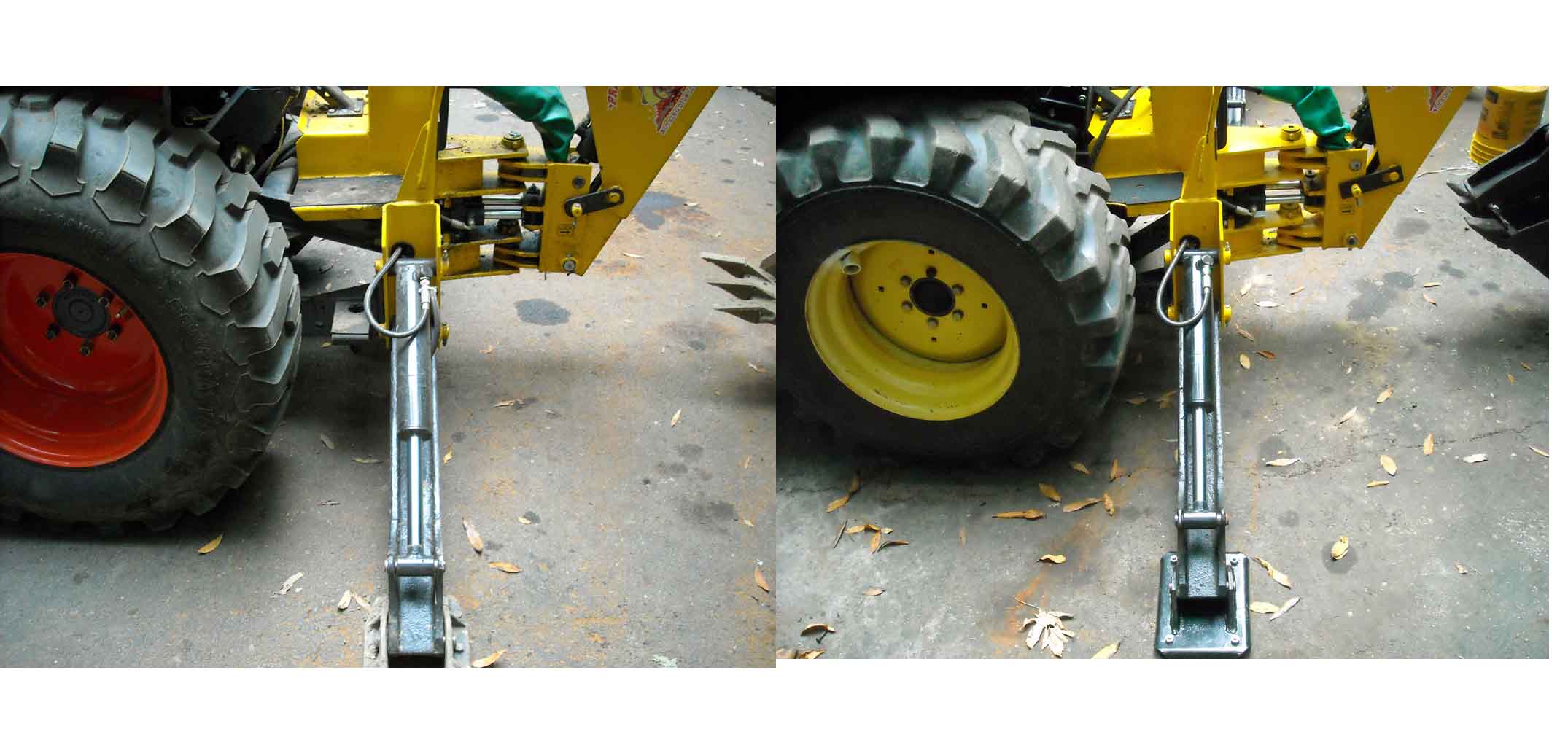

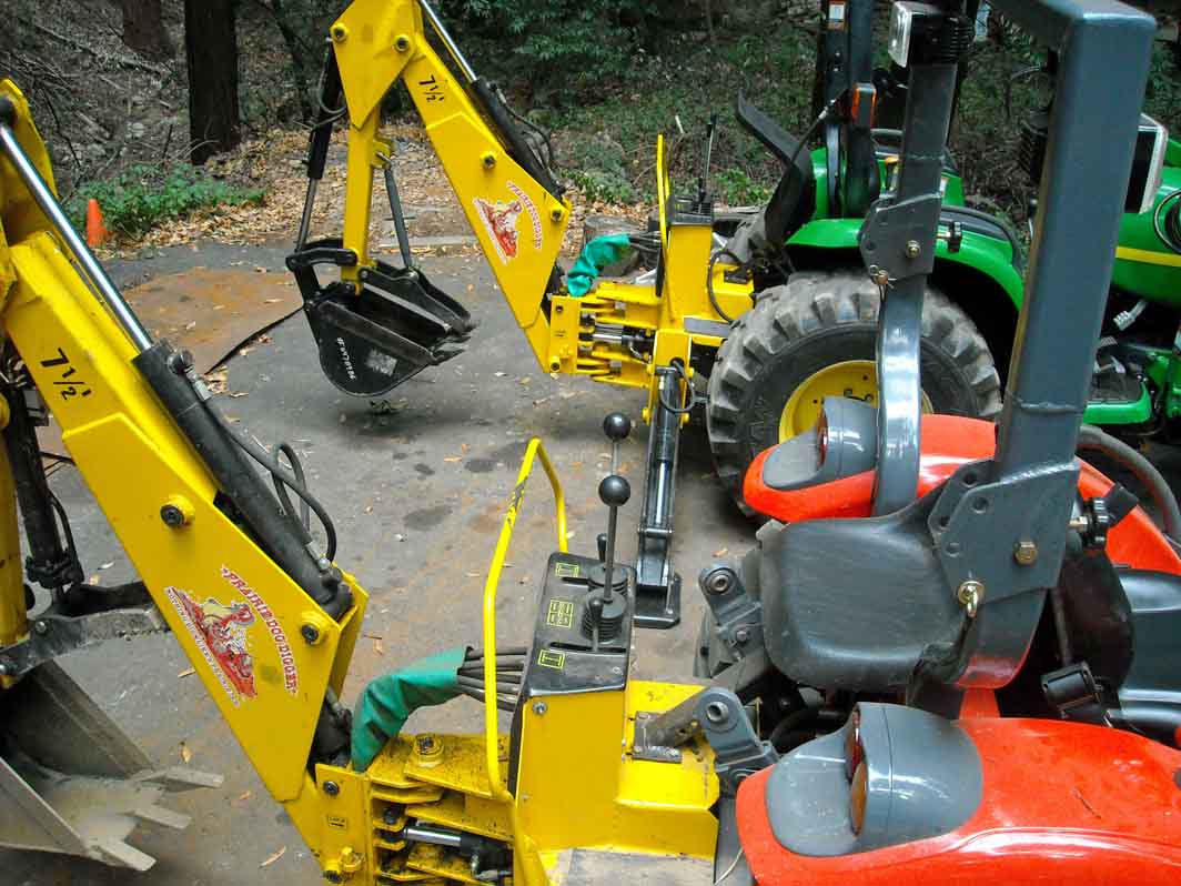

Here is a side-by-side comparison of 2 Prairie Dog hoes on 2
different tractors. The tractors both have 68" wheel bases, and
each has a custom subframe supporting each hoe. Both units
have the same size tires (15x19.5R4s), but the JD has 13" wide
wheels vs. the 12" wheels on the CK30.
The Kioti CK30's hoe is mounted about 5" more to the rear than
the JD4300's hoe.
This difference may seem minor, but the driveability and balance of
the JD does feel better, even tho it weighs several hundred pounds
less than the Kioti. The JD's hoe is mounted a bit lower, but the
departure angle should be about the same.
