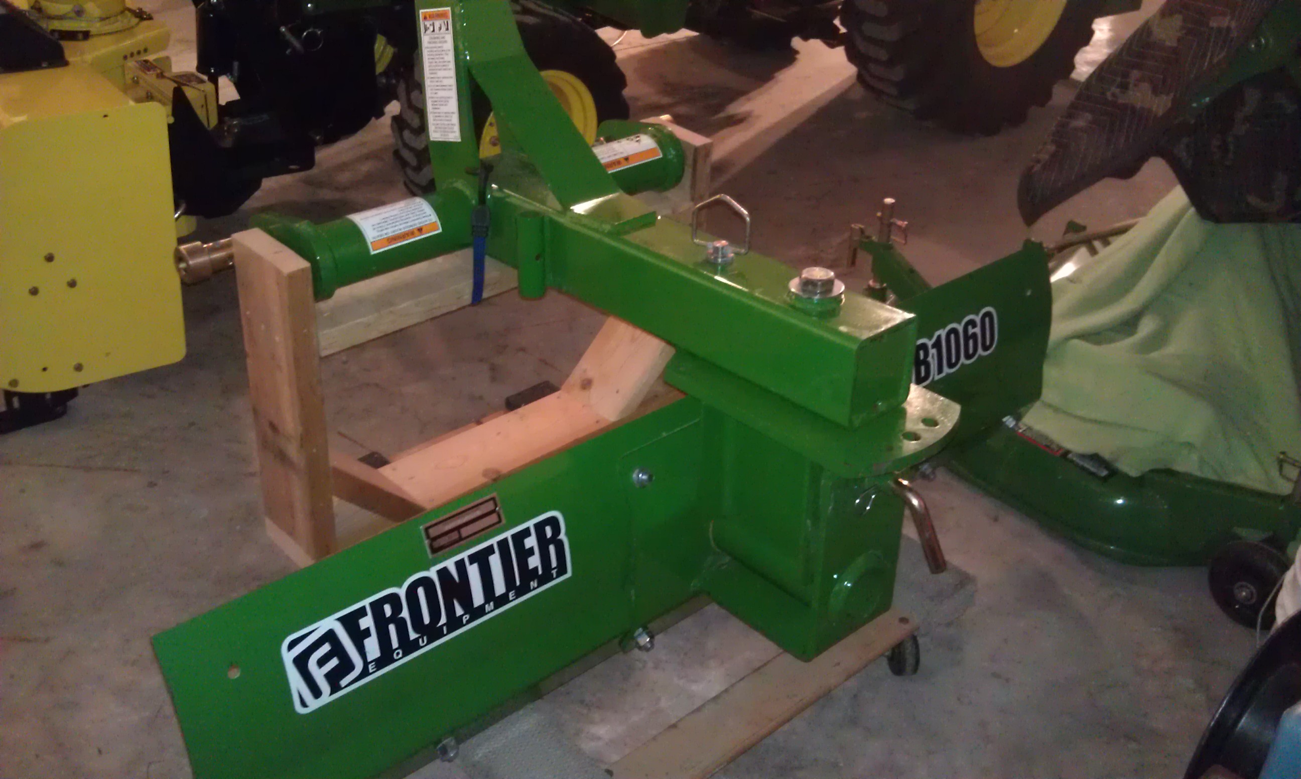

Thanks to all the great information given I have decided to keep my Frontier Back Blade. I paid less than half of a new one on it from an older guy who had never even put it together so I really dint have much money in it. :thumbsup:
I will keep looking for a used Land Plane until Spring and if I can find one I will probably break down and buy new. It sound like one of the most important implements for my needs.
I can weld as a beginner, but I really do not have the time with all the other projects I have going. This project is in northern Michigan about 3 1/2 hours from me. Thanks again
Rich
Trav City
I think you could also rig your blade with side skids (or sides with wheels) to act as a land plane, following what I posted earlier. If "rigging" bothers you, once you get it working, spray it all green :thumbsup:
