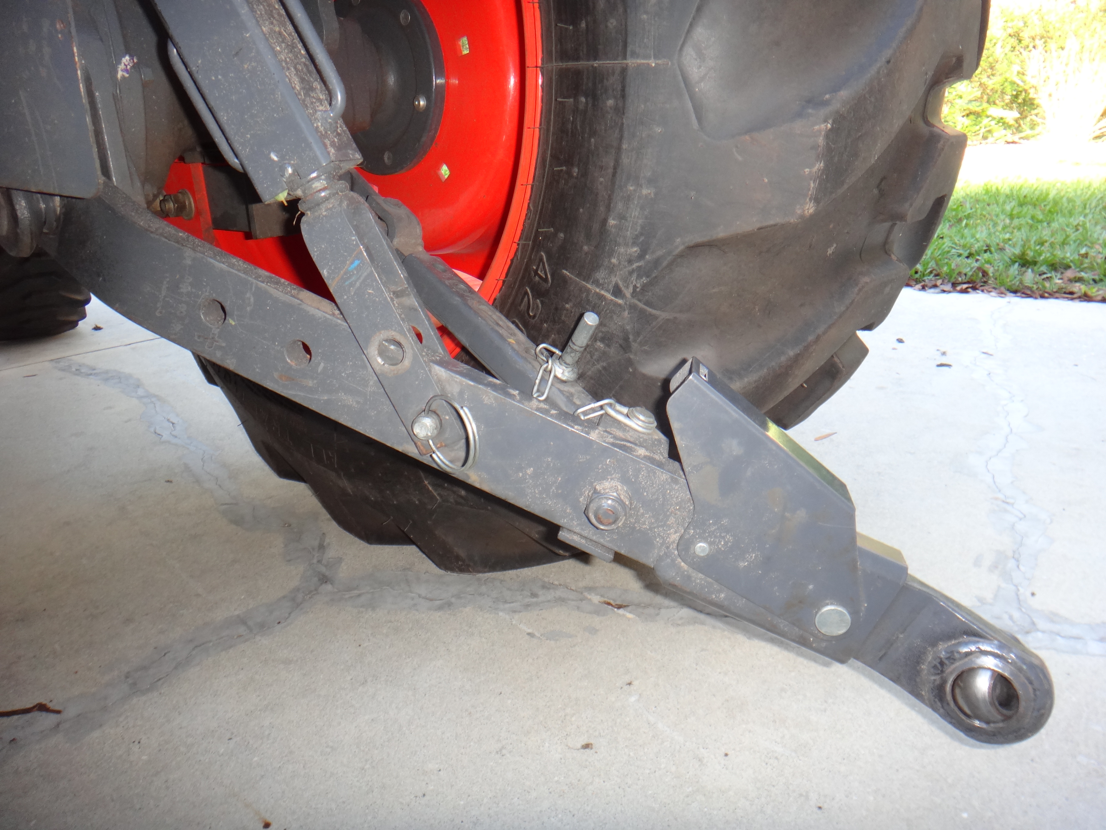

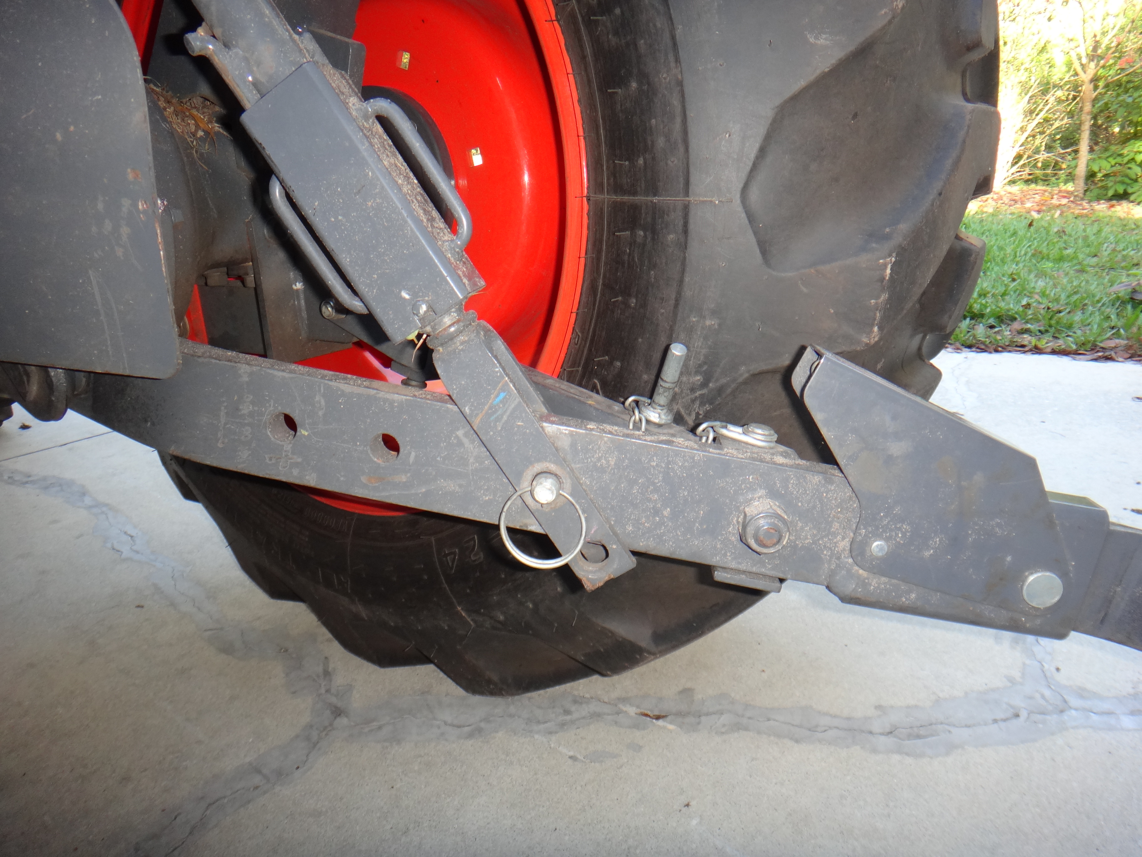

The solution is to move the adjustment pins for the Three Point Hitch right and left Lifting Rod stirrups, which attach to the Lower Links, from the TOP hole to the LOWER hole. This will allow your ripper to drop down 3" to 5". Then play with Top Link length.
Removing pins is easier with implement removed. DO NOT POUND ON THE PINS WITH A STEEL TOOL TO GET THEM OUT, or you will convert the pins to rivets. (A brass or nylon drift is OK) Work in slack with the right Lifting Rod. Grease pins lightly. I use anti-seize compound but any grease is fine.
This pin adjustment is highly useful when using a Box Blade, Landscape Rake, Rear Blade and/or Turf Thatch Remover. Sometimes useful when operating a Field Cultivator.
Kubota L3560 photos:
#1 Standard position for Lower Link, stirrup pin in UPPER adjustment hole. Note Lower Link angle.
#2 Optional position for Lower Link, stirrup pin in LOWER adjustment hole. Note Lower Link drop.

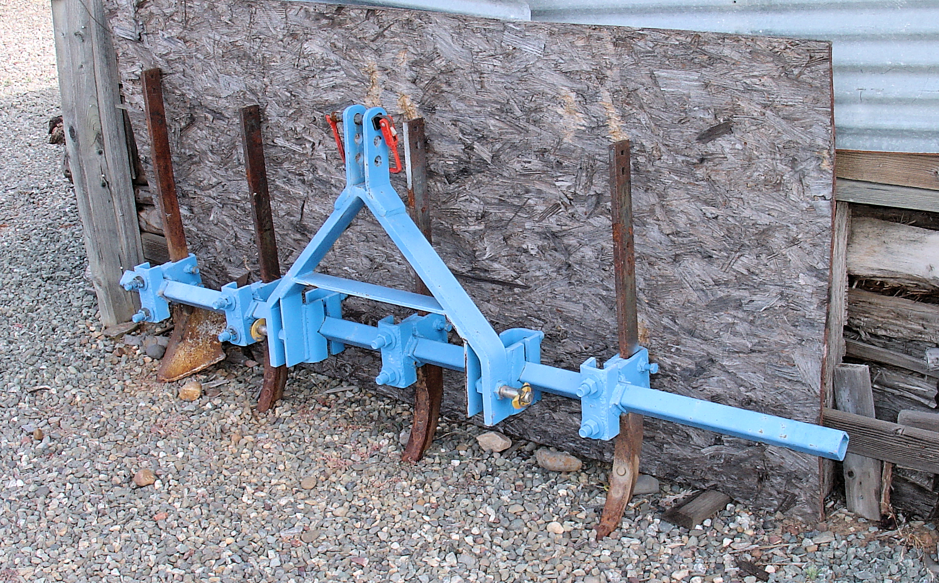

Without a blade, I'd agree that a longer top link would dig aggressively and lower the scarifier frame closer to the ground. I have a tool bar set-up that does just that. Don't have a photo yet, maybe later today.
EDIT: Here is the photo mentioned above. Note the scarifiers (or middle buster) can be dropped a LONG way for penetration. However, I can't get much more than 8" into the ground regardless of the shaft length. So the type of ground seems to be the limiting factor.
I am particularly proud of the four homemade tool holders attached to the bar...subtle brag there.:dance1:
