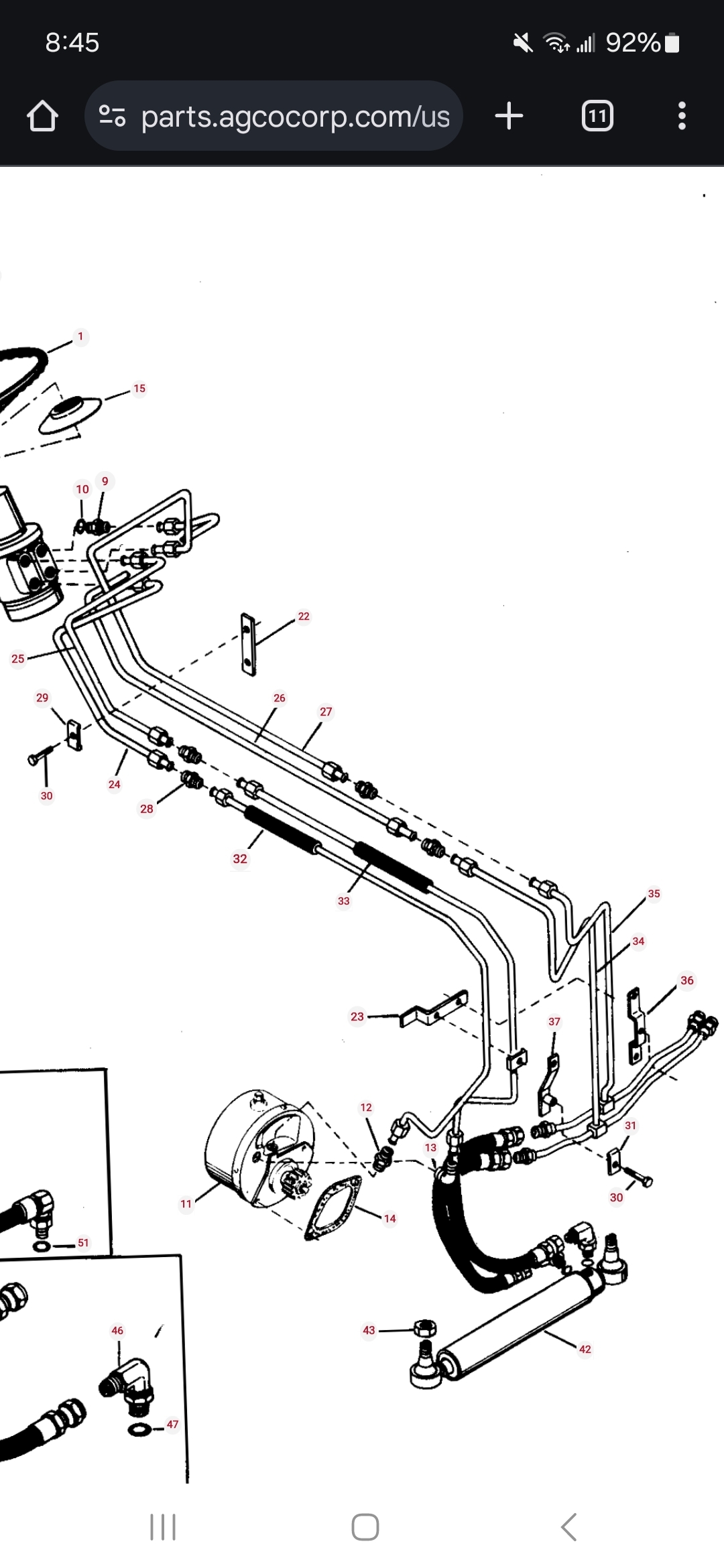

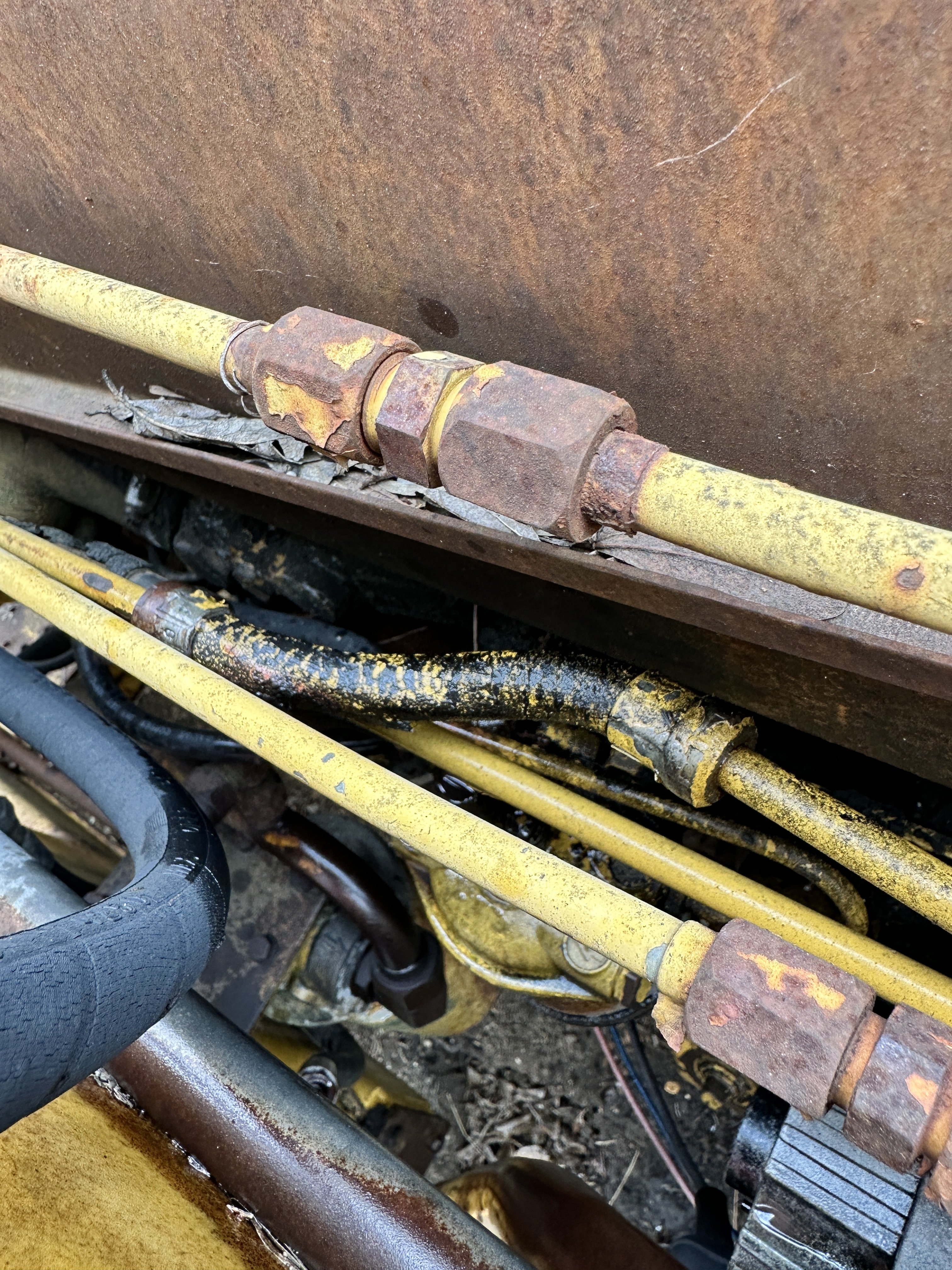

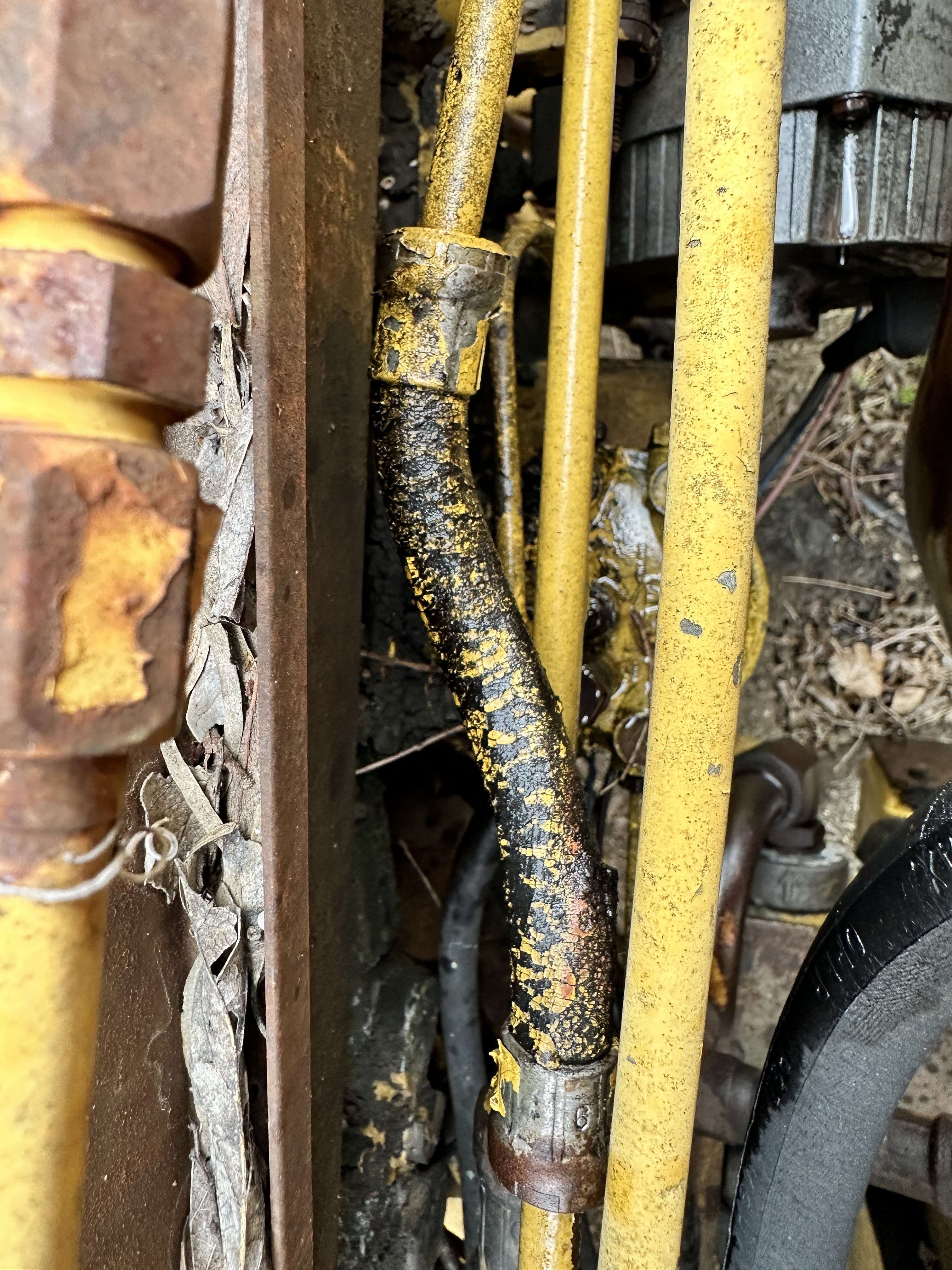

Ford likes to do this with steering lines as well. The solution is to cut out the bad section of the hose and replace it. You do not need to take it to a hydraulics shop as it is easy to do and does not normally require removing the entire line.
-First clean the paint off of a section of the line and measure the OD.
-Then order a flareless tube fitting. I like Swagelok and Parker. Below is a snip from the Parker Farulok catalog. End 1 is the tube OD, End 2 is NPT end. I am partial to NPT as the hoses can be purchased at most local farm stores.

Its easy and cost effective giving you a better quality repairable solution that replicates the OEM lines. The cost is not too bad either.
I have done this on half a dozen lines and have had good success (except the first time I turned the nut on the flareless fitting 5 or so turns and cut the tube) The best part is that most of the time you don't have to remove the entire line.
