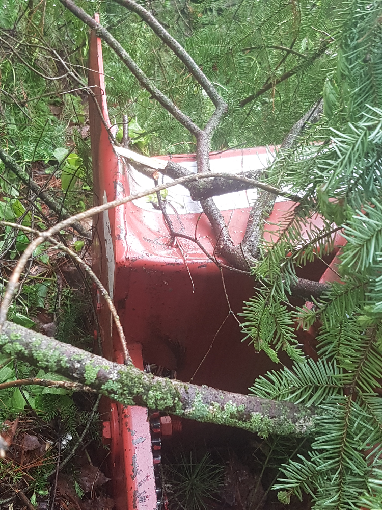

This is the blower in question. The circle and arrow shows the chute wheel (for turning it) but doesn't show one end of it bent down somewhat.
On one corner you can see other damage. I'm not 100% sure because I haven't used it since, but by hand I can turn
the auger, and I don't see any damage around the bearings etc. Fingers crossed.
The dent is not as deep as it looks. It's just the shell, not bent down enough to touch anything.

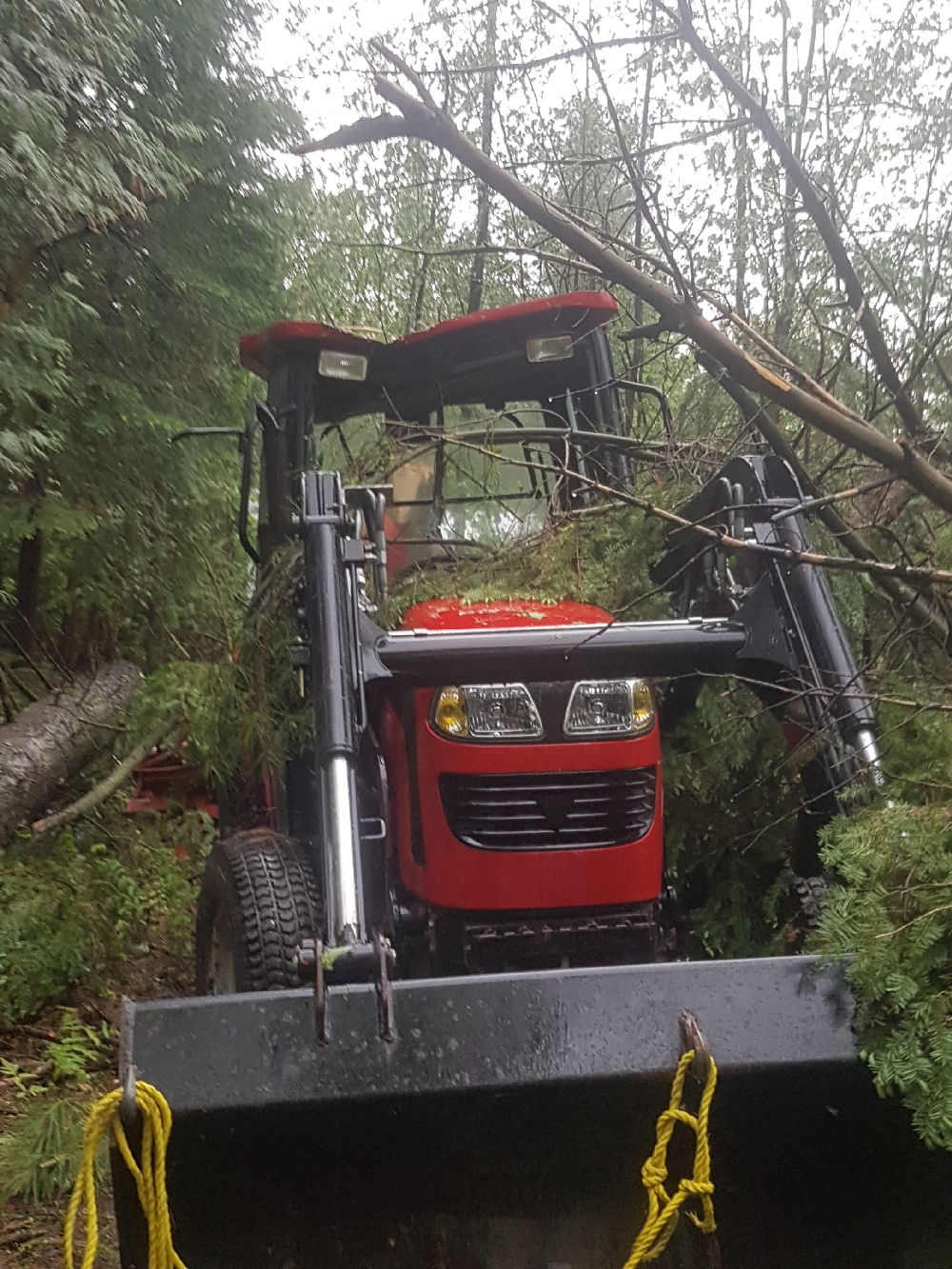

And just in case some were wonder about what Tacticalturnip was referring to, here's my poor Foton after the tree landed.
When it was given to me. The loader is behind it in this pic. It's a 2006 and the little hair-looking things are
still on the tires.
