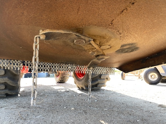

This year I will be doing the thickest of it with the modified brush hog. We cut half the blade length off and added chains. I think they call it a slasher. works like an industrial weed eater.
