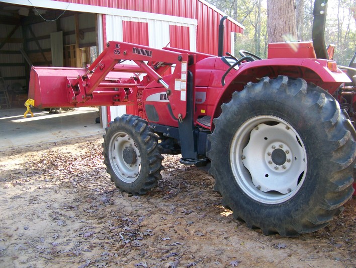

I rented a 3PH auger with a dull cutting edge before.:mad: That and me having elbow surgery said to get the hydraulic auger. Just made sense...and no aches and pains.
Now with it ready for the FEL, I won't need to pull a bucket and thumb off before mounting it.;)

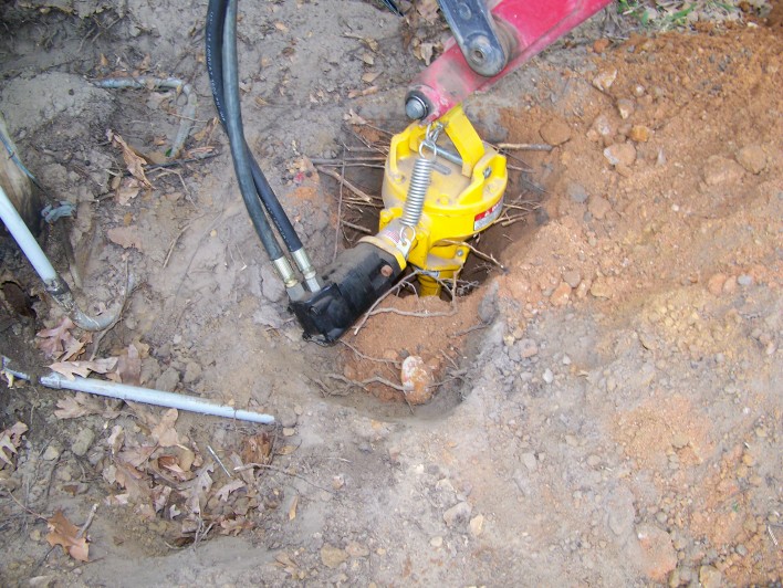

I built an adaptor for Curly Dave to use his hydraulic auger on his 110tlb but haven't been able to come up with a good yoke design. The adaptor that I built is almost a carbon copy of the Frontier adaptor but the yoke on Dave's planetary head requires different dimensions. Sure would like to resolve this.
Here are a couple of pics of the build I did. Notice the cradle leans back and away from the drive when it is hanging plumb. You can build or add this so that when you curl the bucket it cradles the auger.

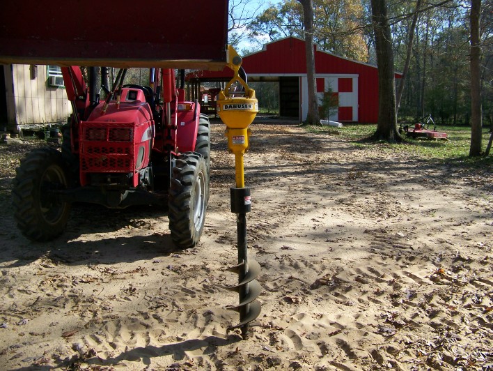

But, on a tractor, off to the side gives you a good view of the ground contact point.
hugs, Brandi

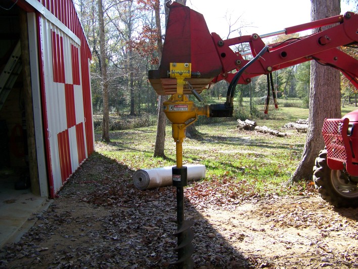

I noticed that, on your first picture. You'll have a good view of exactly where the point is starting to dig.
The only problem I see with the side mount, and I'm not sure how valid the concern is, is that you might be able to twist the loader arms if the auger bites hard under a rock or tree root. The trouble with mounting it on the center line of the bucket is the hood obscuring your view of the auger.
I doubt it'll pull hard enough to twist the loader permanently unless you held the valve open and let it pull the end of the bucket down. One way to reduce the risk is to adjust the remote pressure relief to a low enough value that it will stall the auger before it can damage the loader. You could set it quite low to begin with and see how well it digs, if it's too lazy simply increase the pressure setting until it works well.

I will be interested in how this works for you and it looks like a good setup.:thumbsup:

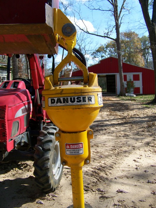

I'll take my changes, since Danuser has a mount for sale for the side of the bucket.
Glenn Danuser did suggest to watch the paint on the mount for cracking or distortion.

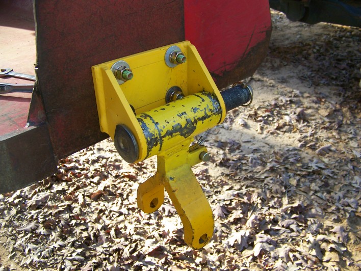

About the yoke, guress I need to make one similar to yours, if you look at mine in the above pics it is about the same size top and bottom whereas your is much wider on the planetary end.
   / Hydraulic Auger Mount
#31
Thanks. Now I see how it cradles it. Neat installation.

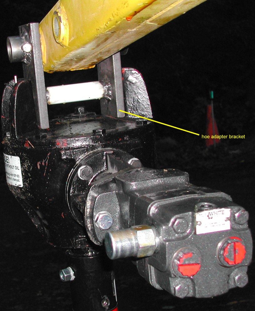

I got the auger motor assembly installed today and measured for 3/8 inch lines to the remote. I will need 16 feet x 2. First photo is the view from the seat. The 2nd and 3rd photos show overall installation, while the last photo shows a good close up of the bracket profiles.
Looks good, Brandi
Why do you prefer to have the hyd PHD on the FEL instead of the hoe?
As you start using it, I am interested in how you compare/contrast the
two different hyd PHD implementations.
I only have experience with hoe-mounted hyd PHDs, so I can not
compare with 1st hand experience. Mine came with the loader mounts,
but I made my own yokes to put them on my hoes (Worksaver 714H).
BTW, one of the 2 yokes I made could not handle the torque until I
reinforced it.

Looks good, Brandi
reinforced it.
DFKrug,
Thanks. I wanted a loader bucket position to dig holes for a fence line and getting on and off the BH every two holes to move the tractor gets old.
When I get the lines connected, I will post a progress report.
hugs, Brandi
