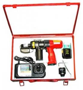

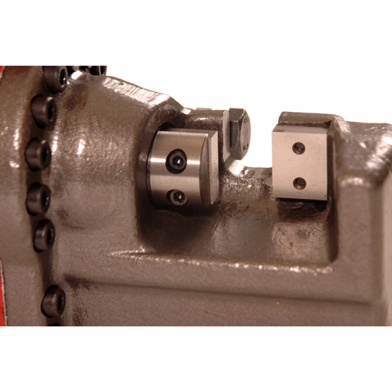

/ Hydraulic pump to weed eater platform #15
This is about as portable as it gets up to 5/8.
Benner Nawman Rebar Cutters
DCC-1618 DC-16LZ
The DCC-1618 cordless rebar cutter will safely and cleanly cut rebar up to 5/8謦*iameter grade 60. This self-contained electric/hydraulic unit will also cut other items like chain, bolts, and rod. The DCC-1618 can be used in rescue operations, cut in close proximity to a trapped victim, does not throw sparks or heat. The cutting head quickly rotates up to 345 degrees for using in vertical, horizontal, or difficult applications. A safety relief valve for retracting the piston and a cutting guard are standard features. This tool ships complete with (2) each 18 volt DC batteries, 30-60 minute fast battery charger, removable side handle, plastic carrying case, and a tool kit. Available in 2007
Second and third pictre is a different tool. Hitachi VB16Y Rebar Cutter/Bender, Grade 60, EVS
