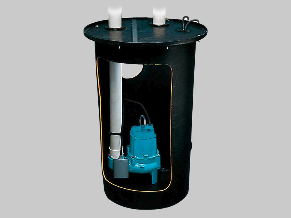

You want one to work off of a Yanmar PTO ? Or for a under $199 from Menards typically called a sewage pump?
We had/have flooding each Spring (except this year). I have a Brute plastic tall thick garbage can, place the submersible pump in there, and sunk it into the lowest spot in the yard to prevent the garage from flooding. It then sends the collected rain water or melting snows out the discharge some 300FT away and down a slope. Noting pools up anymore, nor does the garage have to swim in 4-inches of water.
They want too much money for this setup, so I made my own like it.
The pump I got. It's lightening fast removing the water, even in heave Spring flooding rains. Don't go less than 3/4Hp. Seriously.
This will pass up to 1-inch solids with no problems. And I have a reducer on it to go from 2" FIP to 3" PVC pipe.

That's a nice dewatering design, maverick. I've seen and made up several similar and use them around our basement and barn. They are popular with ourhigh water table here.
The project I have in mind that needs a pump will have to move a lot more water than an electric motor can do. And it must pull from greater depth than a suction type mechanical PTO pump can do.
That's why I am looking for is a hydraulically-powered submersible pump type rather than PTO or electric. I'll probably run it off the 90hp JD 310 backhoe. Construction hoes are set up for running remote hydraulic motors.
It turns out that new hydraulic submersibles are expensive, so I'm hoping someone has a used one available.
