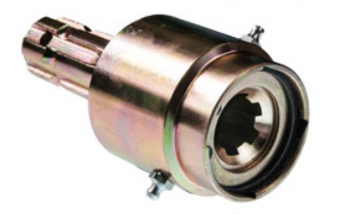

4A8C11E5-B764-4DBA-BEEA-179548D5A6E9.pngPersonally i like the overrunning clutch on my tractor, because the pto spindle is free turning by hand. Easy to line up.
