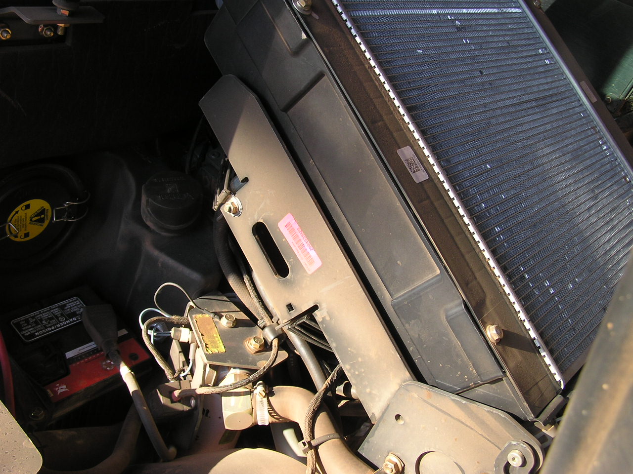

No, no problem with the air cleaner.

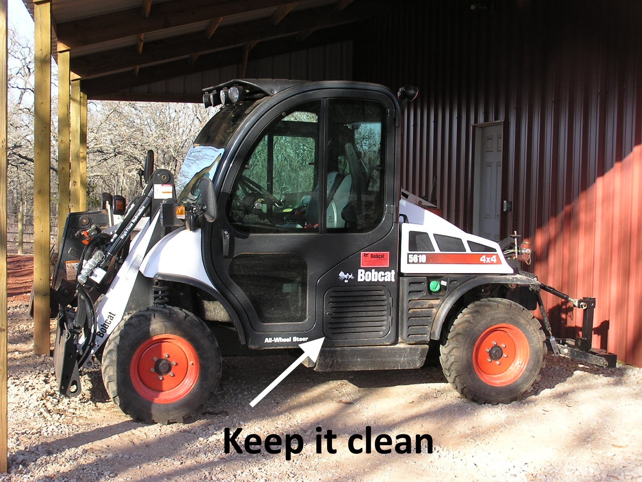

The air filter on the left side of the cab, for the air conditioner condenser coil, does need to be cleaned when the A/C quits blowing cold air.
We got the 5610 instead of a 5600 after reading about overheating when mowing with a 5600, due to the location of the radiator.
Is your air cleaner on the left side, above the battery, like ours?

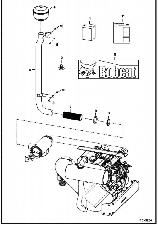

I have a G series and the kit is available for $265

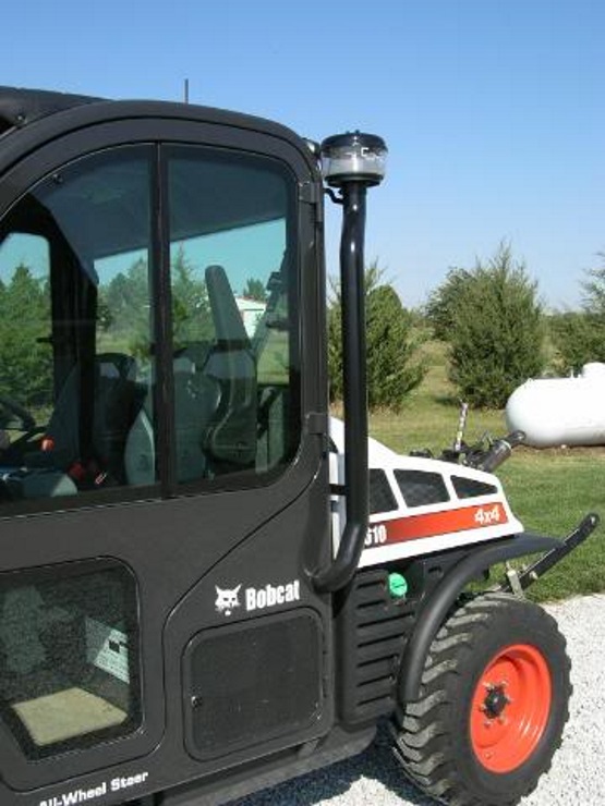

If you install the pre-cleaner, your air filter will last a very, very long time. I've got one on mine.
DEWFPO
   / If you have Toolcat questions, ask them here... #427
Pre-cleaner:
