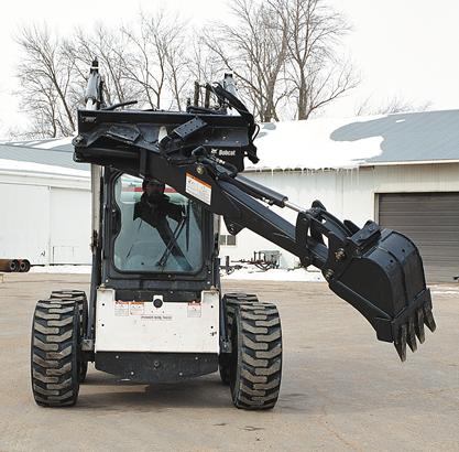

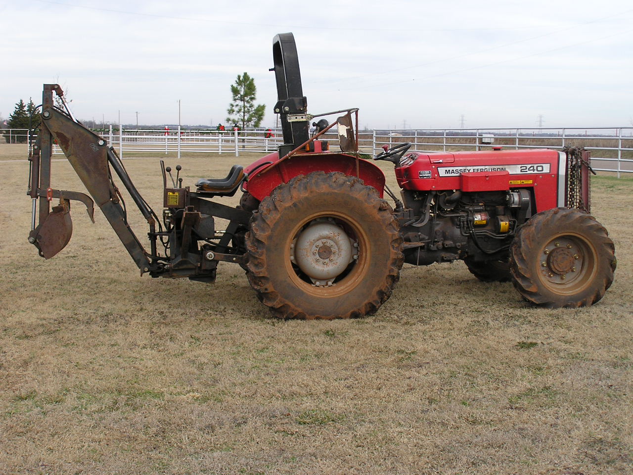

It does, I was looking to see if a 3point backhoe attachment would work on it.
It would work and probably bend or break something.
It wouldn't use the PTO.
I had a tractor that weighed just over 6300 pounds and a small 3 point backhoe on it. Using the dipper stick, it would pick up the rear of the tractor and move it forward.
Bobcat doesn't recommend using their SSQA mount backhoes (? Fronthoe?) on a Toolcat.
Bob-Tach(R) Backhoe Attachment – Bobcat Company
Backhoe Attachment - Bobcat Company

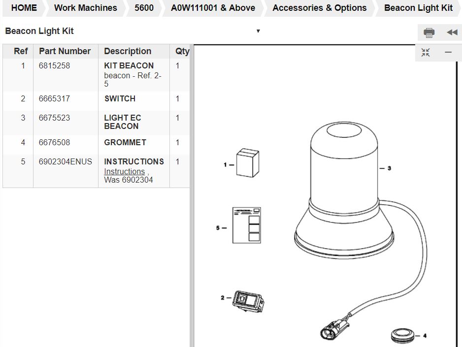

Does anyone know the P/N for the Dash Switch for the Rotating Beacon light on the roof?
