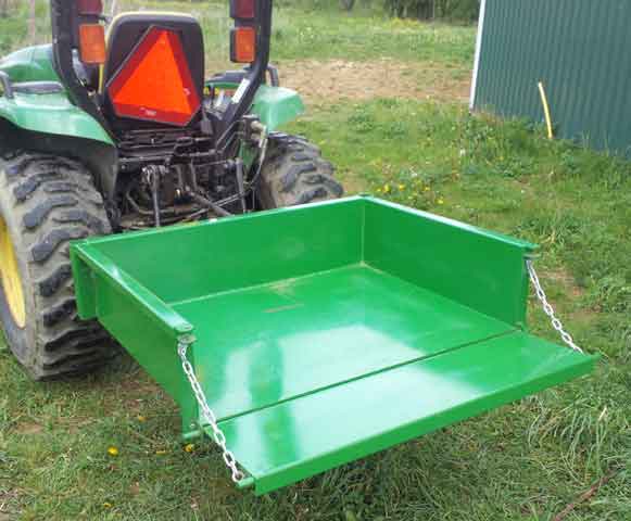

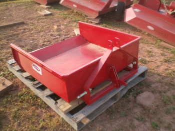

I'd recommend the 5610. Put a dump box on the three point:

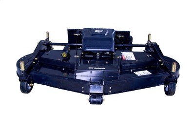

The out front finish mower:

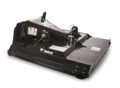

The out front Brushcat brush hog:

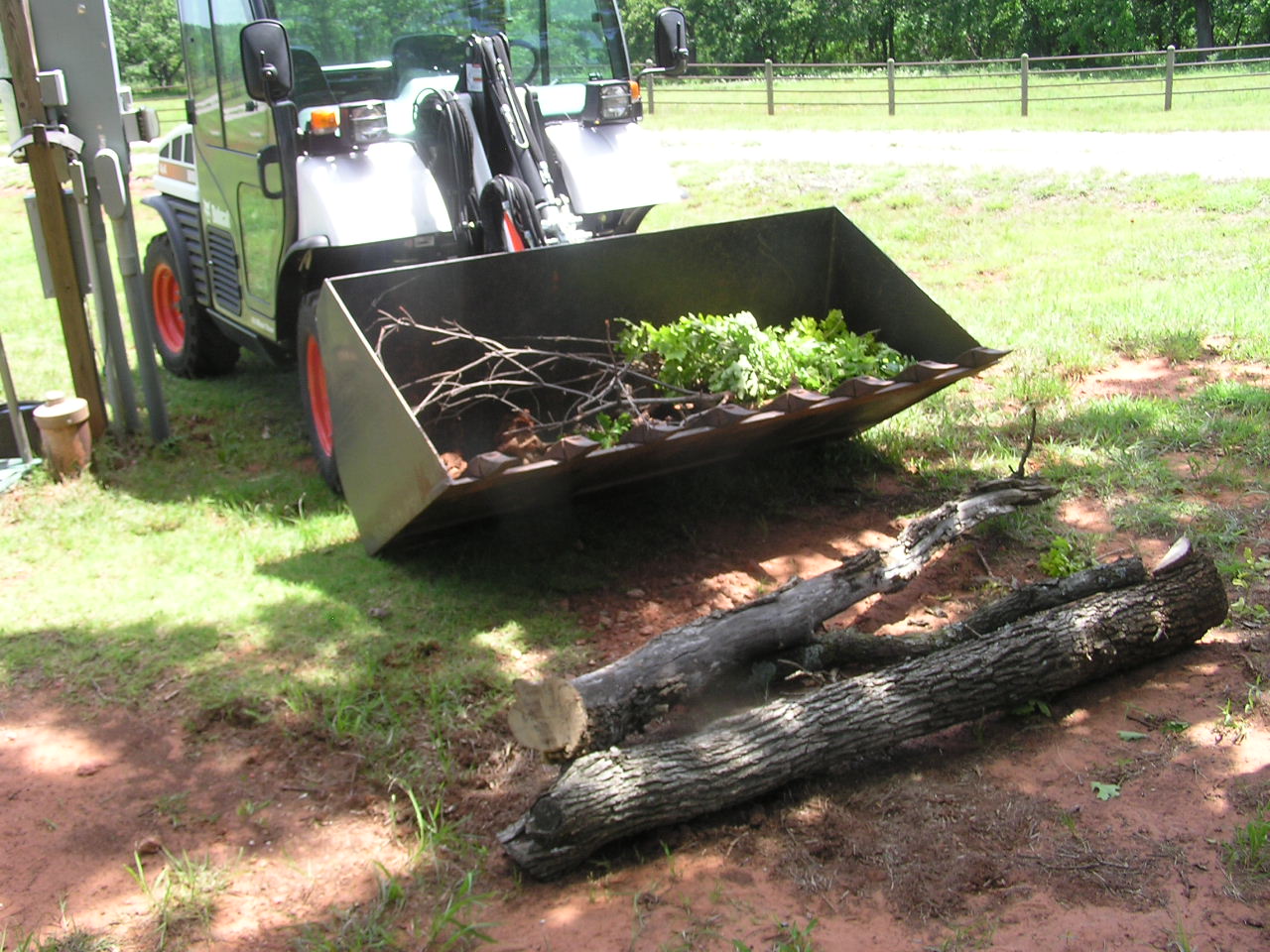

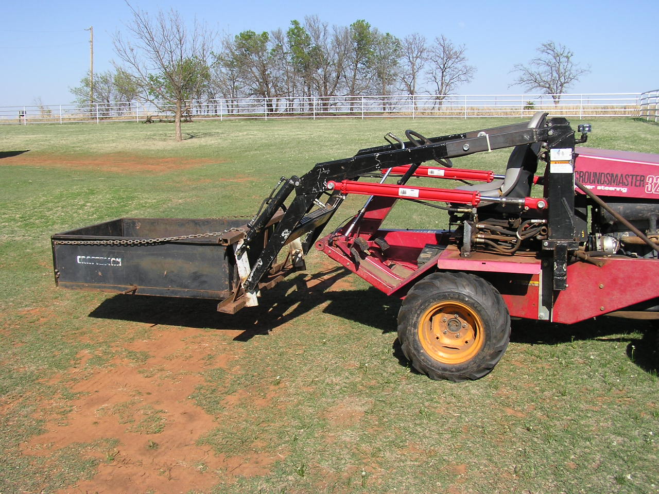

You can also rig up a box for the front. This one is setting on the forks:
I just use the 1 cubic yard bucket from the V417 Versahandler, loaded by hand:
