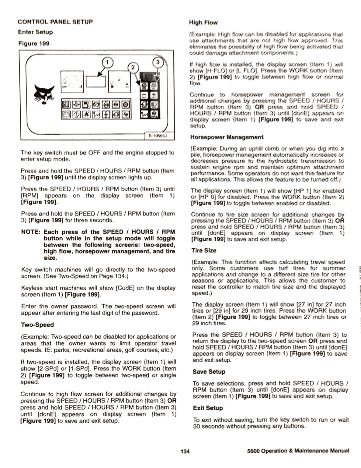

Question for you? Do you have a keyless start or key? Have you entered the control panel configuration to see if maintenance reminders can be enabled / disabled there? Like you can with 2 speed, tire size, etc?
Do you have the key sequence to go into control panel configuration mode? I can send it is you need it
   / If you have Toolcat questions, ask them here... #462
I have the key start. I have tried every combination I can on the control panel. The only thing the manual gives instructions for is reset password. Yes, please send the key sequence.
   / If you have Toolcat questions, ask them here... #463
Here is the key sequence to enter the control panel setup. It does not say anything about controlling the service hours display so if you cannot change it here then it must be an internal parameter that can only be controlled by service with their PC software.
Let us know if this has any impact...
   / If you have Toolcat questions, ask them here... #464
No impact. I have the manual this page is from. I'm beginning to think I'm beat. Looks like I have to go to a dealer with the PC interface to have it reset. Thanks everybody for all your help.
