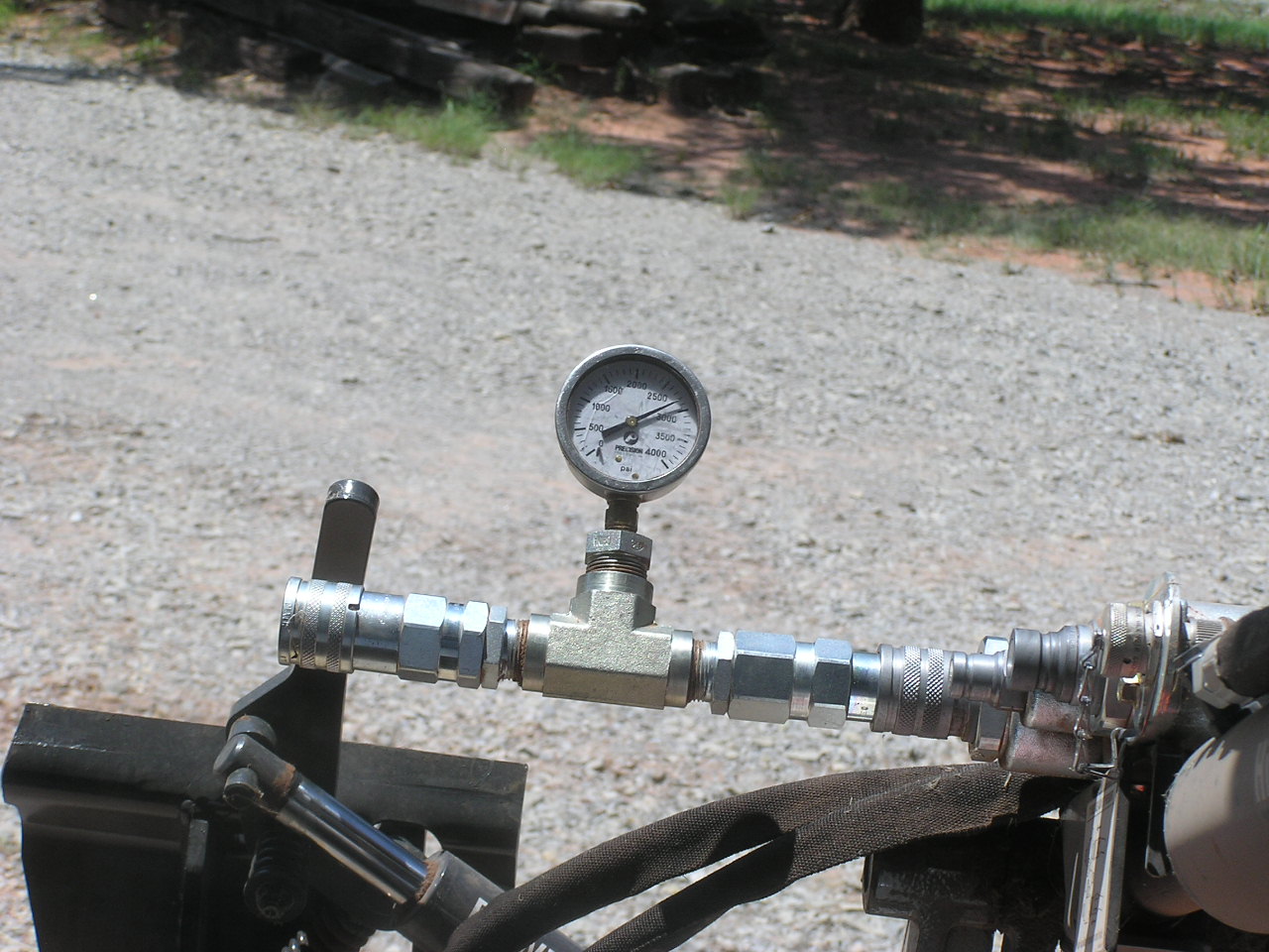

I put together a gauge to measure front pressure:

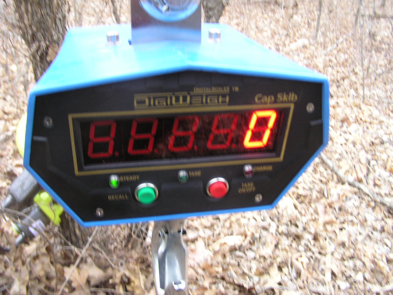

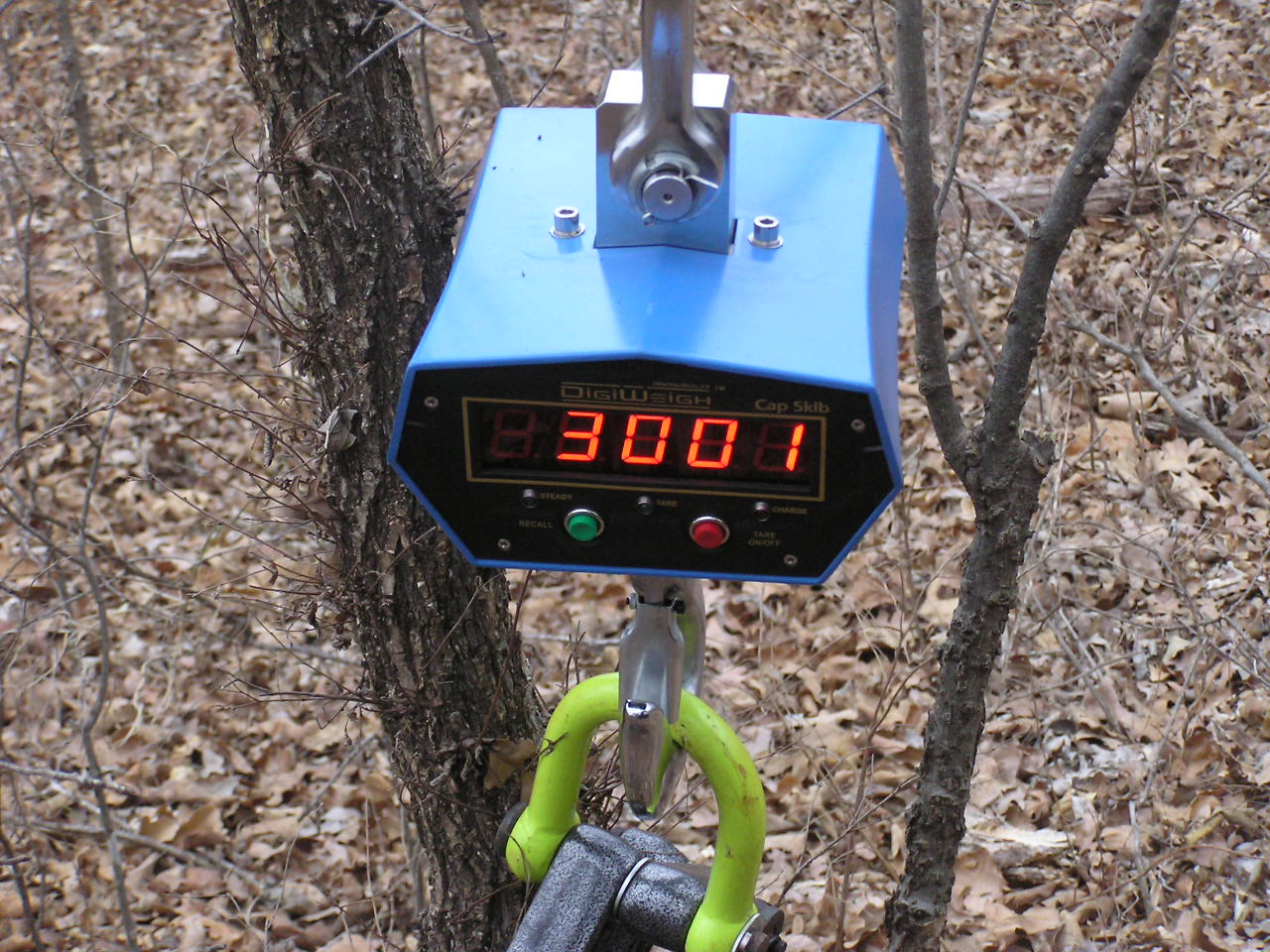

No experience with the early models, but I know that the F Series and the G Series would handle that job OK.
For skid steers the ROC (Rated Operating Capacity) is half the tipping weight.
Our F Series maxed out at slightly over 3000 lbs. without tipping or raising the rear wheels:
View attachment 672452 View attachment 672449

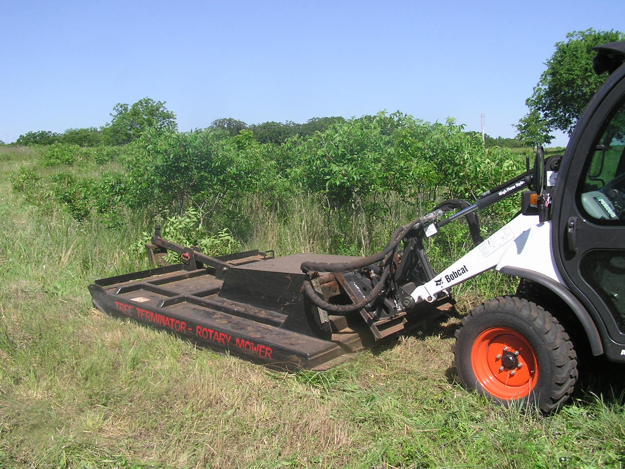

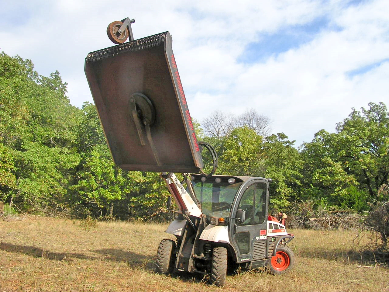

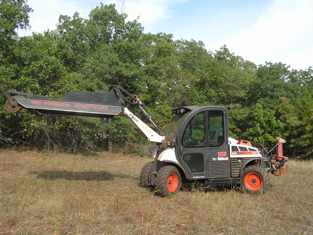

They handle the 1800 lb. 7' brush hog just fine and it's weight is farther out than a tote on forks would be:
View attachment 672451 View attachment 672450
