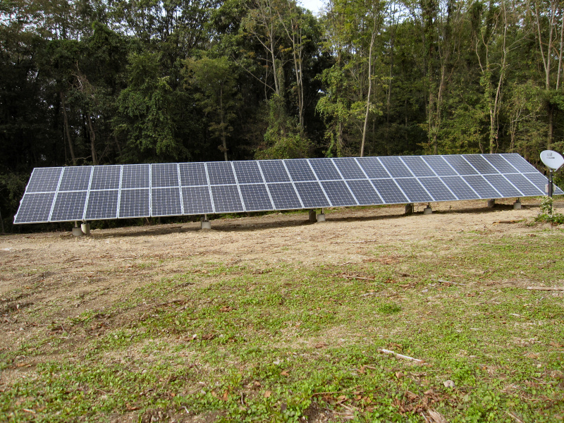

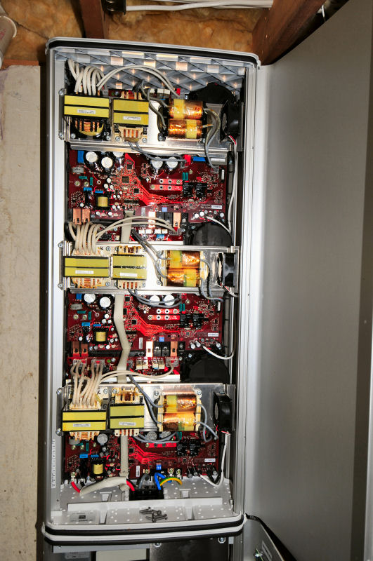

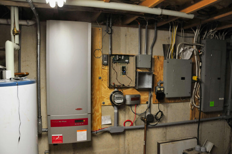

Here are a few shots of what I put in.
Also keep in mind you also make money selling renewable energy credits.
paul
