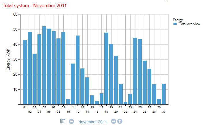

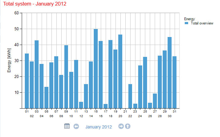

   / I'm considering having a solar panel electrical system installed. #109
Here you can see how the output can vary from day to day due to weather. November was relatively good, while January was not quite as good. I would love to have full sun for 5 hours a day, 30 days a month !
paul
