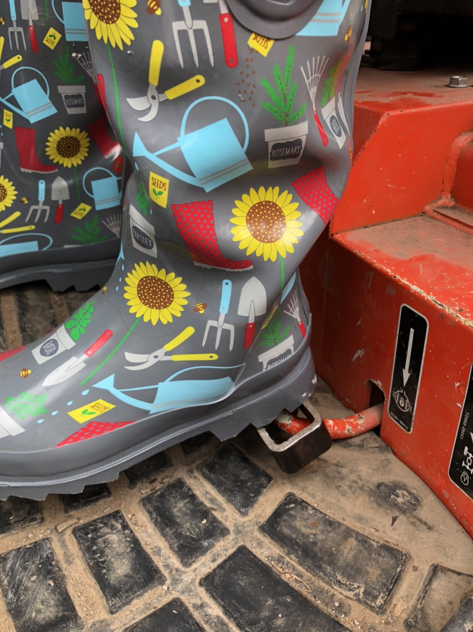

My wife put her foot down with this silliness.

Nice Mod Smokeydog!!

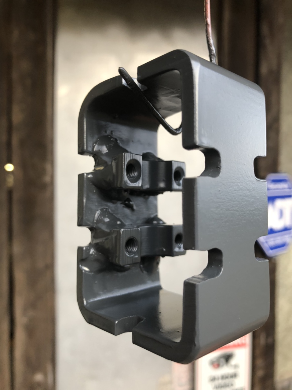

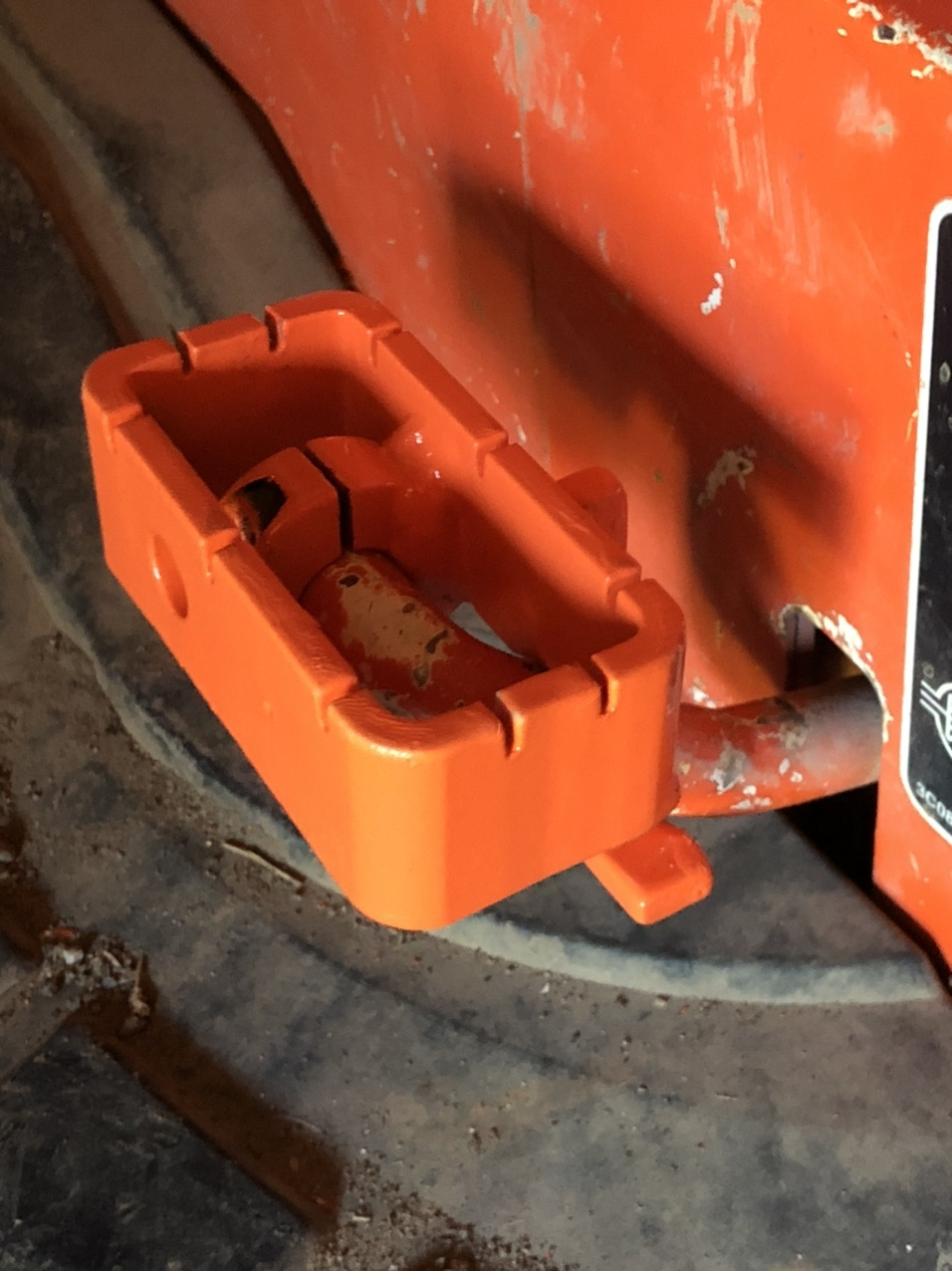

We use the diff lock regularly on our hillside farm. Might stop, might not. Takes rotation to engage after you press the pedal. Certain routine places Mowing, grading driveway, moving tree debris up steep incline. Can engage while moving before a trouble spot and disengage after the area. HST control makes this a seamless transition. Biggest beef is with the Kubota pedal design. My footwear traction is often compromised.

I like your pedal Mod. With bulky boots on it's hard to know when you've got it engaged until you apply power. My Kubota RTV is the worst. My old Ford is the best factory designed pedal.

Pedal for B26. Split shaft collars made for a easy mod.
