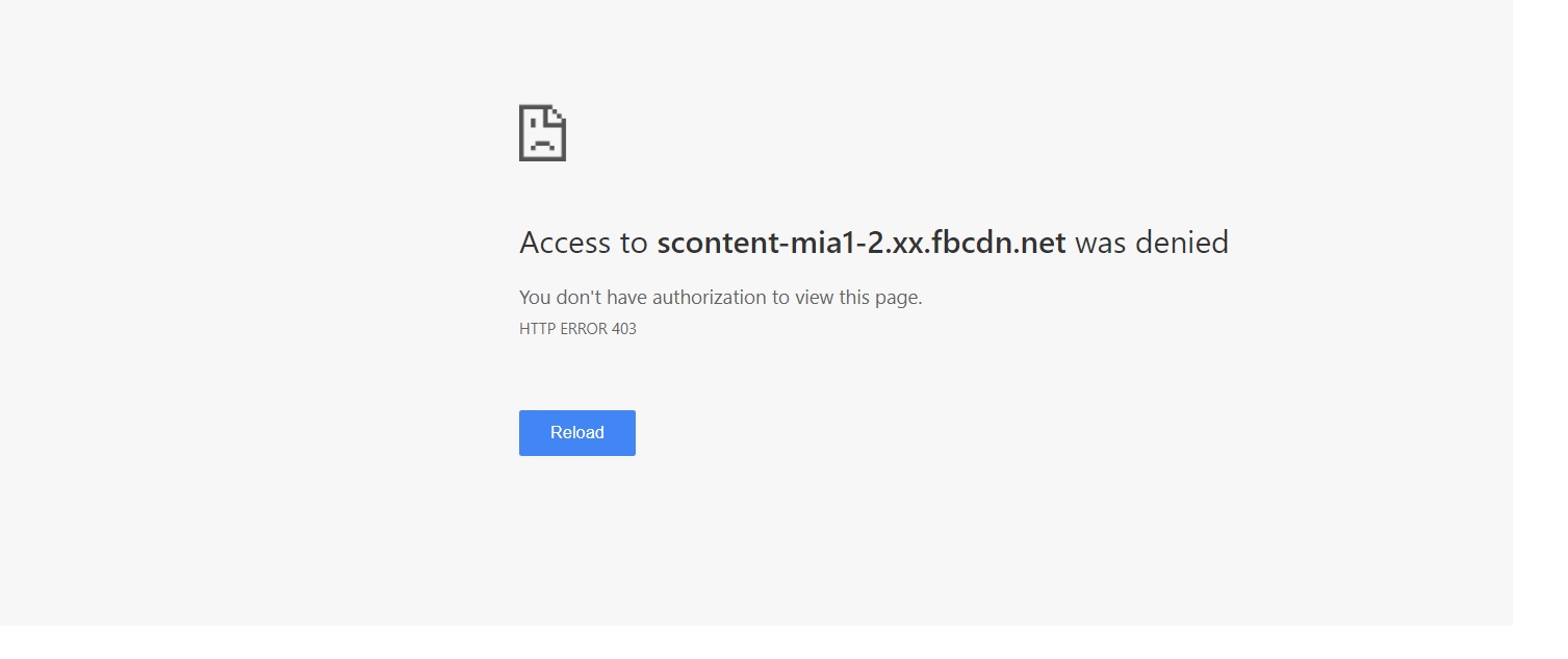

click on above ++++ to read what I get when trying to view your pictures

CDN = content delivery network, basically a temporary cache out on the network that facebook and others use to get some of the volume of bulky stuff like pictures and video off their main servers. These get cleared out fairly regularly.
CM will either have to find a link on facebook to post, or upload them to directly TBN...

Zero pics for me.
