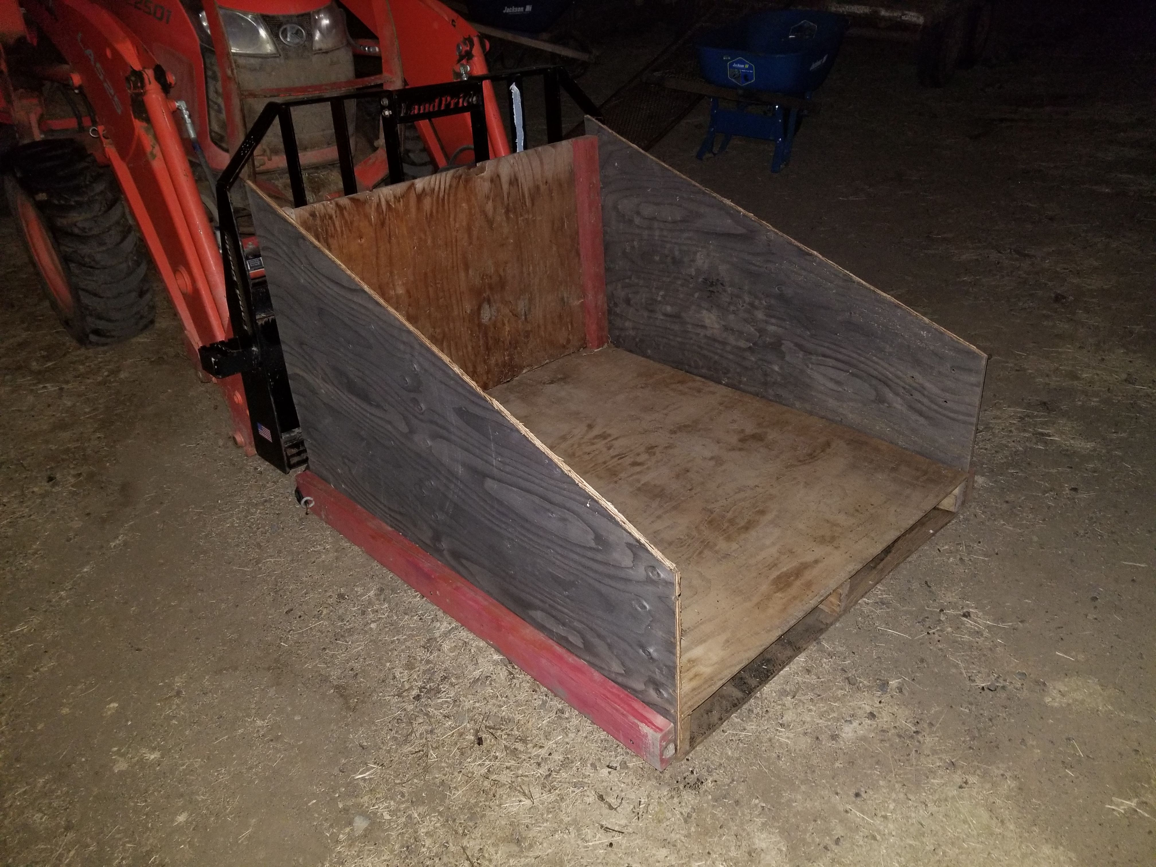

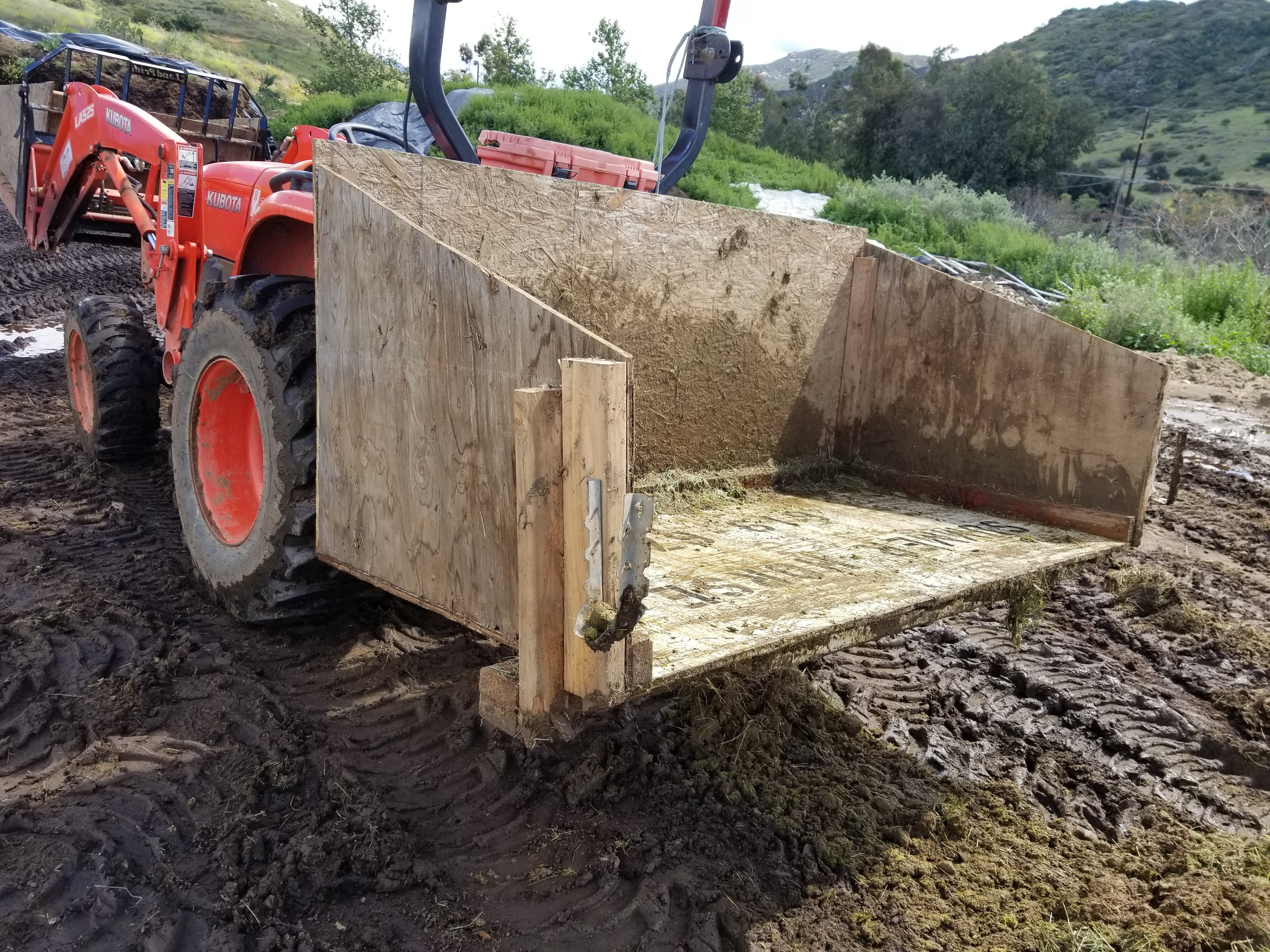

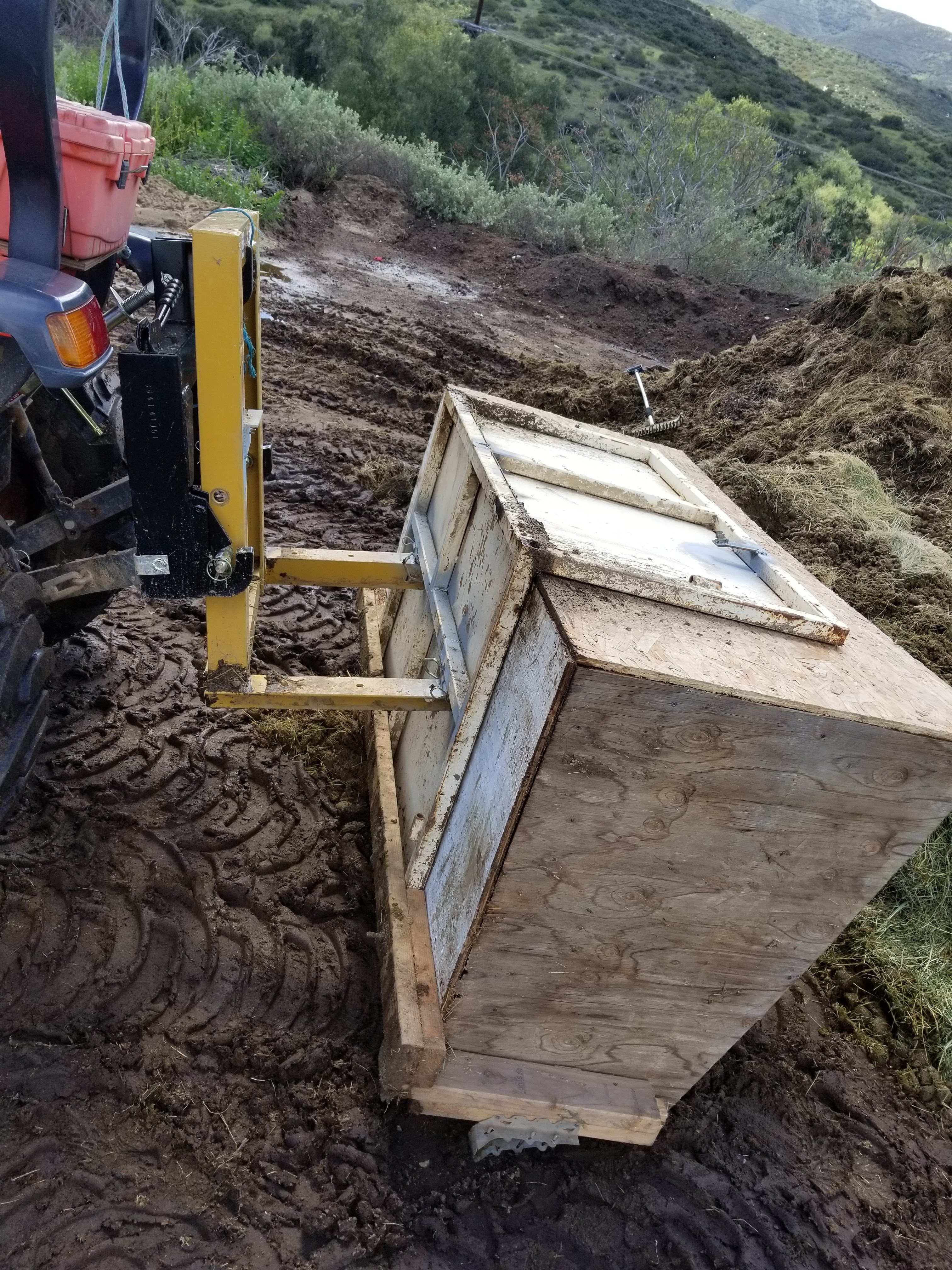

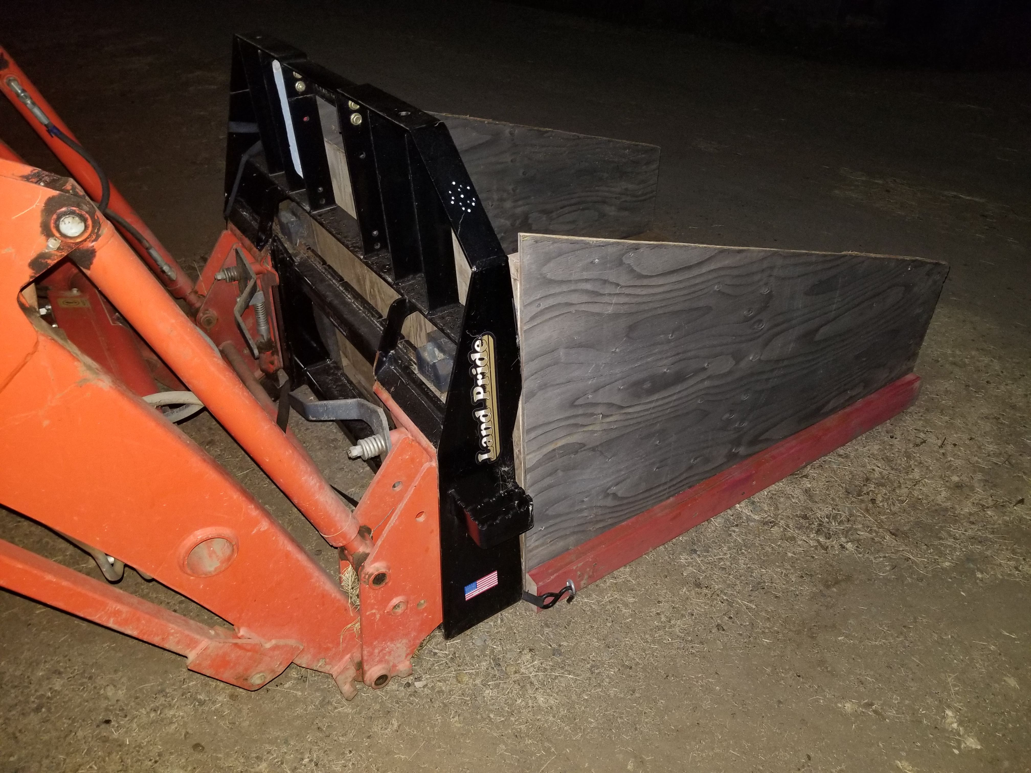

I have a horse boarding business with about 80 stalls that get cleaned daily. When we took over the business a few years ago their method was wheelbarrow up a ramp plopping it on an ancient heavy duty double axel stake bed trailer. At the end of the day they would tractor it down to the manure piles, remove the sides, hay fork it off by hand, then use a snow shovel for the last bit.
My first improvement on this when we got a tractor with a front loader was to use the bucket to push and scrape off the trailer. It went through the OSB decking faster but I only had to replace it every 10 months or so at a cost of maybe $40, still better than having to hand shovel that s*** off the trailer every day!
Now I have a dumping carry all on the 3pt and a pallet-fork mounted wood bucket up front. They were mostly meant to be prototypes - I'd like to order a SSQA plate blank and weld up a big steel bucket, maybe lined with replaceable plywood to deal with the corrosive manure. The dumping carryall I made too small to start out with, hence the wooden outer shell. I was initially worried that the 3 point couldnt lift enough but it's proven surprisingly beefy.
Unfortunately, it takes three trips down to the manure piles, also about 1/2 a mile like the OP, compared to the one big 7x11 trailer we were previously using. Our employees seem to like it better though. Definitely keeping an eye on this thread for more ideas!
