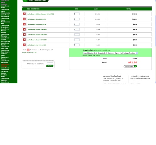

I bought the John Deere handle, shaped just like the factory one in my NX , the shape and button placement is very comfortable.

View attachment 623080View attachment 623081
I do agree that the JD handle is extremely comfy. My dad's 3046R has this handle and it is rather intuitive on the button layout. The NX I test drove prior to purchasing mine was 'acceptable' but not as 'natural' feeling as the JD UP/Down button location via the thumb. If this is something I cannot get accustomed to the pointer & middle finger layout I'll for sure be switching it over to the JD handle if it's only a $75.00 switch. I did not even think something from JD would be that cheap, lol.
What are the actual JD part numbers in your cart? The picture will not blow up clearly enough to read them.
+1 on countrybumpkin's suggestion.
I used the JD grip as well and I love it.
There was no Kioti option when I added the 3rd function and there were things about the WR Long kit I wasn't a fan of either so I cobbled together my own.
I attached my write-up from my project below. It should have all the part numbers in it you need. I got them from that thread or one like it here somewhere. ;)
