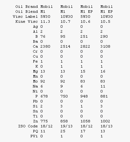

Na- 6,12
Mo- 44, 1
P- 668, 1161
Zn- 757, 1175
Ca- 2991, 2643
Barium- 0, 0
Mg- 13, 797
TBN- 4.5, 3.3
)</font>
Mike.. I've been meaning to ask this one for a long time. I'm already an Amsoil user so you're not having to win me over.. just asking out of curiosity.
The numbers above are all fine and good. But what exactly do they mean. Which chemicals in oil are bad (lower number better)? Which are good (higher numbers better)? Are they ALWAYS bad or good???? The chemicals may interact differently in one brands formulation that doesn't react that way in another.... In other words.. this particular chemical.. bad in one oil, but good in another oil. Just like the statement about additives in modern oils. It is not always a specific chemical that is bad... it may only be that chemical in conjunction with another that creates a bad situation.
   / Interesting article about oil change interval #50
Look for the wear numbers (Fe, Ni, Cu etc). Each metal goes to something wereing out. They should be very low as can be. The Zn, P, and TBN need to be high for longer drains. The Mg is another add that is good. Same with Ca. Example, si (dirt), if it is high, get a better air cleaner. TBN is good. If you have high Nox or OXD you will have a low TBN. So if your TBN is low to start with, your NOX and OCD will go up faster.
Mobil 1 oils for the most part are low in ZDDP etc. Just looking at the numbers my ZDDP is higher after 3X as longer in service and the wear number still look good.
Here is their new and there old. For Ref.
