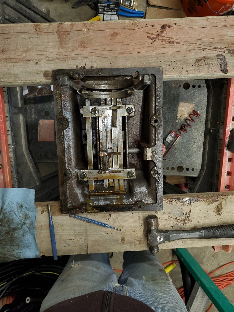

Another weekend update - the shifter is freed up, mostly.
The issue was 2 parts. The 1st part was gunk clogging the slot between the sliders. That prevented the initial side to side movement in the shifter. However, after disassembling the whole assembly it was apparent the larger pin was seized. It had enough slop somewhere that the shifter was able to move side to side somewhat with the gunk out of the way, but not enough to get it to move between the sliders. I sprayed the pins with Deep Creep penetrating lube and beat on the shifter with a ball peen hammer. This got things to move, but they will still need to be worked more to loosen up.
Pictures to follow.
The stage I am at is quite critical - this was the primary issue I knew of when we bought the tractor. So getting to this point - resolving it - is a big milestone for us.

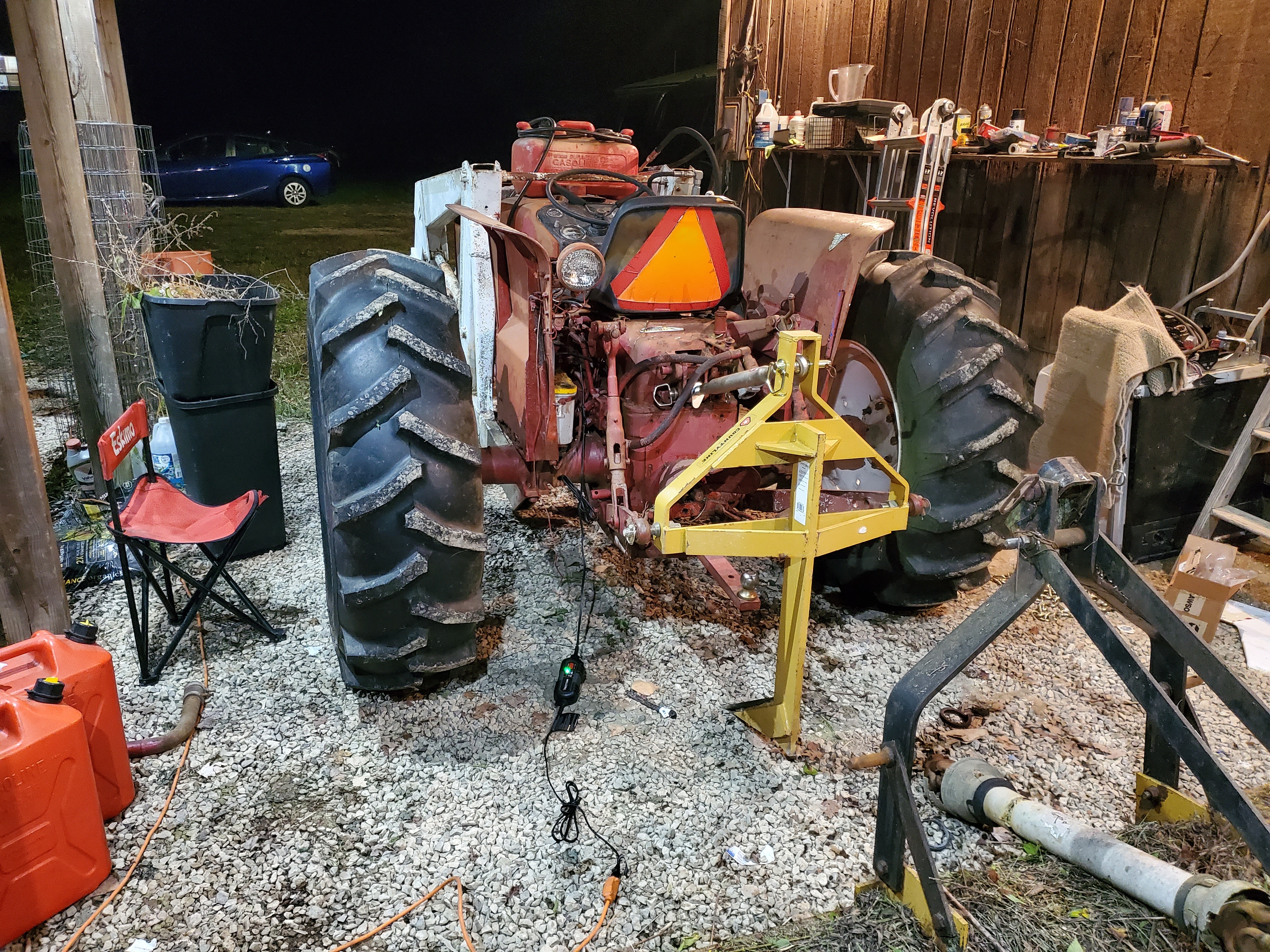

This is the rigging plate and rigging I set up with it to move the tractor. There is a 2" ratchet strap going under the door to a vehicle in the drive as an anchor for the front. I am thinking of putting a rigging plate up there, also, but I am not sure I want that "obstruction" in the way of the floor and rolling things by up by the door. So for the time being the strap out the door to an anchor method is fine.

Here are some pictures of the shifter assembly. There is some rust visible. However, the gunk between the sliders should be self-explanatory on the "hang up" issue.

Before I get to any of the pictures - we're at a pretty big stuck point. I can't get the shifter forks lined up with the slider gears. I had the transmission housing sealed thinking I was OK, but I got the trans in 4th gear and it would not shift back in to neutral. The shifter went, but it was still locked in gear. My assumption is the fork missed the slot for the slider gear and was able to engage it, but not disengage it.
After fighting with the forks and slider gears I did get a tape measure out to try to line up the forks and sliders starting from the 1st set closest to the engine - the range gears. Somehow I'm still screwing things up.
Does anyone have any words of wisdom?
My main conundrum with this one is I don't have all the time in the world to keep "test fitting" once I get the gasket sealant on. It does dry - which is where I am now. I had to tear it apart and have to start over with the scraping and surface prep.
My goal is to get things to line up so the cover and forks go right in to place routinely to build confidence before I coat the gasket sealant. This is one major step that has to be done right now otherwise I'll loose a couple months of work finding out after everything is buttoned up that it isn't "right".

Here are some pictures of what we did do so far.
This is a contrast between the non-prepped transmission housing and the prepped rear end housing. I used a polycarbonate disk from Harbor Freight. I've used these disks for surface prep prior to painting before and have had good results. It appears to have worked here, also.
I used emery cloth around the pins and other places where I couldn't get the grinder/disk.
This is the start of the rear end housing gasket. This is the 2nd round. The 1st round did not have the slice in it for the ring gear. I used the center cut out of that 1st attempt as the material for the transmission housing.
This is the transmission housing end of things.
As mentioned in the previous post, I am having trouble with getting the forks lined up. This gasket needs to be re-made and the surfaces prepped again at this point. But the pictures do a good job describing the process.
This is the gasket sealant I am using. Hopefully it does the job and lasts.

Your gaskets look great..!! I use several different Permatex brush on sealers, I've had good luck with taking parts back apart if needed without harming the gasket if I'm careful.
If it were me, I'd probably do a dry assembly first before putting the sealer and gasket on and make sure the shifters do what they are supposed to do. With the main transmission shifter and range selector in neutral, you could crib the gear shift mechanism up on 2 X 2 wood blocks. Might give you enough room to look through from the side with a good bright light and get the gears aligned to match the forks with a long screwdriver or something similar.
Most I've dealt with the top has to drop straight down. Having a helper makes it a lot easier to pull the cribbing then drop it down. I'd put the 4 end bolts in and snug with a wrench just beyond finger tight to make sure the shifter mechanism doesn't move, then see if everything shifts as it should. If it does, pull it off, prep the surfaces and go through the process again.
If memory serves me correctly seems I remember you having the shift assembly apart. Just be sure the shift rails, forks and detents are in the correct positions. Looking at the first picture, although it appears to be in first or third gear's the shifting forks side by side sort of throws me, but could be the way it is. Just so happened to do a Google image search and found a shift tower for a 444 on ebay. Even through it appears to be in neutral, the forks are staggered. Just doesn't seem possible for them to end up, side by side like it appears yours is. Maybe it's just the angle of the picture.

Thanks - and not the complement on the work, rather for the new skill. That is a big part of working on my own stuff for me - learning and growing. I've never made gaskets like this before and for all the projects I've done over the years - and will continue to do - it has already been a worthy skill to have picked up along the way here. So thank you!
I agree on the dry fit. The cribbing idea sounds like a great idea. I will have to give that a shot. I have a few options for things to use to knock the gears around if I have a decent gap in the housings to get through.
I was just trying to hold the gear shifter and drop the assembly as straight down as I could by hand. For as heavy as it is, that isn't an easy task (my back really hurts from all that yesterday). The cribbing idea will make that a lot easier for positioning. I'm thinking rigging a hoist to help support the weight also.
I did have the whole shifter apart - I had to in order to get it cleaned (what was the shift problem originally - gunked up and rusted). I did take care to assemble it the way I took it apart, after cleaning of course.
