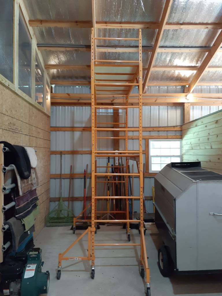

I was raised building houses and used scaffolding on every one of them. I have ten sets or so of mix matched, but I know how it goes together. Plus my dad has 6 sets that was always plenty for gables on most houses. Extendable Werner planks too. Plus aluminum scaffold planks. Easier to use a wheel barrow full of blocks to get it level outside. Plus three sets of wheels for on slab work.

The op has one house, on uneven ground, with decks. Any suggestions?

If the decks are over 5' wide, scaffolding will work, H type. If not 5' wide he can use pass through on the bottom, and then go up with H frames. H type is easier to climb. Swallow the hand rails in the pass through. It's called sidewalk scaffolding also, maybe other things in other places. Brick masons use it a lot.

Kilroy, that looks like a Lindal Cedar Kit Home. Very open spaces in that sort of structure. You will definitely want to buy your own scaffold. I don't have a Lindal, but a very open 50 foot Diameter Geo-Dome. And having our own scaffolding is a necessity and not an option. I can't even service the ceiling fan with out the scaffold. Its 25 feet up. :) This will sound stupid, because it is, in that I rented my scaffold for three years at $110 a month as I built the house, and then just bought the whole thing for $1,200 dollars. I should have just bought it out right, in the first place. :)

Get a set of levelers - I have several sets, one set even has locking wheels. I don't break down a tower every time I need to reset, I simply unlock the wheels and roll it where it needs to go.
