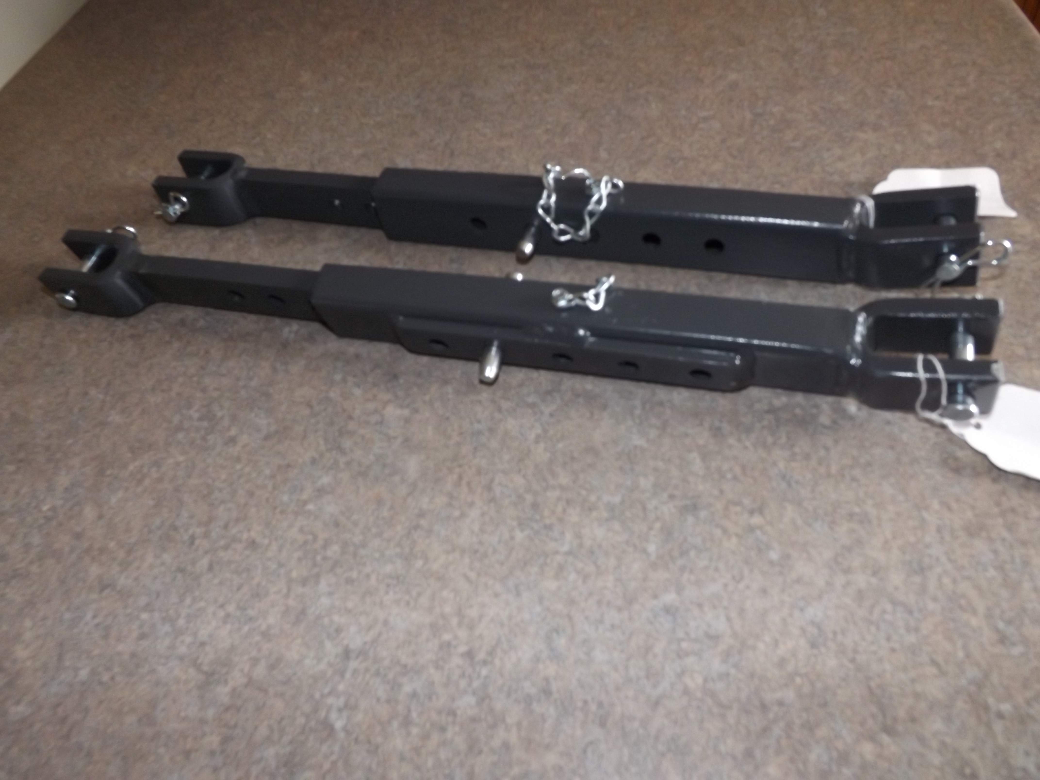

Mcaveman my picture wouldnt upload from the ipad but heres an earlier post. #7 has my pics with Stabilzers and Pats. I have/had Pats speader bar but it was bending since it was hitting one of my implements, and you still have to mess with the turn buckles to keep it from swinging, etc. Still kind of a pain in the ...These Stabilizers cured both problems and it only takes seconds to adjust. Mark has excellent craftsmanship, but I understand he's very busy and far behind. Good luck.

I've had a PATS for quite a few years. Love 'em. I use the width adjustment the tractor has...no problems.
   / Is there a easier way to adjust width on 3 point? #15
There's a good reason why Kubota puts a similar system on the deluxe B's and on up the line. The economy series B's and the BX's with turnbuckles? No way. I've had them. No thanks. Everyone has to find what's right for them and their operation, but I'd not have a small Kubota without these. Life is far, far too short. Best mod, for me, ever.

Not sure what Mark charges, but you can get a set of stabilizers for the L from Kubota for $175 (that's retail, dealer's price may be lower). Wholegoods part # L8430. I have them on my L3200.
   / Is there a easier way to adjust width on 3 point? #20
For a BX size tractor, I think mine were $130-140 or so.
