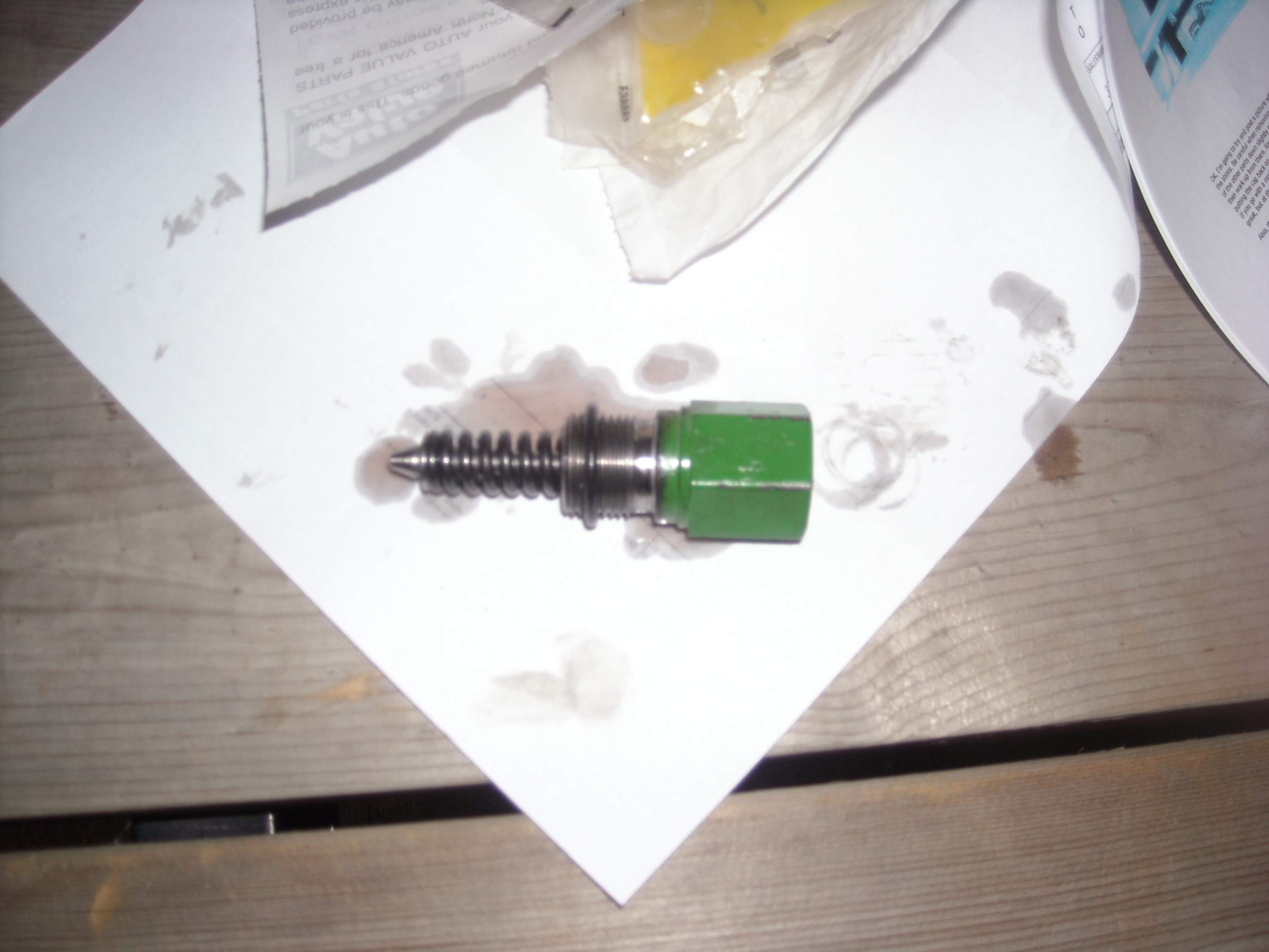

I dont know which PDF you downloaded so here is an expanded view. #8 is the factory shims you add to. Some of those small parts will stay inside the cap when it is removed. When I added shims to my 790, one shim dropped out of the cap as I lifted it off. Had to get a flashlight to find it. Cleaned it up, added new shims, put it back together, checked pressure. For no more work than it is, (10 minutes including finding a flashlight) it made a much more usable loader out of it.

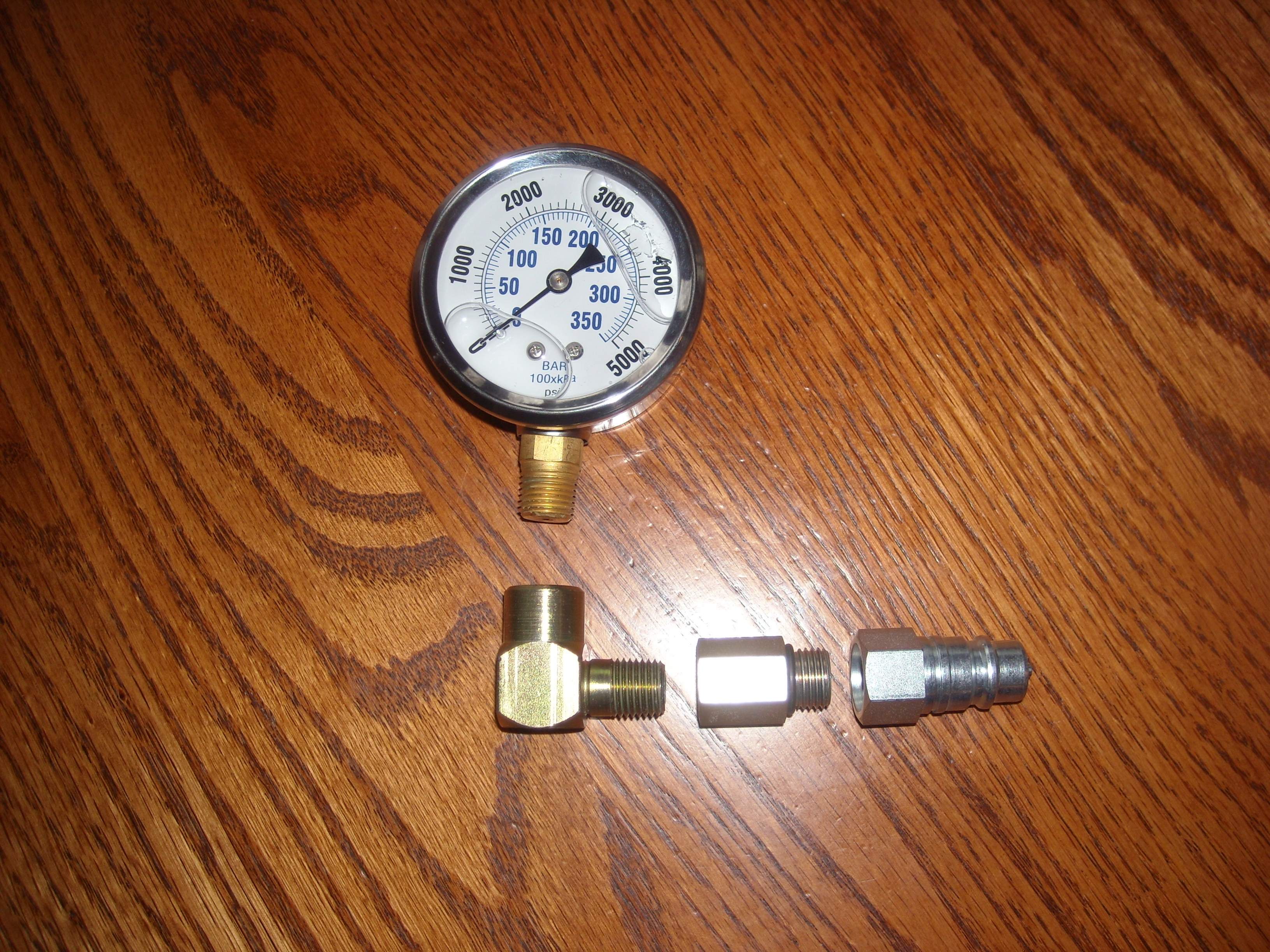

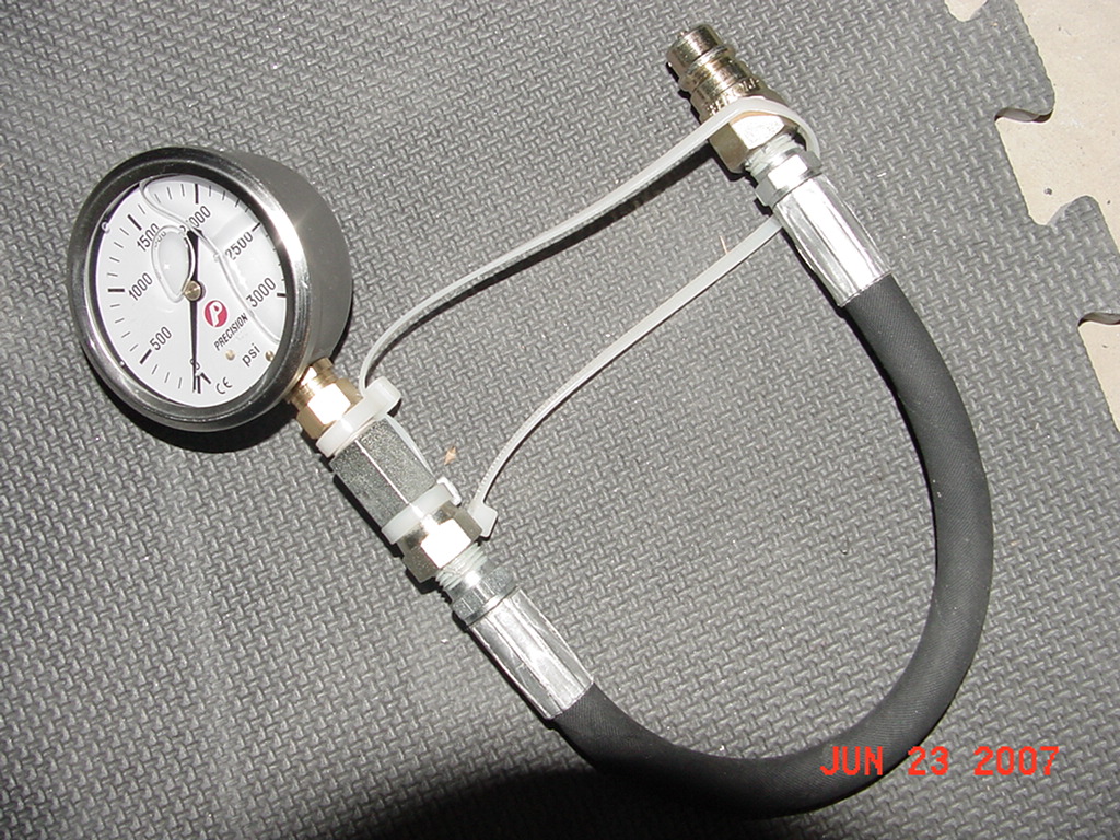

TSC (if you have one close) sells a 0-3000 PSI gauge for less than $20, plus a short piece of hose-the QD nipple can be had from JD for about $6.00 or so.
If you want to buy online I can refer parts from the Surplus Center.

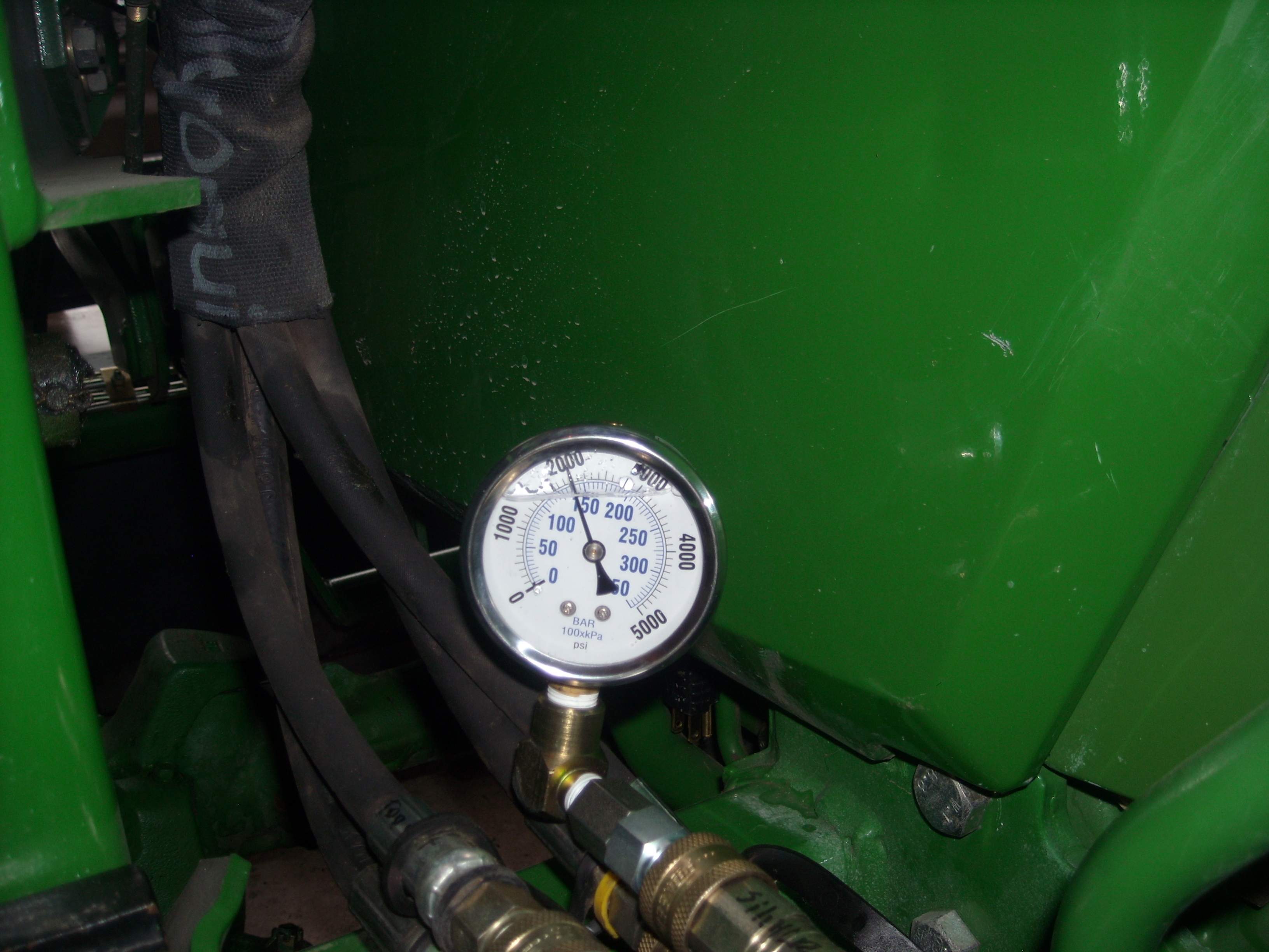

Attached is a picture of my gauge-you just plug it into one of your loader ports, then you move the joystick to pressurize that port and observe the reading-that is your relief pressure. Take measurements before and after you add shims.

I looked at my shim package today....and there were 4 shims in the package (they were just stuck together). I think their are two (maybe more - didn't measure 'em yet) different thickness' of shims to allow for different pressure needs as determined by the gauge readings. I also got my coupler from John Deere and assembled the fittings to my guage as shown in the photos below.
The JD quick-coupler I got has an o-ring requirement....so I went to our local auto parts store and found an o-ring equipped fitting to attach to the coupler along with an elbow. Total cost of the guage ($14) fittings ($6) and Quick-Coupler ($10) is $30 plus change for mine. A pretty inexpensive way to gain about 20% improvement in hydraulic capacity. :D
I still need to assemble my guage with the sealant tape...so don't send the hydraulic/safety police after me. ;)
Just be very frugal with the tape, and keep it away from the first two threads-also make sure to wrap in a way that assembling the fitting wraps the tape tighter-NOT unwraps it.

I (finally) added my shims today to increase the hydraulic pressure on my 790. I attached some photos below to show the gauge and pressure gain I got from 1 package (of 4) shims. Both of the gauge readings are at full throttle....photo 1 is before and photo three is after adding the shims. I had hoped to get a few more lbs of pressure....but I think its fine for now.
I have always been able to lift the front of my tractor with the loader...quite easily.....even at idle, and before adding the shims. Some have claimed they could not. I just got my tractor in December and have not had an opportunity to see it work in the field. So, time will tell if I add any more shims.
I had to pull the O-Ring from the cavity and slip it over the threads (as shown) into the groove located at the top of the threads. (its shown part-way up to that location in the photo below). Otherwise the O-Ring prevented re-starting the threads for me.

Here is what transpired today: The hose I am working with had a 1/4" NPT male swivel fitting on one end and a 1/2" NPT male fitting on the other.
As you state, the 1/4" NPT end of my hose did not exactly fit a JD male QC. The threads on an O ring fitting are slightly different. Luckily, a place that does hoses is 2 doors from my JD dealer. So as you also say, I had them cut the hose at the 1/2" end and crimp a new fitting on that would accept the JD male O ring QC.
