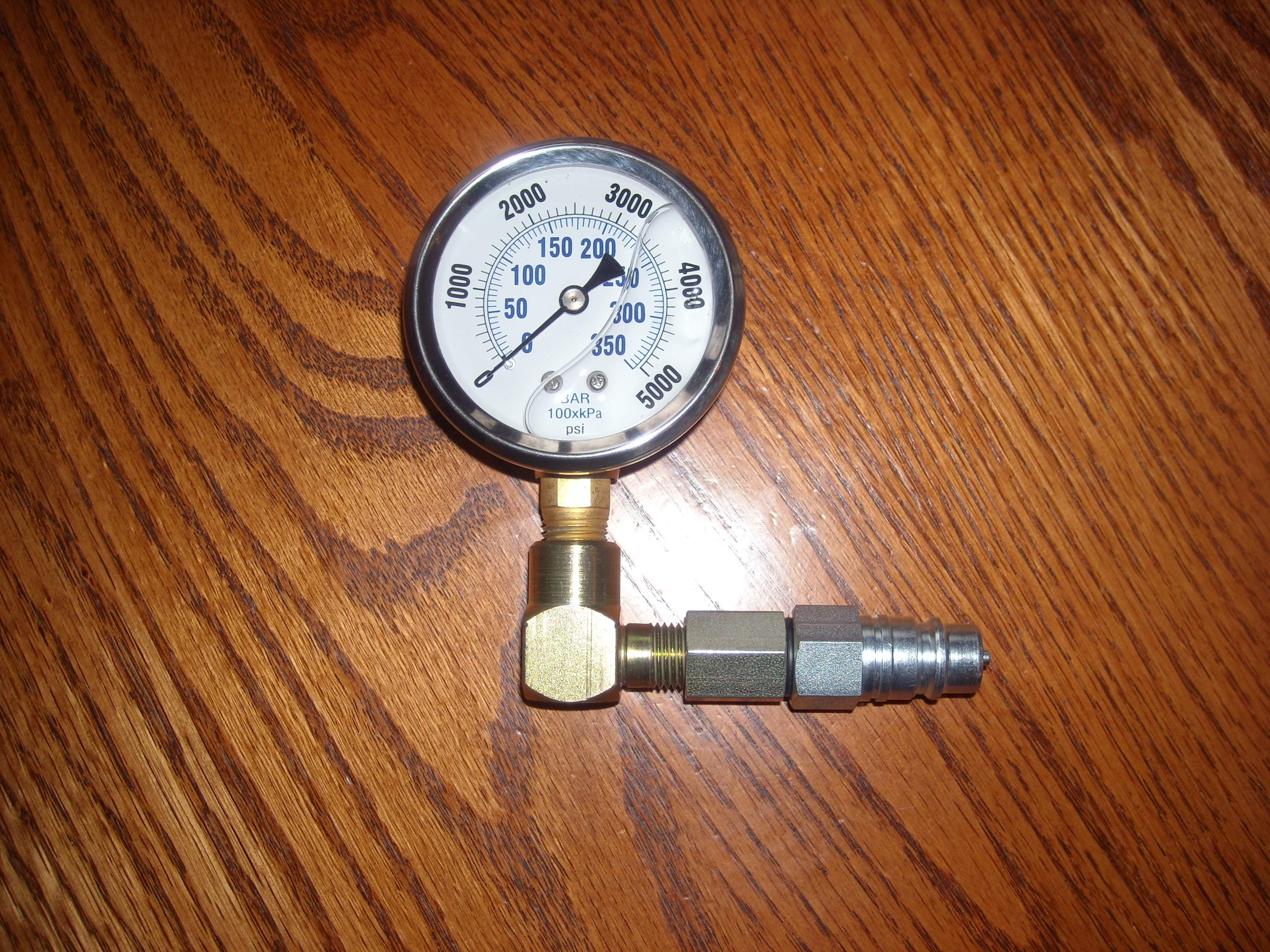

Gauge put together and working fine. Box stock the tractor is showing 2200 psi at the QC that curls the bucket. Will most likely only install 2 of the 4 shims and see what I get.

Well, now you all got me interested in upgrading the hydraulic pressure on my 790 so I called my local JD dealer this morning. He didn't have the shim kit in stock, but he's going to order me (2) packs @ $3.78 each. They'll be here on Wednesday. I also stopped by my local TSC for the pressure guage and they didn't have one, nor did they show it in their latest TSC catalog either! Foggy, do you know the SKU number of the pressure guage you got at your TSC??? If you have it, either post it or send me a PM with that number. Thanks.
I did stop by a NAPA after I left TSC and they listed one for $25, but he would have to order it too. So, I'll have to keep looking for a guage at a reasonable price. I hate to spend more than I have to for something I will only use one time. I haven't tried the AutoZones or Advance parts stores yet. If they carry one, it should be cheaper than NAPA's price. Might do that later today or tomorrow.

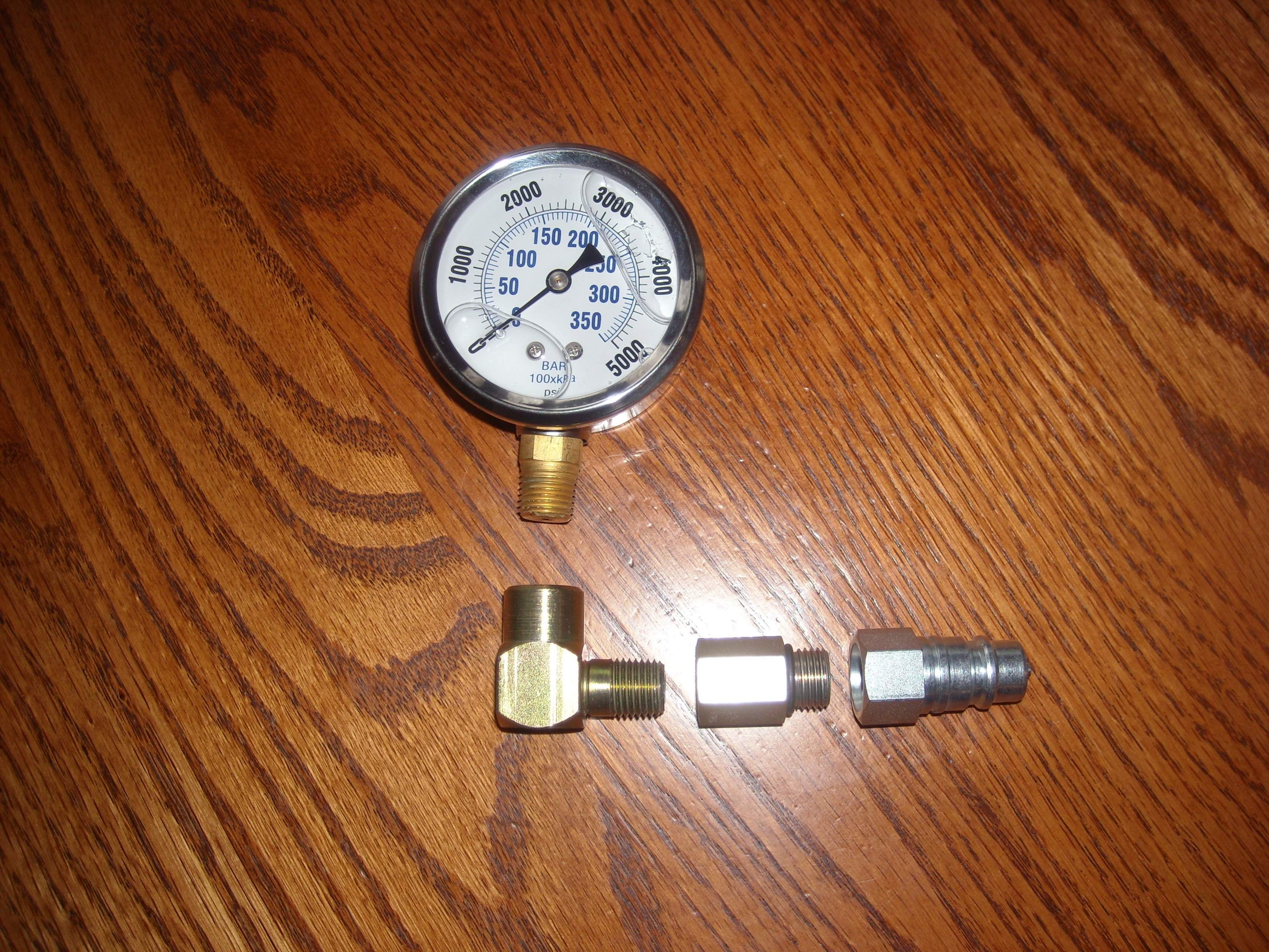

I did go the $25 gauge route at NAPA. Had to order it but my local store get most everything in the very next morning. Keep in mind you'll have the rest of your expense to plumb the thing up unless you happen to have stuff laying around like I did.
Even then I still had to get the male QC from Deere and have another end to fit the QC crimped on at a hydraulic hose place.

kebo, here is a cheap 3000psi gauge that will work. They dont have the gauge I bought from them listed any more, but this one is only $12.95. It is made to mount in a panel, but for what you will be doing with it, it will work just fine. Here is a 5000psi gauge for $12.95 that will also work.

It looks like the hose connection to the panel mount guage (21-1637-BL) is a 1/4" NPT male, that should do the trick. I think I'll call them first thing Monday morning. If they can get it to me by next Friday, I'll go ahead and order it. Thanks!

Ok, I ordered the shim kit at my local JD dealer earlier this week and it came in today. They were kind enough to call me and let me know too. Actually, I ordered two packs, appears to be (4) shims in each pack. Have not opened or looked at them closely to tell if they are all the same thickness or not. I also got an extra O ring, but I think I got the wrong one. I got the one in the exploded assy view that's #16. I didn't see the #21 O ring beneath it, that's probably the one that I might need right?? Might have to call back and see if they have that one as well.
Also, I stopped by a local hydraulic hose and fitting shop convienently on the way home from work today and he had EXACTLY what I needed for the gauge. He sold me a 0-3000PSI gauge for $18, plus the quick-connect fitting for another $9, and them some change for a bushing to mate the two up. All for $30 bucks with tax. Got some pipe tape at Lowes and put it all together this evening. I may attempt this tomorrow if I get time, if not, it'll be next weekend before I mess with it.
