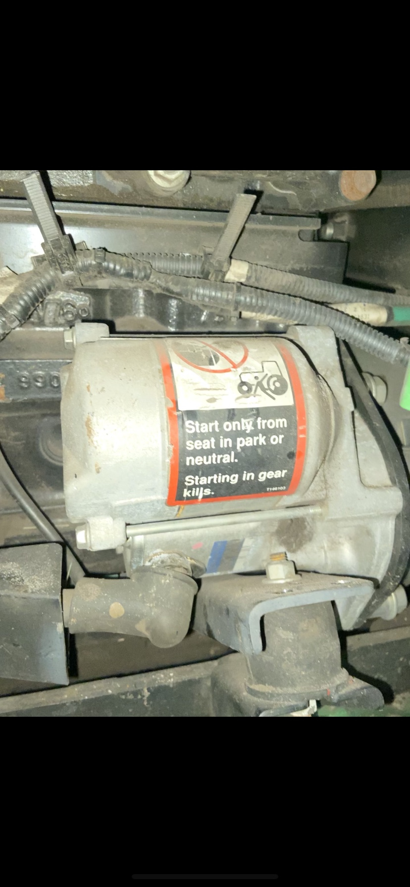

I figured I would start a new post on this. My tractor had been partially under water in Orlando during Hurricane Ian. After, it would only start on the second attempt.
Today, wouldn’t turn over at all.
With a small board, tapped on the starter solenoid while trying to start. Just the slightest tap an it starts. Have to do it every time now.
Read that you have to pull exhaust muffler and left motor mount, jack up to get out. I’m curious if anyone has pulled the solenoid on top with starter in place ? I’m not sure how it’s connected. If so I can get to it easily to take off an clean.

Will do, I plan to work on it tomorrow. Looks like the solenoid is gear driven. I’m hoping I can take the two top bolts off solenoid and slide out of starter. Really need to take starter apart an clean as well, but need my loader for all the cleanup I’m doing. I’ll let everyone know how it works out. Just glad it’s narrowed down to the starter. Relay troubleshooting is not one of my strengths.

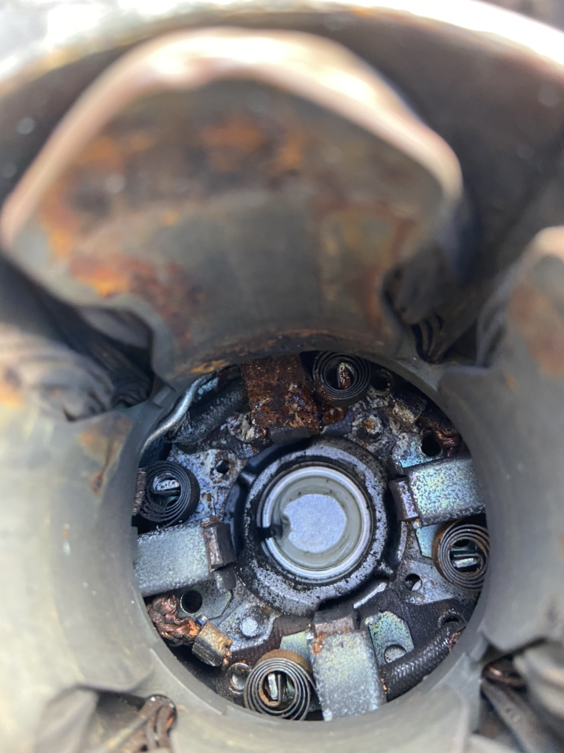

Got the top “ starter off this am. What a complete bugger. No way to remove the whole assembly without pulling engine or putting a double nut as a jam nut to back out the stud. Even then not sure enough room for wrench. Luckily I see the stuck brush and think I can repair. $126 for whole new unit. Be glad to buy it, but not going to tear the tractor all the way down to replace just a starter

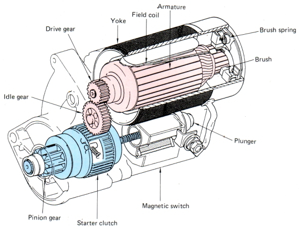

Also it appears this is one of those reversed ones where what you pulled off is the motor unit and the solenoid is the square unit below and it looks like there's some internal gear reduction in between on the right. So I think the thing you've been tapping on has been the motor
If enough water got in there to rust out that brush in the motor unit I'm thinking there's likely rust elsewhere as well.
   / Jd2305 starter #9
I found this pic of a Yanmar starter cutaway on another post by bmaverick (thanks bmaverick!) and I think yours is set up similar:

Thanks for all the input. The top part of the starter is the motor. I was able to disassemble, clean up the stuck brush. I just put it back together and just clicked. One tap on the top and it starts. I’m going to Oder the new starter. Then once I have it try to change. As one said, water has to be down in the bottom also.

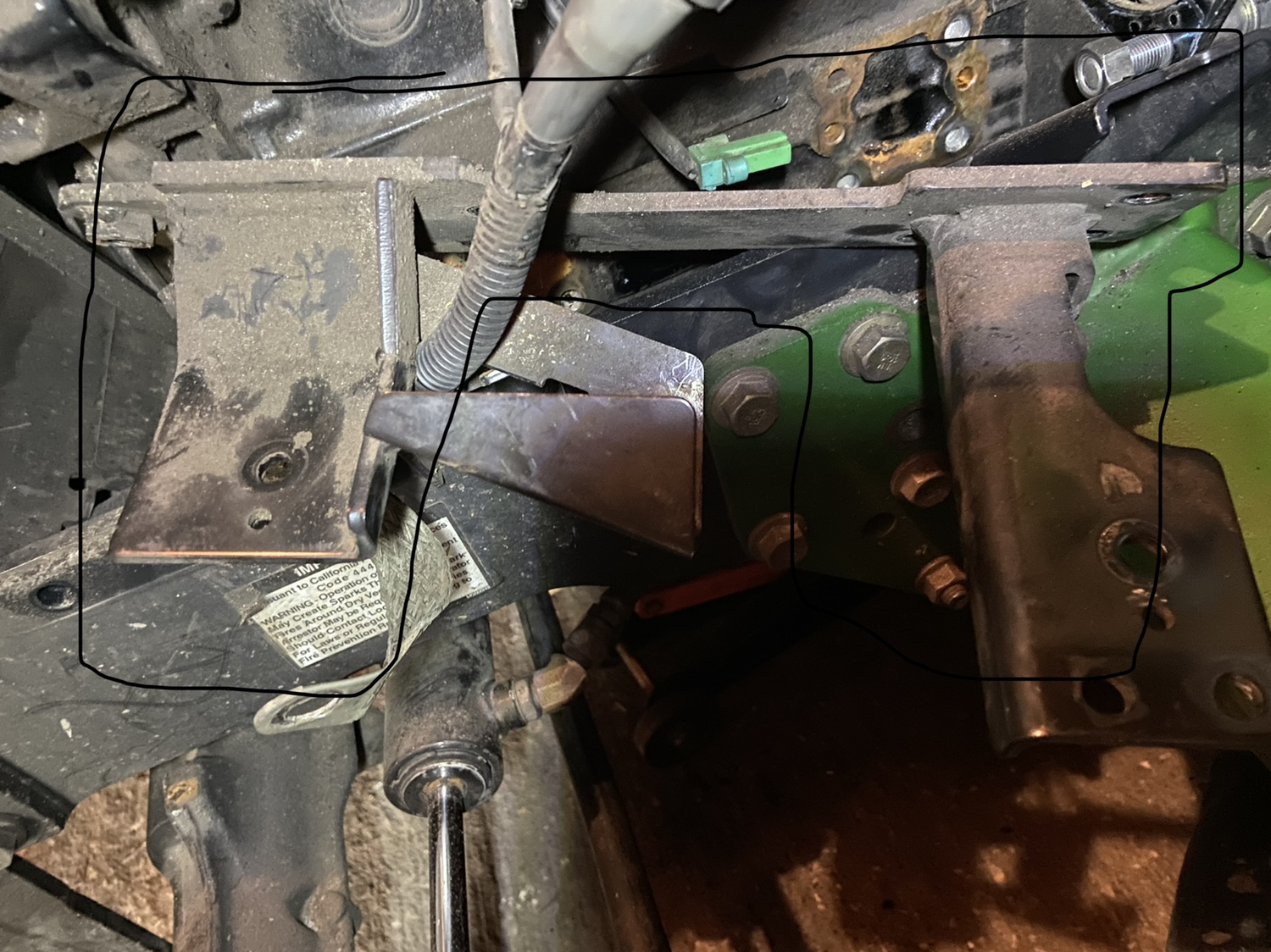

I just started tearing into it again. It looked like the top motor mount was welded to the engine. What I just figured out is it’s a plate that runs the length of the engine. Has two motor mounts welded to the plate. About 7 bolts. Won’t be easy but there is a way. Whew. Thanks MTGreen. You were 100% correct on all.

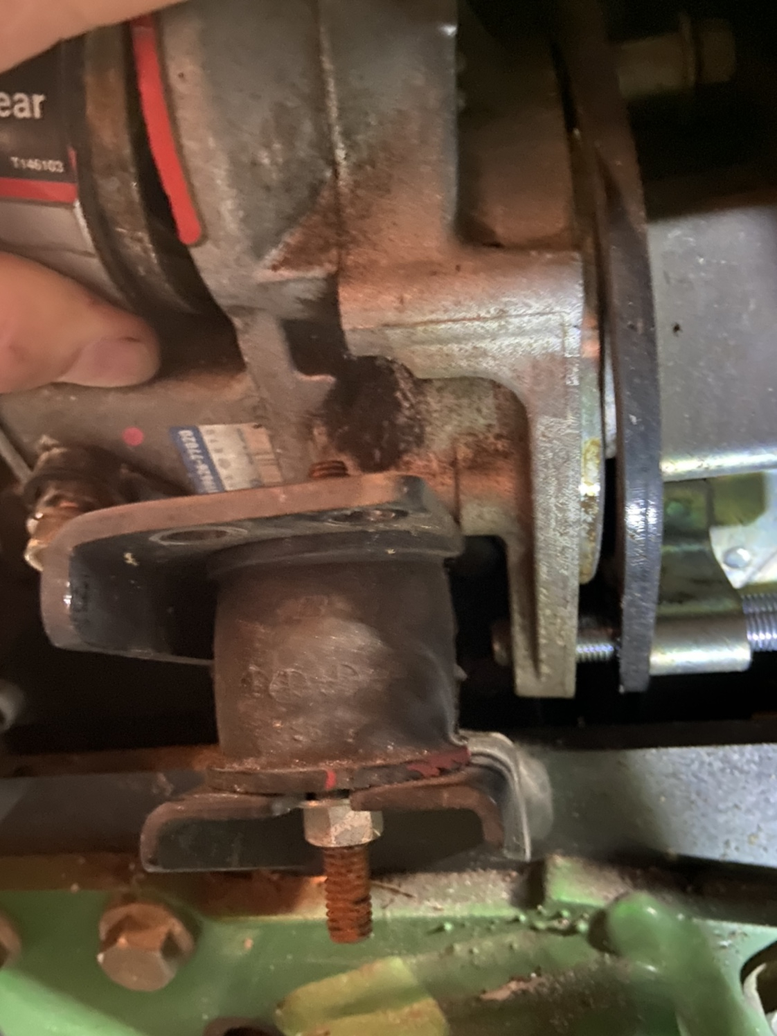

The top plate for motor mount has to come off to get the starter off. I removed the 7 bolts the hard way from underneath. What I now realize, and the easy way…. Nuts off motor mounts. Jack up motor from underneath. Allows access to all 7 bolts on mount from the side. Took less than 20 mins to put starter on and reassemble everything. Jacking up motor is key.
