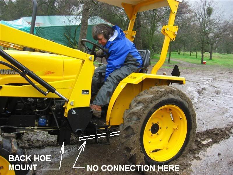

   / Jinma. Any good? #23
One other thing that needs to be brought up.
On the factory 284 Jinma loader brackets, they did not go back tied into the rear axle like my Koyker loader does. At least not on her ZL20 loader. I don't know how it is on the larger models? I would consider this an important feature to help disperse loader stress to the bell housing and transmission. I still need to do this on Loretta's tractor as a stress safety feature.
A subframe for the backhoe is equally as important for the same reason, plus the added torsional stress from sideways digging. I don't have a backhoe for the Jinma, but I believe their factory back hoe subframes tie into the tractor both underneath the rear end and up to the front somewhere.

The ZL-30 on my 354 mounts to brackets bolted to the bellhousing, no connection to the rear axle.
When I purchased my tractor/backhoe, there was no frame mount option. But, the FEL brackets appear to have accomodations for one, so I suppose I could convert with a custom mount that would tie the FEL and backhoe together and to the rear axle. Maybe one is available now, someone might chime in.

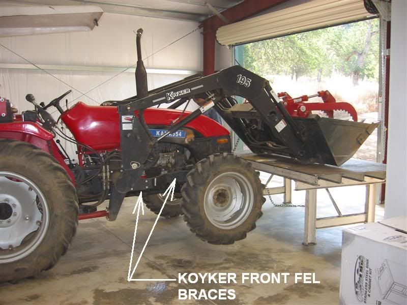

My buddy got a Kama 354 with the ZL-30 loader and it was not tied into the rear axle either. He made heavy brackets to complete the connection.

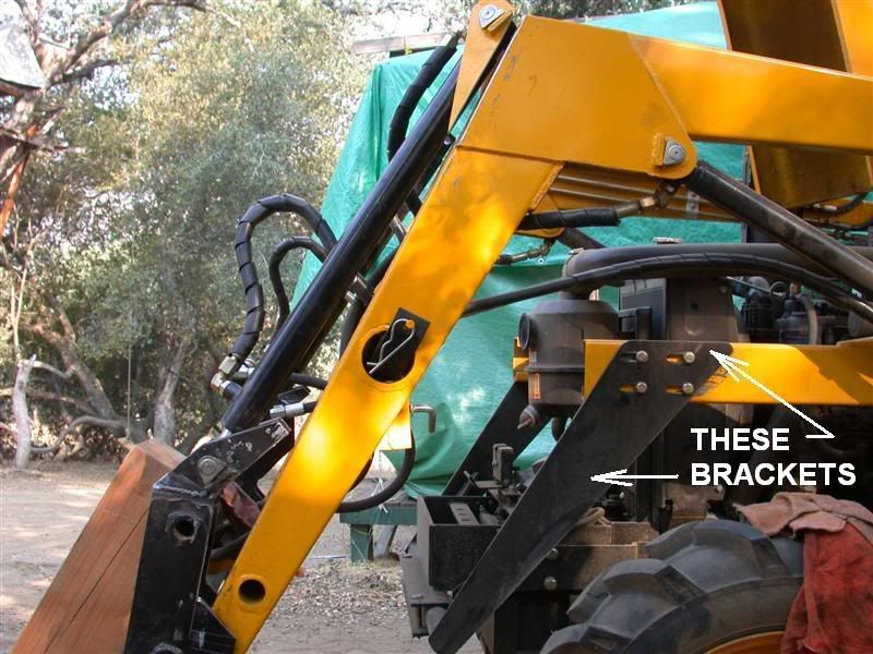

I see on Loretta's ZL-20 there is a stabilizing connection that goes to the front. There is a 1/2 tube receptacle running across the front and also connected to part of the fel mount.
They are black in this photo.
Well, where that black bracket attaches to the yellow horizontal bracket coming from the fel mount, those bolts you see are always coming loose no matter how tight I get them and regardless of Loktite. If you look closely on the yellow part, you can see that the black bracket has been sliding back and forth on those slots. I'm considering cinching the fit there so everything fits snug, and then running a bead across where the yellow and black brackets are bolted together. The fel should still be able to come off, right? But it would fit the front part real snug. I assume the bolts are there for initial fit to each tractor, so once it's fit it shouldn't move.
Anybody see a problem with that? Then I will make some brackets to tie in the loader mounts to the rear end as well.
The Koyker FEL front braces are very big and run from the main fel mount along the sides and attach to the lower part of the engine block. they are not up on top like on the ZL-20.
The Kama with Koyker loader has that piece that ties into the rear end. You can see it very good here painted red.
I welded part of my backhoe subframe mount to it.
