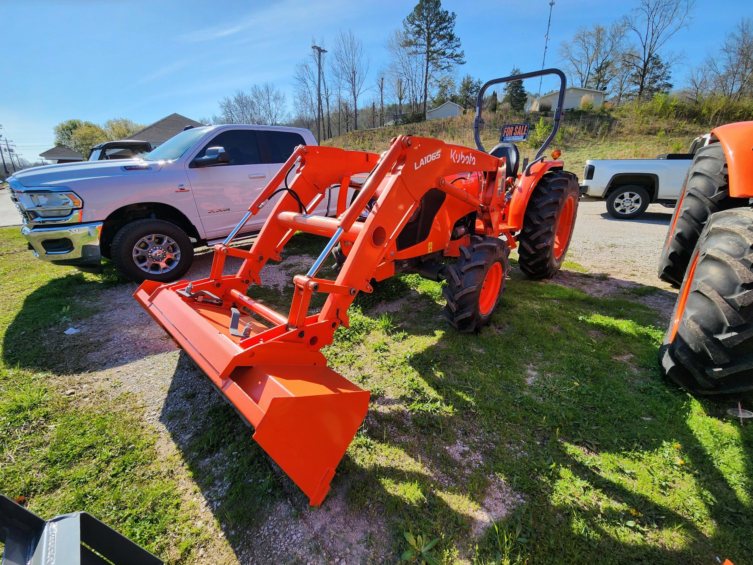

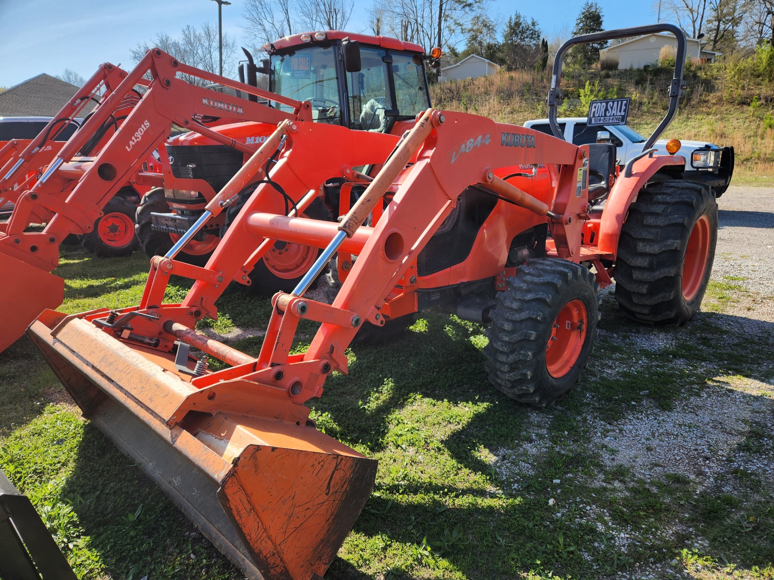

I have (2) Kubota MX5100 for sale. One is hydrostatic and the other one is manual transmission. Hydrostatic has 600 hrs and manual has 730 hrs. Located in Waynesboro Tennessee. I can possibly deliver. 904-813-4740 John

OP is in Australia. Shipping may be a bit steep.
