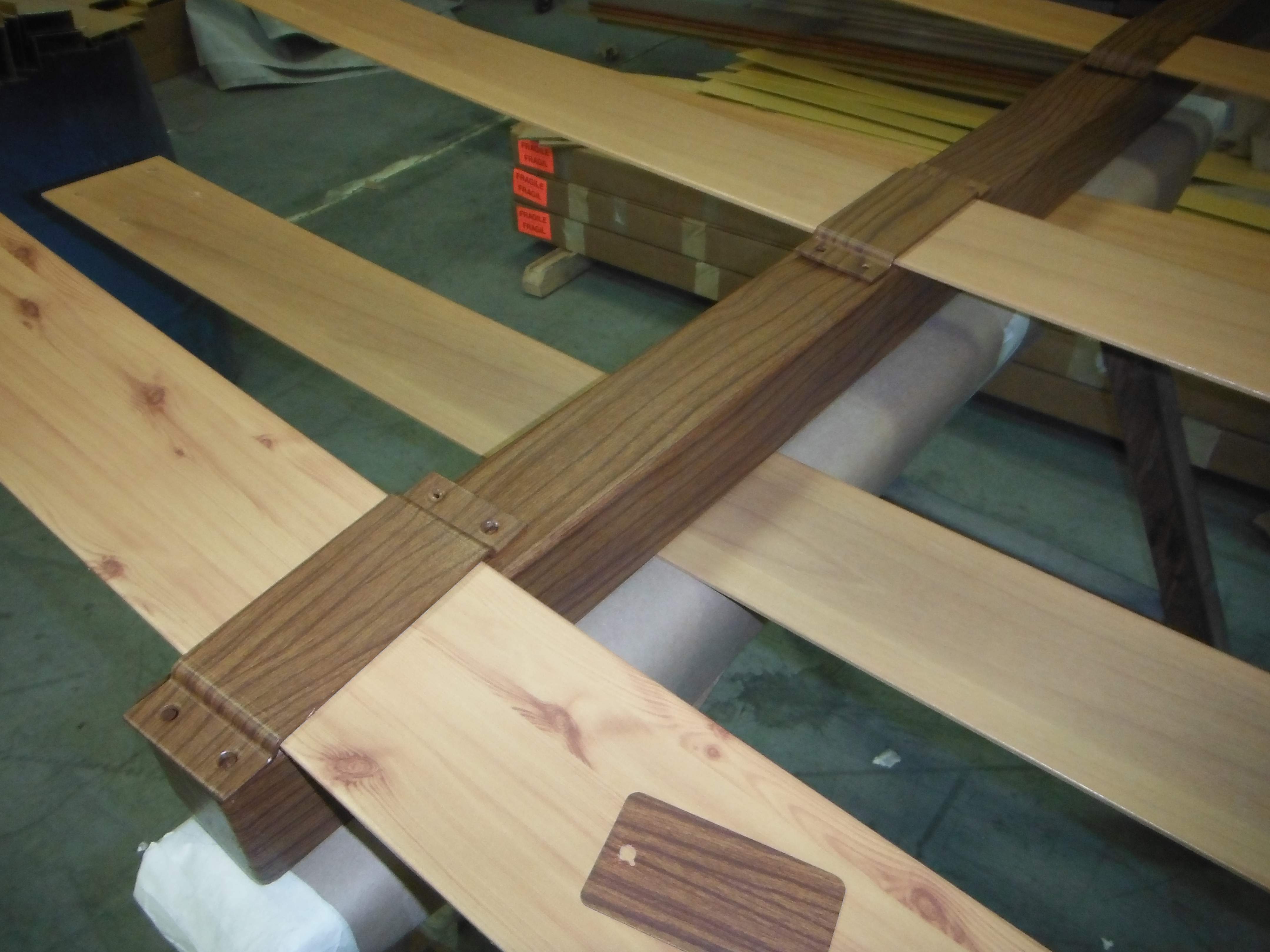

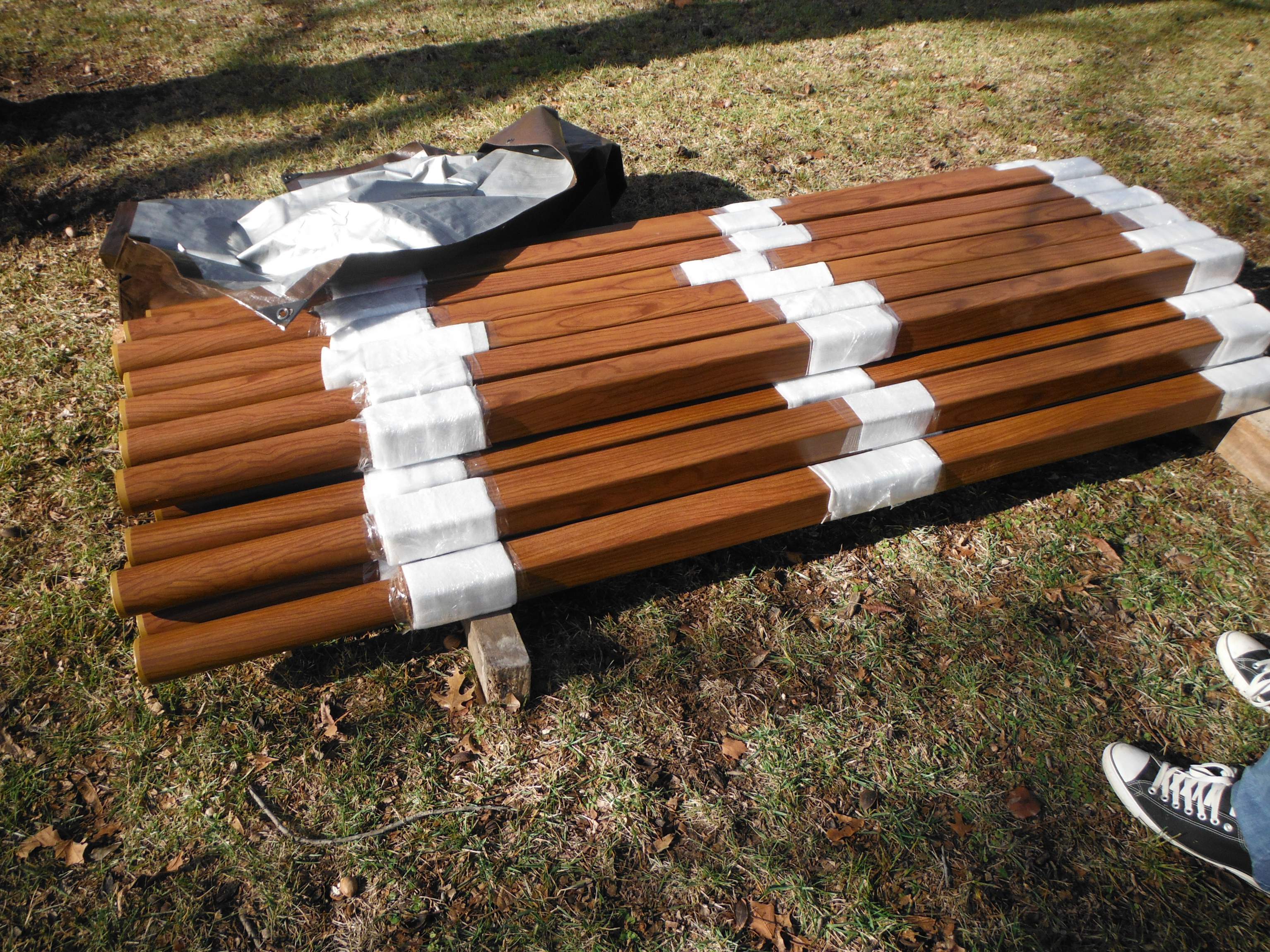

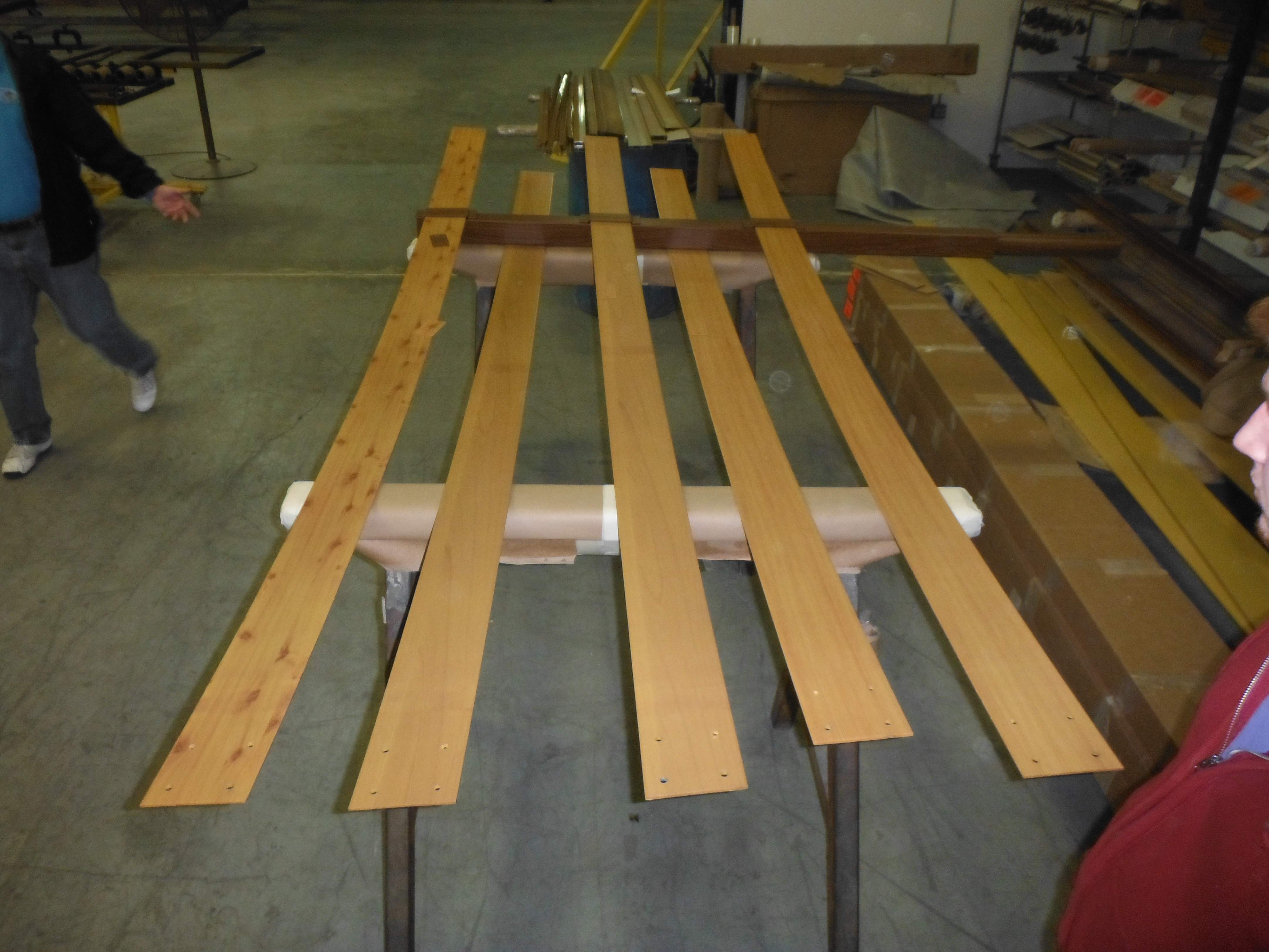

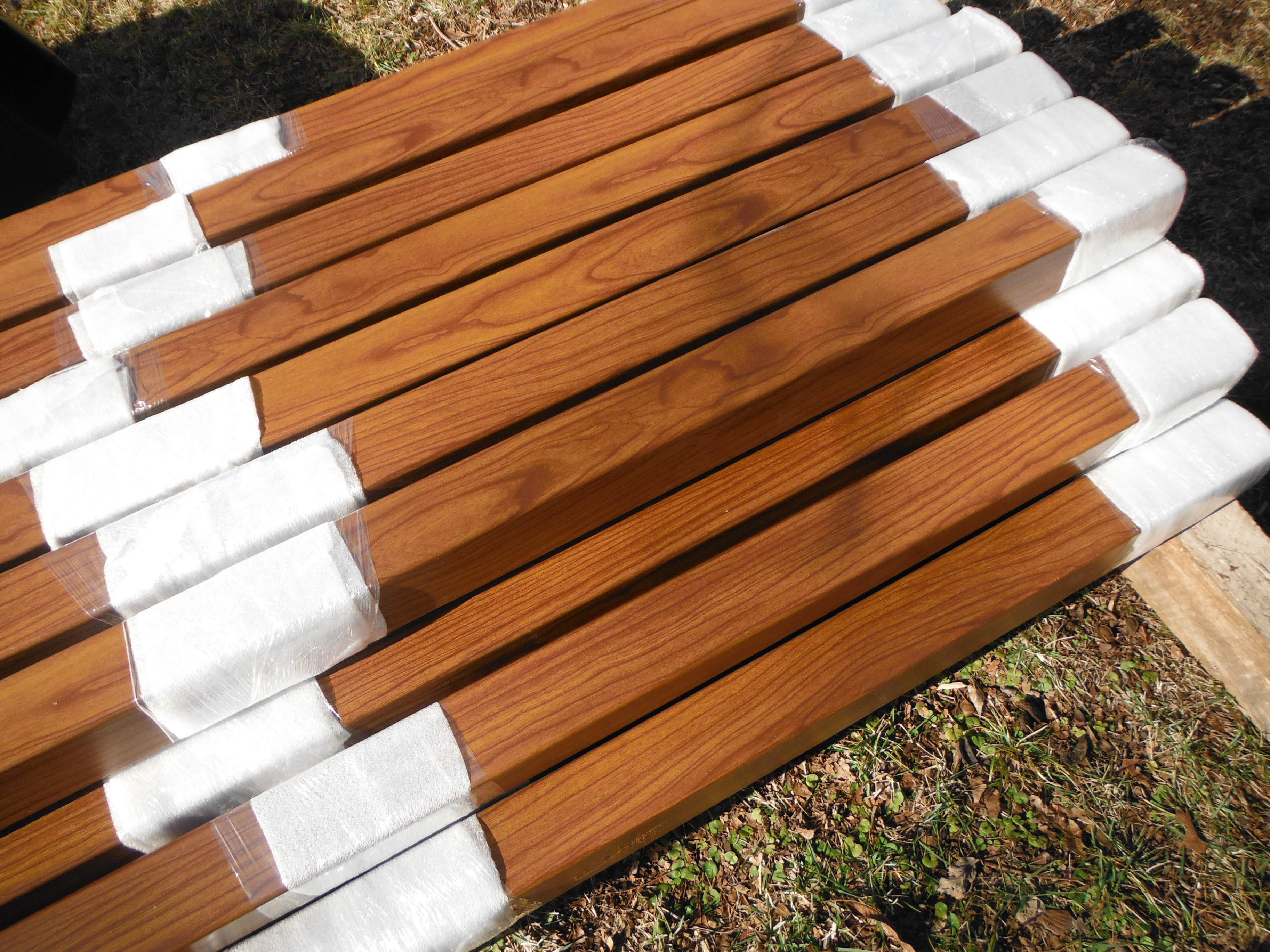

#685

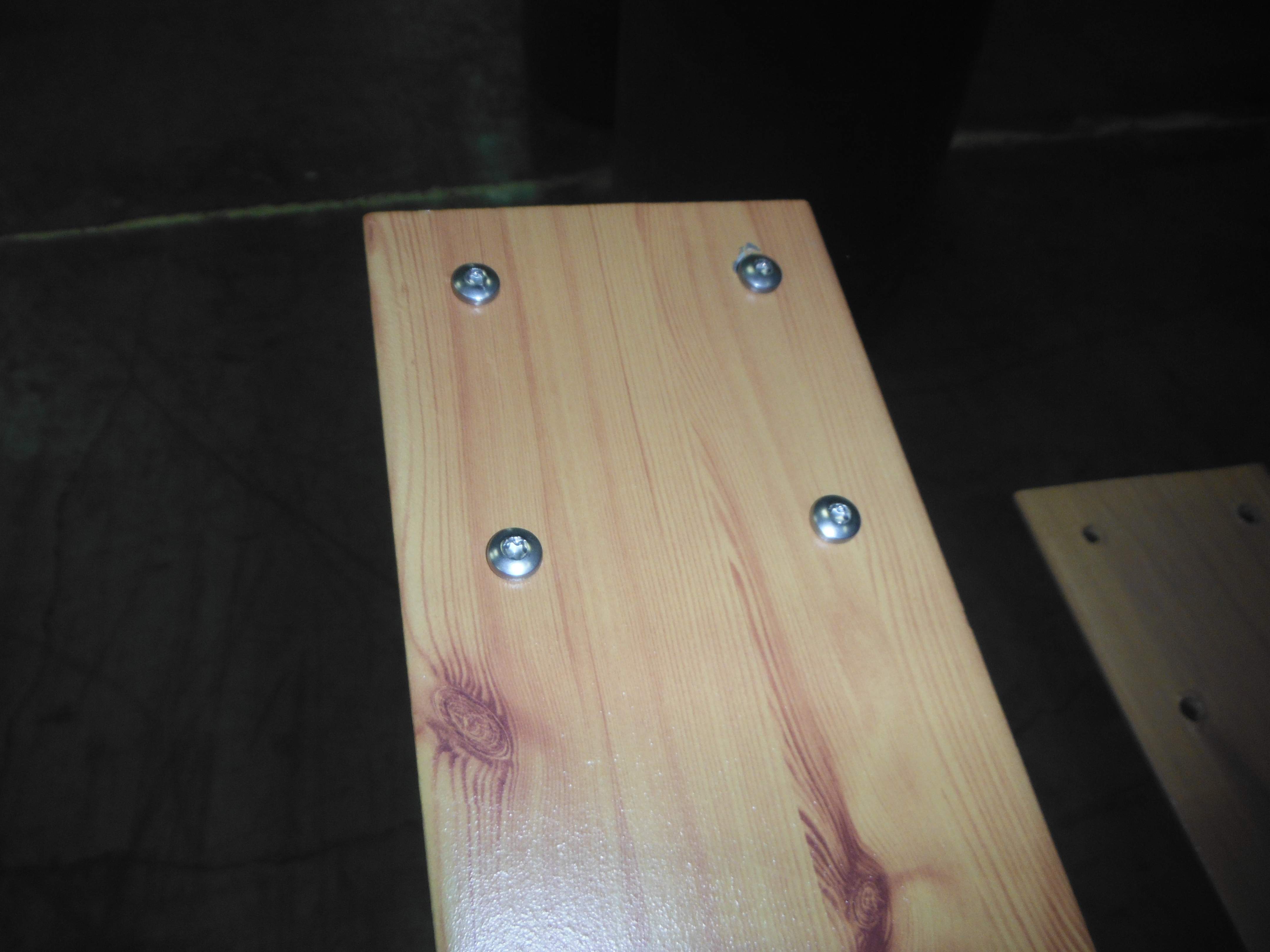

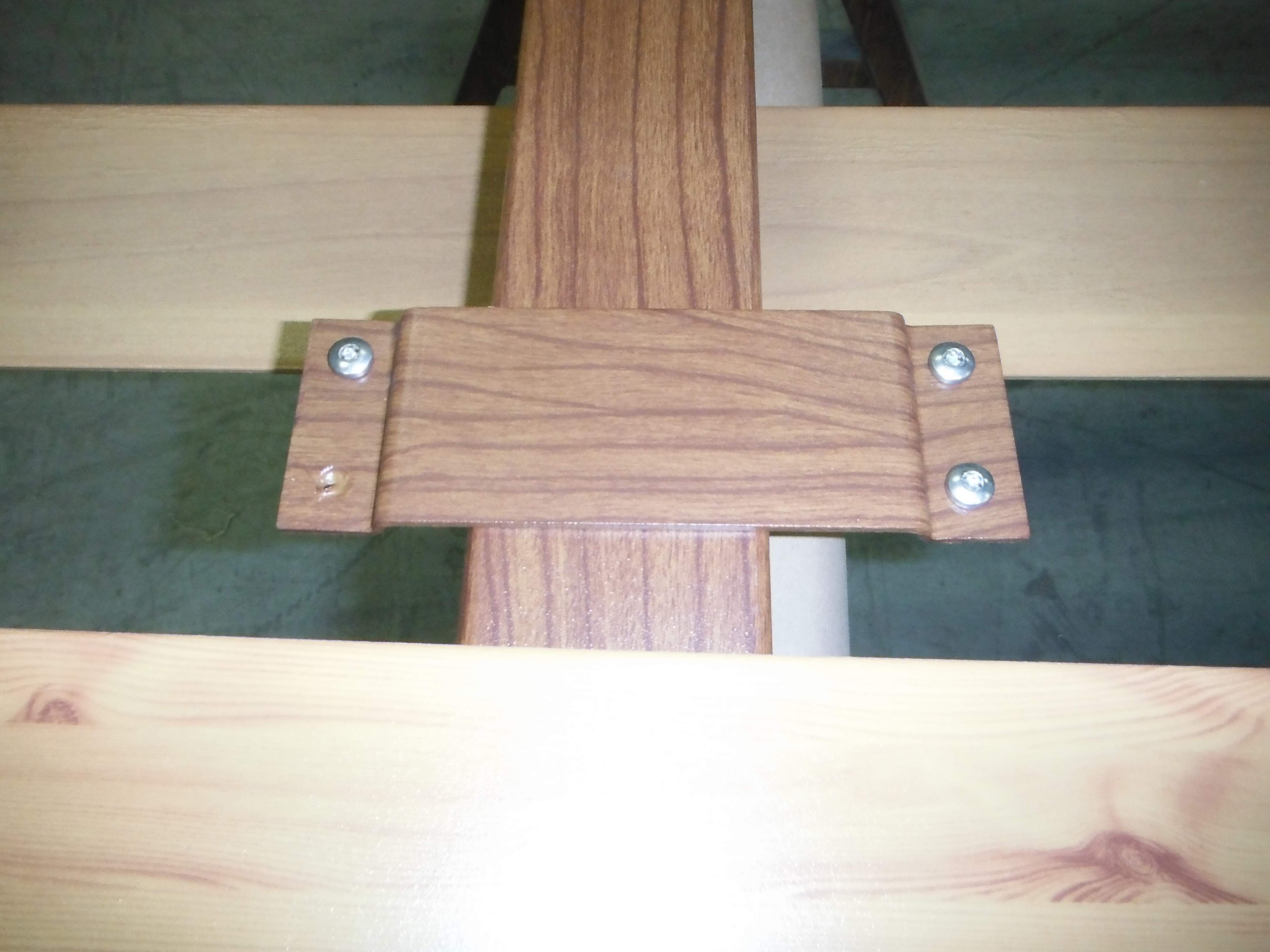

Today the clients and myself met at Quality Powder Coating to bless the color selections.
These are some photos I took of the event. Grade will be five to six inches below the bottom rail. 001 gives a good idea of what the weave pattern will look like.
Jim at Quality told the clients that in four to five years everyone will be stopping to question them about the stain they used that is holding up so well.

Harvey, the top plank of the basket-weave looks like it is a knotty pine pattern and the others are just grained patterns. Are you going to mix-n-match or use a single style for the whole gate? In my opinion, the knotty pine shows up much better and you won't miss that the gate looks like wood. The other planks (at least in the photos) look like wood only when you look longer than a fleeting glance.

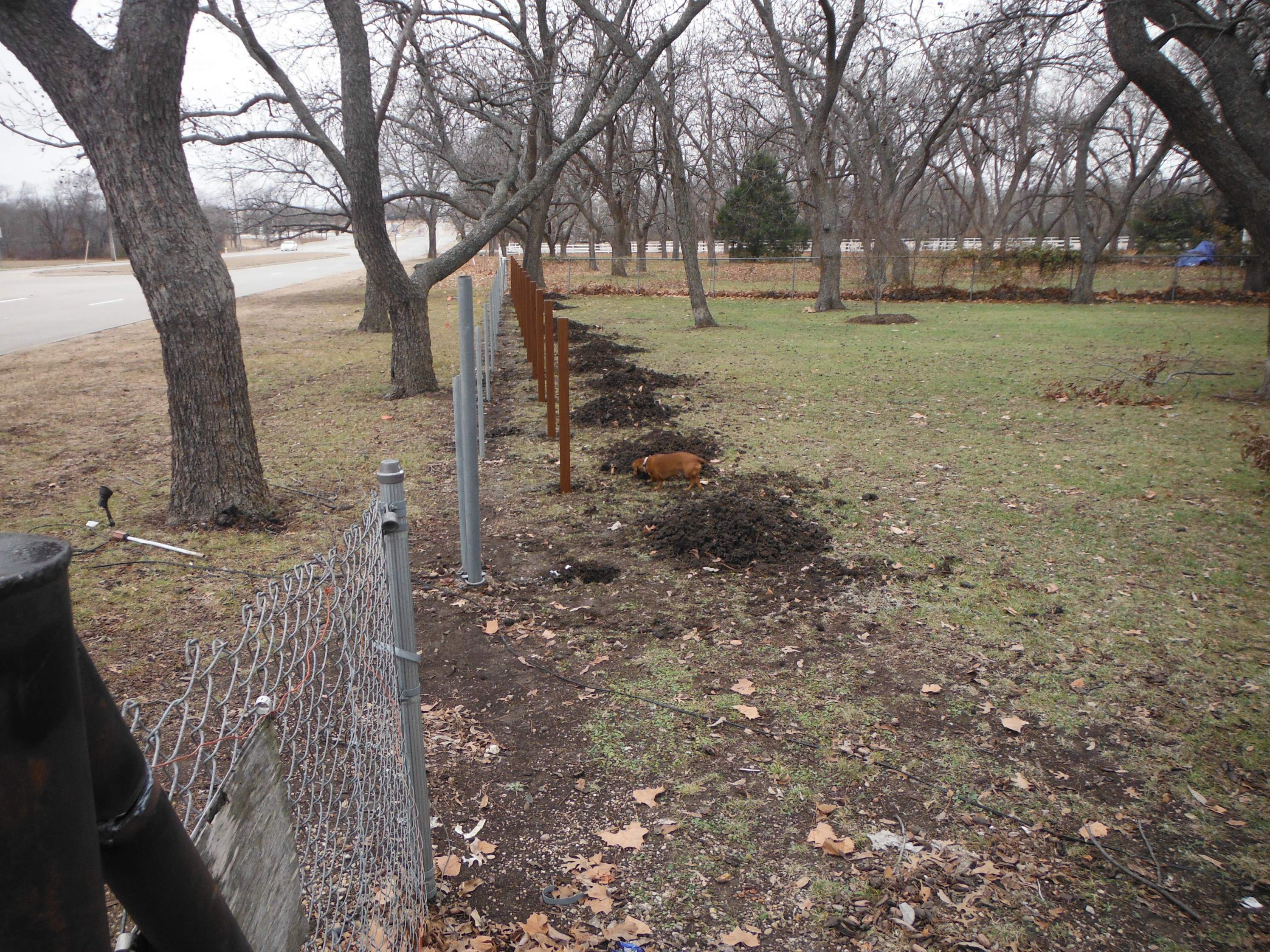

I picked up the first pallet of posts today and delivered them to the job. I have an agreement with the water district, no post hole drilling Fridays or weekends. That's because the line was installed in the fifties by farmers and no one knows where it is. And, they think I can find any buried utility better than anyone else can. So we will start setting posts Monday, weather permitting, weather is even more cranky than the water company when it comes to me setting posts.

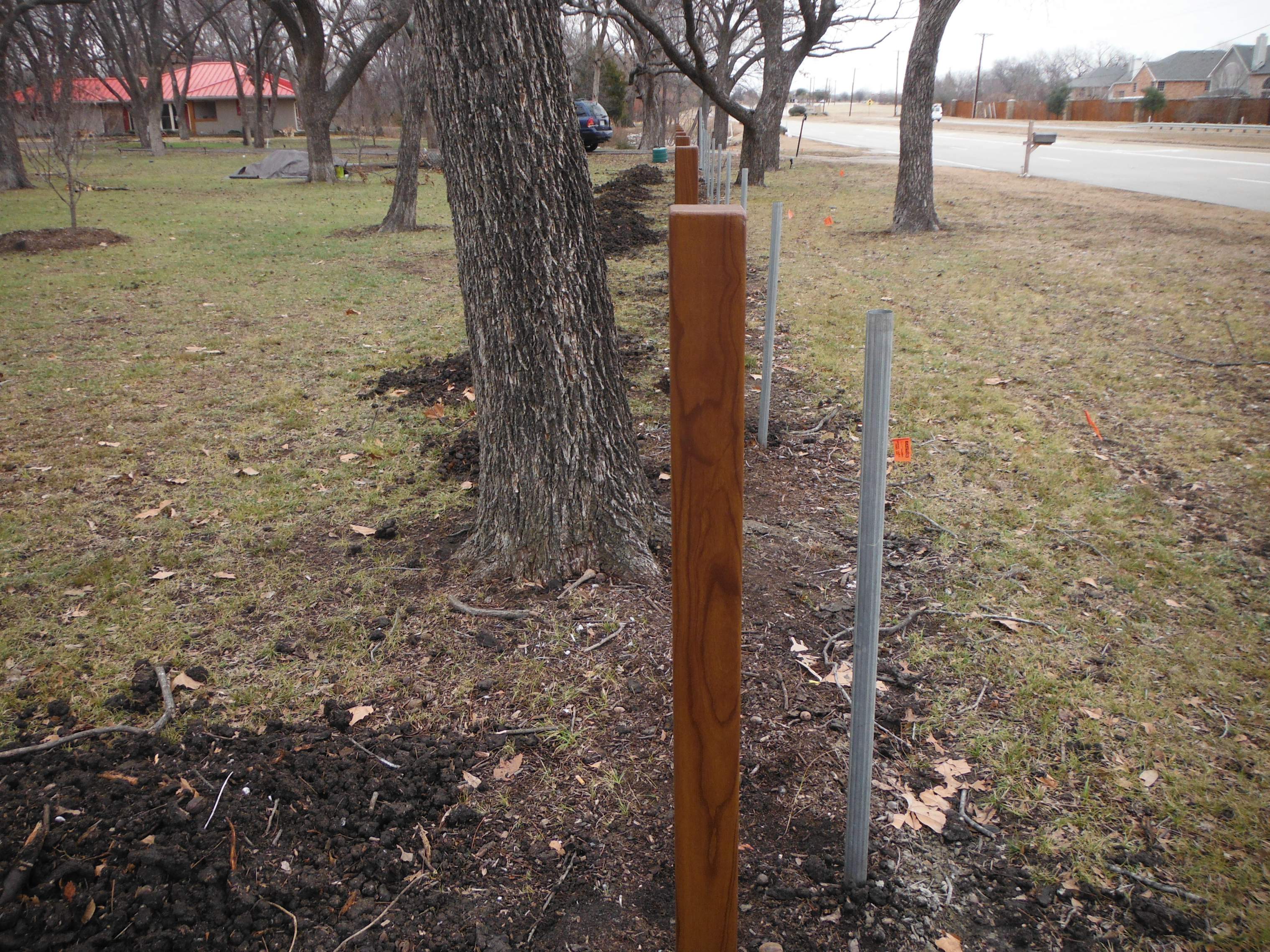

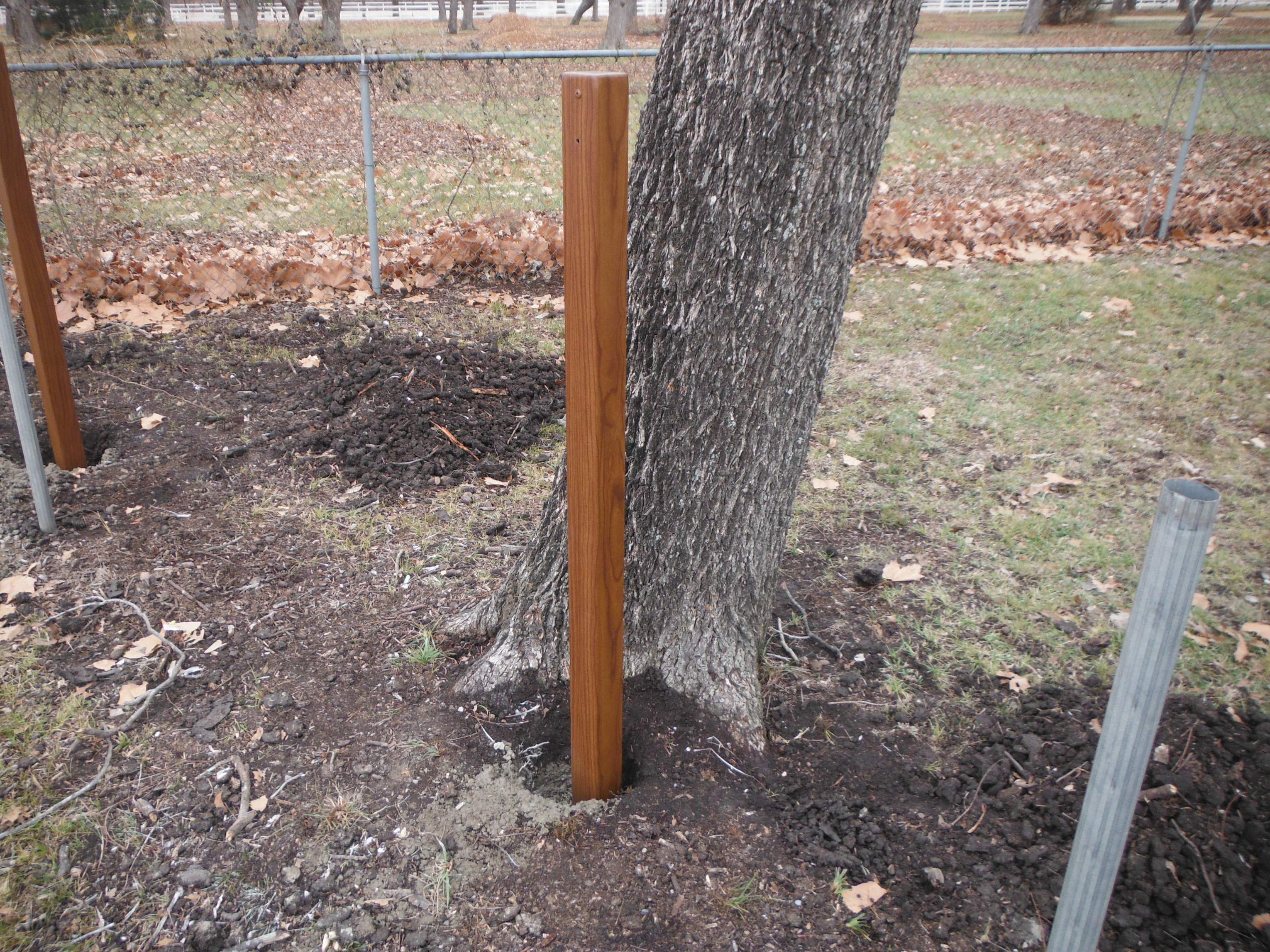

There's a lot going on in the picture of the post next to the tree. The most important thing was we had to get as close to the location as possible without damaging a significant root. The last thing we want to do is damage a large root and hurt part of the limb system.
Then there is the thing about post spacing. This is a basket weave fence. That means the spacing must be consistent to maintain the visuals we are looking to have. The basket weave pattern would accentuate any spacing differences. There is also the issue of rail positioning. We had to have the bottom rail on the outside of the post at this location. Again, basket weave pattern meant that the whole line's pattern is based upon the needs of this post.
We got lucky. I used the eight inch auger and it went down without a hitch. This also gave us the 7' spacing that I wanted. If I had went to a six foot spacing then I would be short of posts for the job. 8' spacing on the other hand won't highlight the pattern as much as a 7' would. If I was the praying sort I would have considered this one prayer answered.
So we set 13 posts yesterday afternoon. We are using a twelve inch auger and going down just over three feet. Even with us keeping the concrete down four inches in the hole we are using two large bags of Maximizer per post hole. I'm using the 24 year old Little Beaver hydraulic post hole digger that Texas Don liked so much when we did his gate project. I love this particular machine. It will work you like a dawg but there is so much more control and feel when digging in sensitive areas. It is heavy and when I pull it out of a three feet deep hole with a twelve inch auger attached I feel every minute of my 64 years.
We got snowed out today but hopefully tomorrow we will set the two arcs that are going to highlight the entryway. I will set up the Hilti rotary laser level and shoot grade on both sides of the drive level. These sections will be solid basket and accent the entry along with directing the eye to the gate.
The color and textures of the posts are way more than I hoped for. One of the neighbors commented that he would be terrified if he was in my shoes of hurting the posts during installation. I'm not worried, we're careful, have to be.
