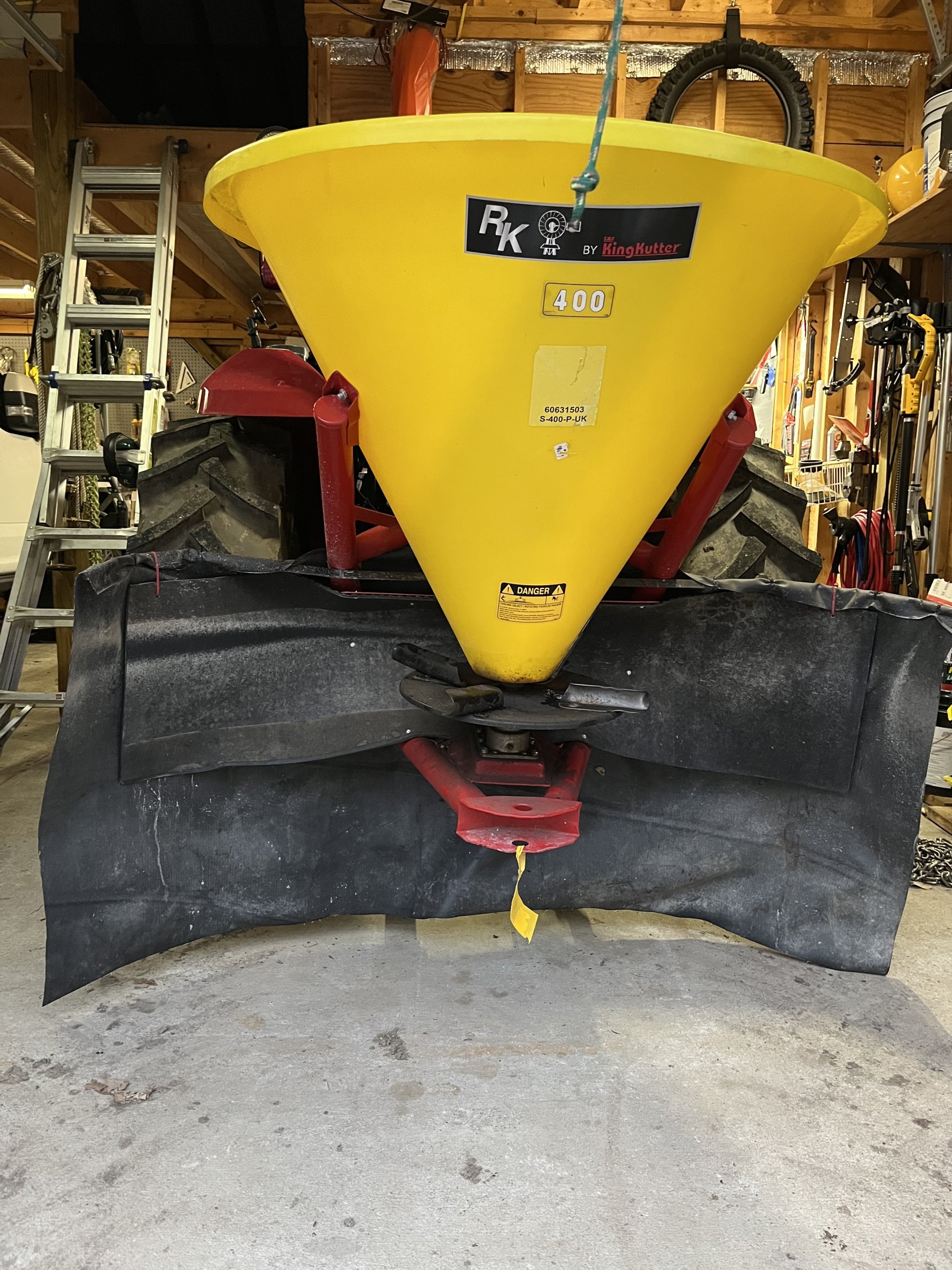

Hello Kieth,
It is no wonder why your getting all that splatter as there is no shield at the front to stop it.
Your doing the right thing by putting that curtain across the rear of the tractor.

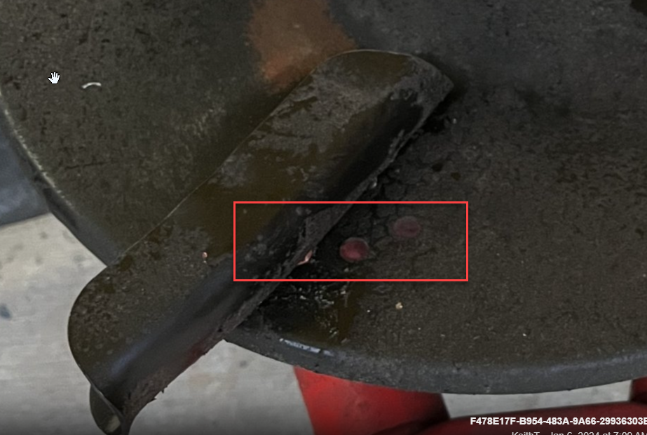

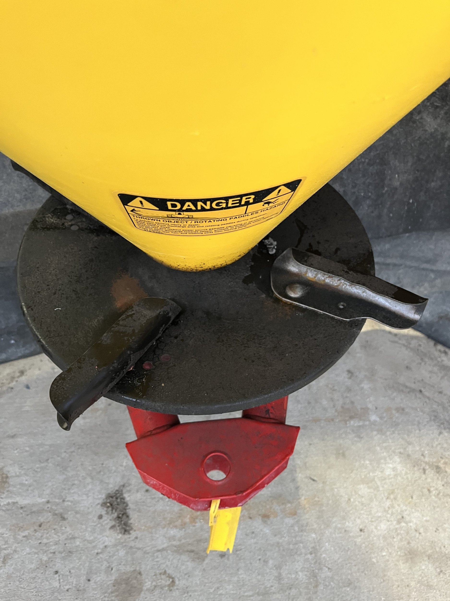

While I think a very low PTO speed is the answer, I believe the angle of the vanes (fins) on the metal cone spreaders can be angled back to reduce spreading width. Mine had adjustment holes in the flat plate on the bottom for that purpose.
I was thinking the same possible solution. Or perhaps spreading only to one side (left or right) and hug the opposite side of your travel path.
Looks like you are right.

I don't know anything about spreaders but what if you slit the end of the vanes where the vertical meets the upward and lower curves and bent the flap inward to deflect the throw. Or as an alternative you could fabricate an angled piece of metal to mount at the ends to act as a deflector. The latter is probably a better solution. Perhaps you could take some tubing, slit it open cut the excess out, bend the sides as needed and reshape the ends.
