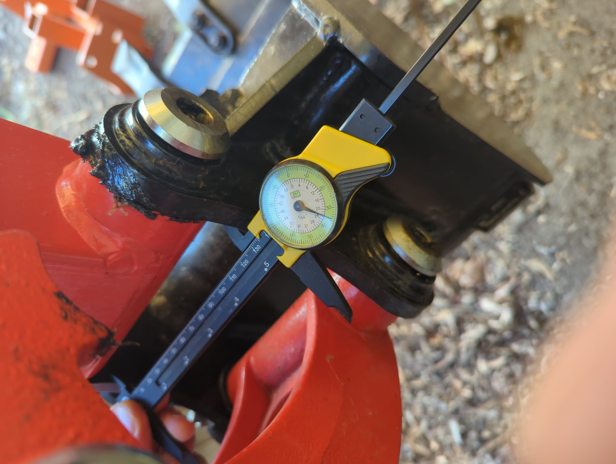

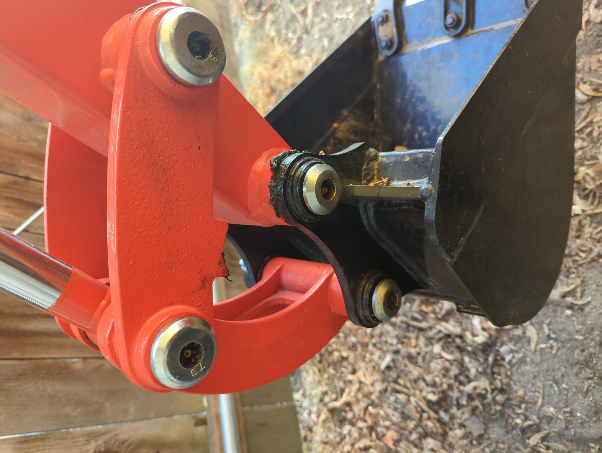

I have a Kioti backhoe on an LK3054 that is 12 inches wide. Would like to get a 6 or 8 inch to put some water lines in, do I need to go to Kioti, or is it a standard bucket? I have a place I can buy used buckets, but they are a New Holland/Kubota dealer. Any idea if they will interchange?
   / Kioti Backhoe Bucket #2
Many NH backhoes are made by Rhino.
The Rhino and Kioti buckets are interchangable as far as I know.
Just to be sure measure the bucket pin diameter and distance between the pins.

The New Holland Bucket should be the same. They were both made by SMC.
As others have stated, measure to be sure.
KO
   / Kioti Backhoe Bucket #10
Anyone ever confirm if the ear measurements on New Holland, Kioti, and LS all match up? Are they interchangeable?
