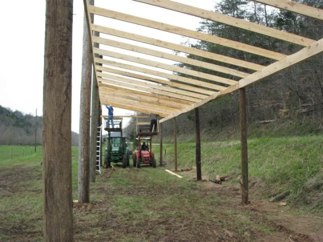

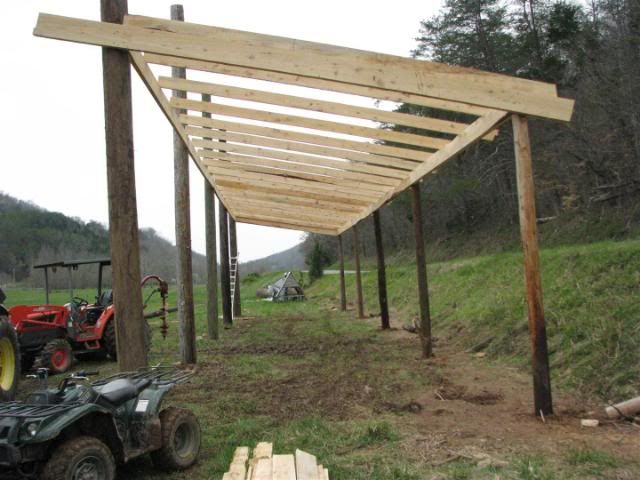

Well we started out square, but the poles(varied diameter) threw us off a few inches. This means that I will have to pop a line on the tin and cut it off so the overhang looks right...no biggie.
I'm back to working alone and got all the rafters cut off today. I also got a forth of the purlins up before the rain came. It sure goes slow when you don't have a "driver" ;)

Curious as to why you didn't notch(birdseye) the rafters where they overhang your horizontal beams attached to your poles?
Also, are you going to cut off the extension of the poles as they point to the sky?

CM, I could have notched them, but I figured if I was going to strap each one it would be overkill...no?
I will cut those big poles off later, but remember the center barn roof beams will sit on them so they have to extend above the shed roof-I'm guessing by 3' or so. The pitch ended up being a 2/12 & I have not decided if the center roof should follow that or be higher. A 2/12 is a lot easier to work on though....

I would say to think of any fastener as an added safety precaution. Structural support via gravity is much more important and the basic principle of sound structure. One has to consider movement prevention too- thus things like hurricane strapping to reduce wind effects etc. When one support a piece of lumber by laying it on top of another- as you would have seen in timber frame construction, notching is a big factor in providing necessary structural support. Fasteners themselves are not enough to overcome shear strength issues; for instance nails, bolts etc. So whatever you can do to reduce the effects of things like snow load wanting to shift the position of your rafters, or any other component of your pole barn the better. A beam is best if it has its load centered over it so that the downward force is only down and not able to move sideways or bow out away from the beam, as one example.
For the size of the pole barn you are building I would at least consider consulting with a structural engineer or at the very least a lumber yard's designer( cad/cam drawing tech) to possibly have some drawings done to help plan out what makes most sense from a structural aspect. I have had this done several times, and it can be very useful to help think things out on paper prior to doing them in the field on a trial and error basis. Especially on the scale you are talking about. It is not too costly to do this, and most larger lumberyards provide this type of service for an hourly rate.
And as to overkill- I would tend to overkill the heck out of that structure, especially with the weather weirdness we have been experiencing over the last few years. Its easier to overkill now and have the building stand for a long time than to try to retrofit later if problems come up. You could also contact any truss company and they can tell you what the snow load factor is in your area- as another factor to build into your structure.

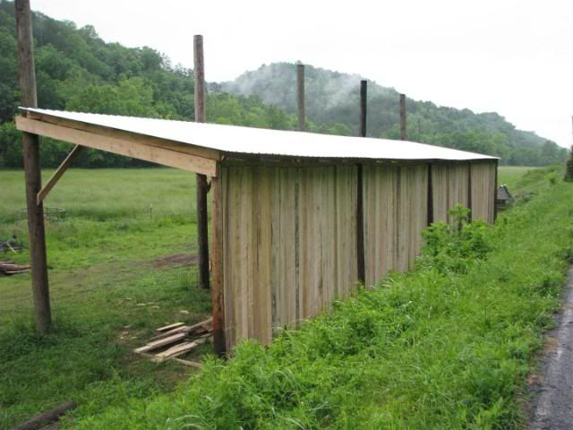

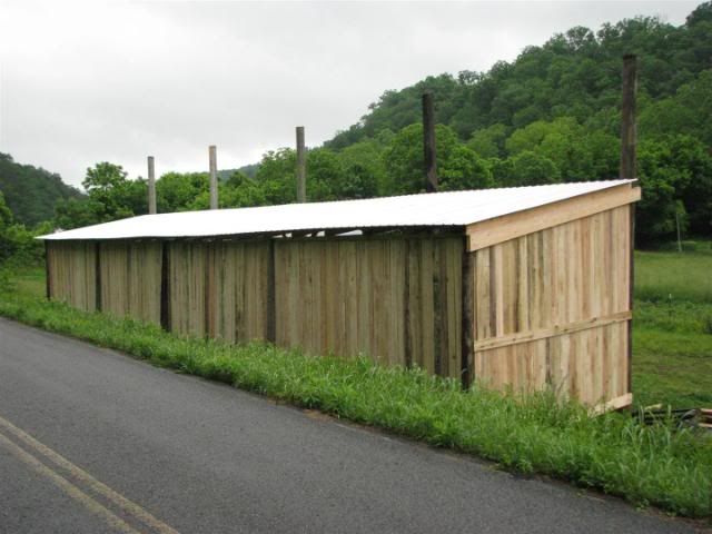

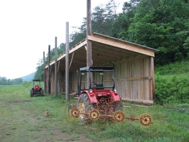

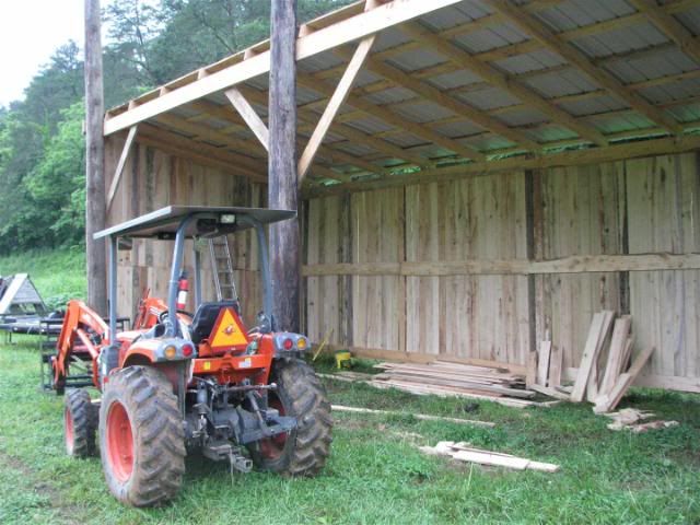

Well, it took a long time for things to dry out. I got the tin up a few weeks ago: 82'x17'-$980. I then put hurricane clips on every rafter(fun) & cut knee braces out of Hickory. I pondered what to side it with...A) trees from the farm, cut and skidded out of the woods, then milled by me, or B) buy a load of Poplar and mill them myself, or C) buy "culls" from a local sawmill.
When I found out I could get 1000bf of Poplar(mixed with some ash & oak) for $135 I chose "C":D. That's about 6x cheaper than I could have bought a load of logs and then dome all the work myself. The bundle of culls was in various lengths out to 16' and most 4 quarter thick(1.25") & 6" wide or better. There was enough 12'ers in the bundle to do the entire 80' side wihout having to piece it. On the endwall I just used all the left overs and mad a seam 6' high. There is even a few left over to start on the other endwall if I decide to enclose it.
I will scavange 4 more big poles one of these days and plant them for the main section of the barn. I won't get to build that section for proably a year or more.

Looking good. Are you going to apply any kind of finish to the wood? or just leave it natural?
