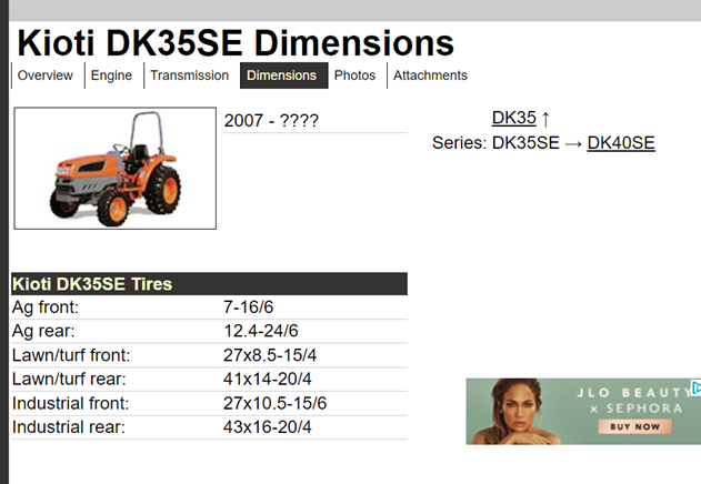

You can not replace a R4 with a R1 using the same rim. R1s are in general slimmer. That's why you possibly can't find a front tire in that size.
I once plaid around with the idea to buy a JD 4720 and put R1 tires on in the width of turf tires. I found tire sizes that would satisfy the front to rear ratio but not the same thread. Still R1. One of them was listed in the manufacturer's portfolio but not available on the NA market.
My tractor (and other Kioti models) are sold with the same rims, while they are fitted new with R1, R14 or AG1 tires.
That's true. Pretty much every tractor sold has tire options. But R1s require different rims than R4s. Turf tires, as far as I know, go on the same rim as R4s.
   / Kioti to Kubota Model Comparison #31
I just looked up tractordata. They don't list any Kiotis. For the Kubota MX 4800 they only list AG tires for 2wd and 4wd.
I pulled up the JD 4720 as a random example. They list all the options. Not one tire of a certain style will go on another tire's rim.
