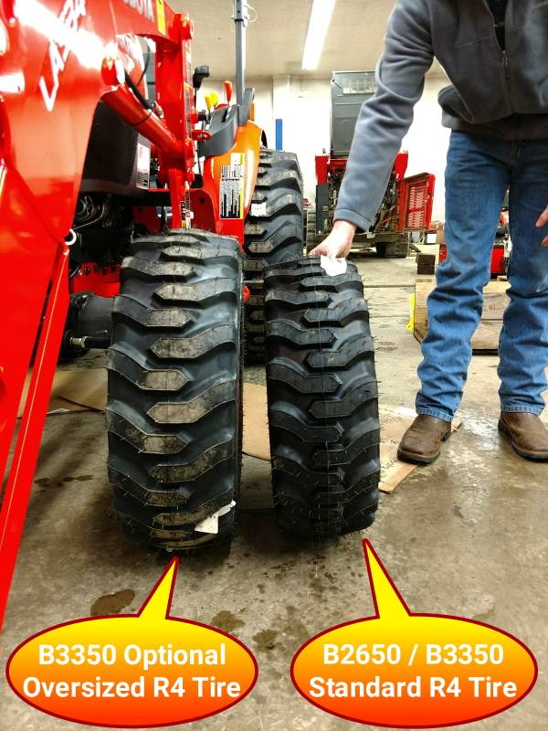

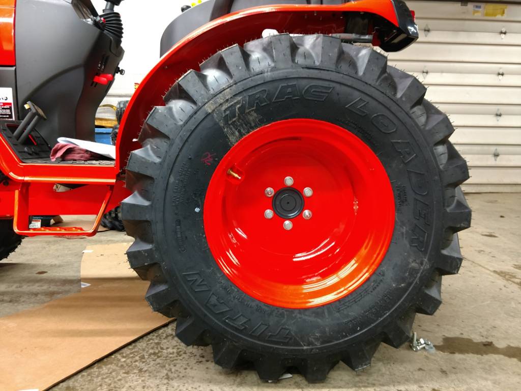

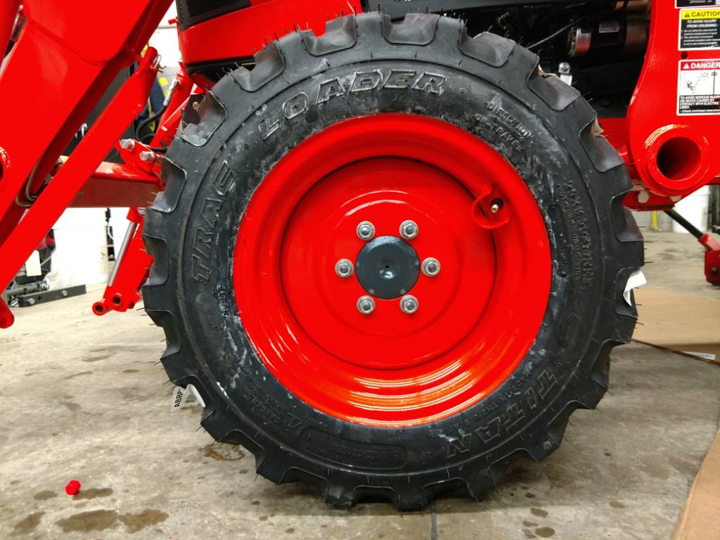

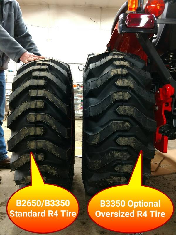

I run the wheel and tire package that is optional when buying the B3350SU.
According to a Kubota engineer response, it costs me 7.?? Percent of the designed gear reduction.
But, it adds a lot more fluid fill weight for my hills, it takes my width to 60.5" in the rear, it gives more aggressive tread design and it has much greater surface area... So it has at the least, equal or possibly less ground pressure per square inch to allow for less damage the grass.
Oh, and it looks cool as heck View attachment 550173View attachment 550174View attachment 550175View attachment 550176

Do you know if the oversized front tires interfere with the turning radius? Sometimes oversized tires require resetting of the steering stops to prevent interference between the tires and whatever at full lock.
Also, do the oversized rear tires preclude the use of tire chains?
If either is the case, I will go back to the standard sized tires on my B3350, which will not be delivered for awhile.
Thanks in advance.
SDT
The inside edge of the oversized tires from the B3350SU is at the same location as the standard wheel/tire, the wheel ring on the wider tires/wheels is shifted outwards from the hub mounting surface to place the inside edge back to where it is with the smaller wheel and tire. You'll need spacers for the chains on the B2650/B3350/B3350SU but I am going to assume that if you are looking at getting the bigger tire package, then like me you are looking at adding width for stability. If your doing that, you are most likely ordering the $399 Kubota 1.5" wheel spacers as well that will set your rear axle at 60" track width. In that case, the chains are not an issue. The question to ask is more like: Who has chains on a B3350SU with the optional larger tire package? That would get you the information your looking for as far as how tight things are in that configuration. I know that you need the spacers without a doubt. You can also price out 2" Brotek spacers, they may be cheaper than the 1.5" Kubota spacers, I never really looked. I had mine ordered as I wanted from Kubota to the dealer, so everything is "clean" from a warranty standpoint. My dealer initially was going to take an in-stock B2650 and merge it with tires for an in-stock B3350SU but decided to just make a clean/new order for my B2650 to ship in as I wanted so that he was not stuck sitting on a set of smaller wheels and tires that he did not want to be holding.
With the wheel/tire upgrade, you get a new/different front axle hard stop for the knuckles that keeps your larger front tires from hitting the frame. It still turns sharp, sharper than you would want in your grass because the wheels turn so far that they start to "plow" and "push" and tear up grass at full lock. I work in tight trails a good deal, and the turning radius is the least of my worries. Non issue.
