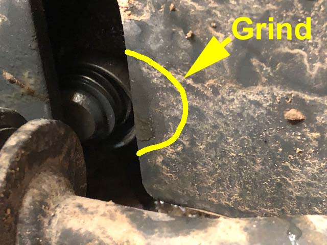

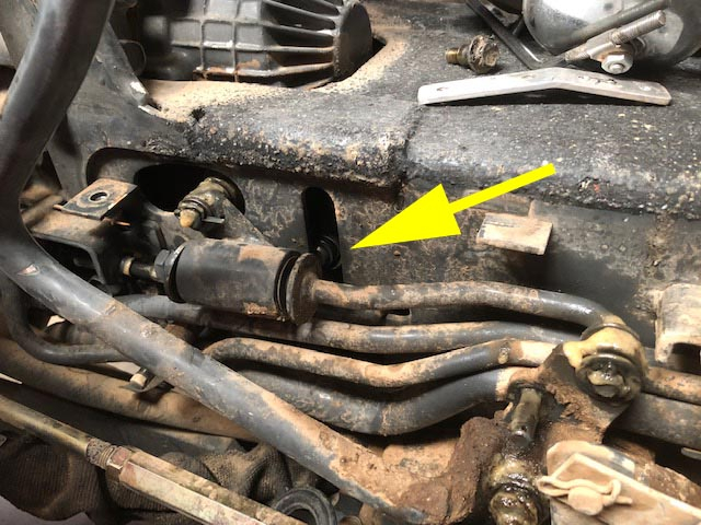

I had a similar problem with my B7800, an almost identical tractor. It would only start if I kicked the rocker pedal back and forth several times. There is a ball bearing that centers the rocker safety switch that disintegrated. Apparently this is somewhat common. You have to remove the floor pans to get to it and it looks like it can’t be changed. You have to grind a larger opening in the slot to remove it.
Pull a snap ring and it slides right off. You can see my bearing is missing balls.
